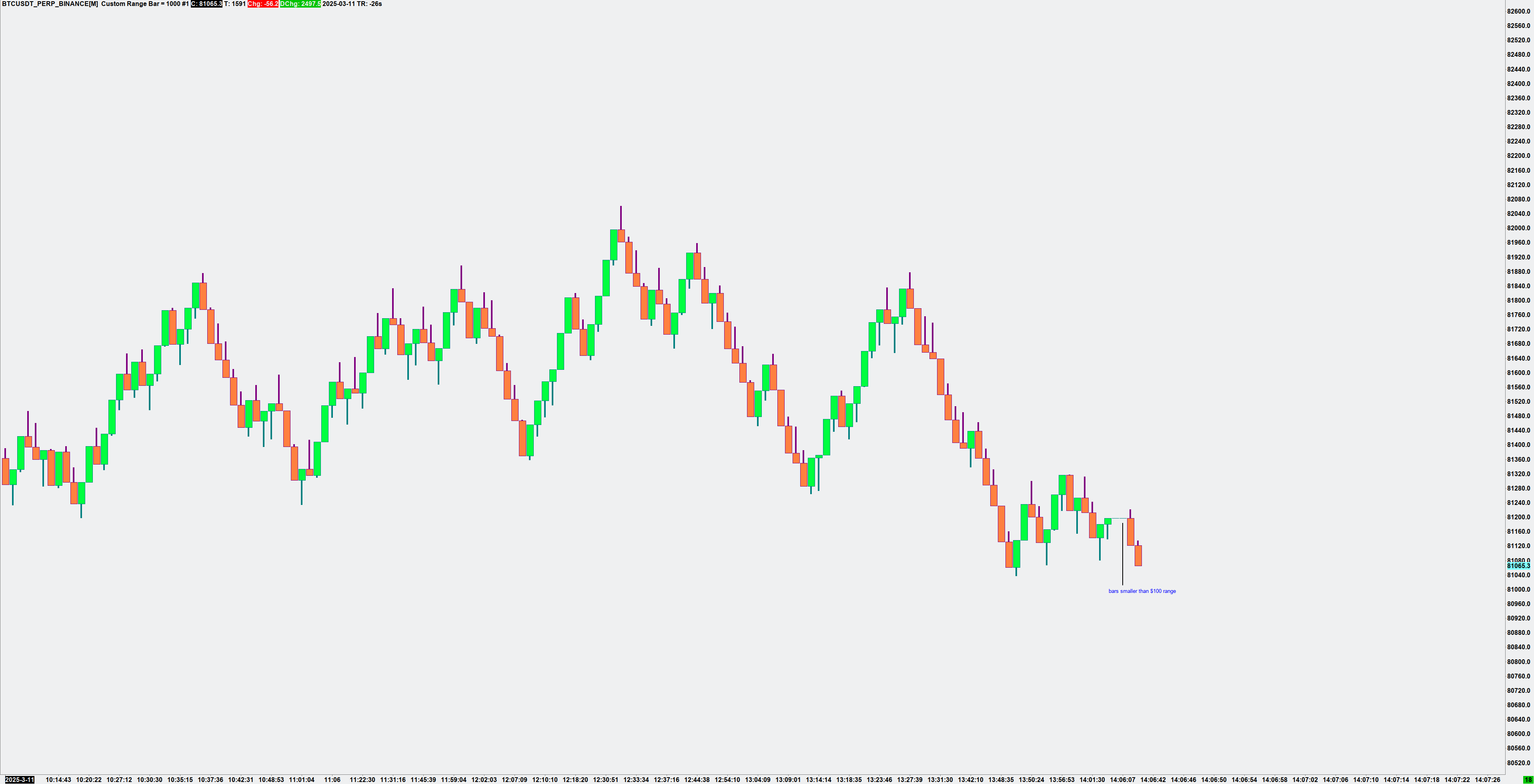

I've attached a screenshot showing the small bars issue: https://www.sierrachart.com/image.php?Image=1741698428121.png
The behavior suggests there might be a specific initialization condition that needs to be handled differently.

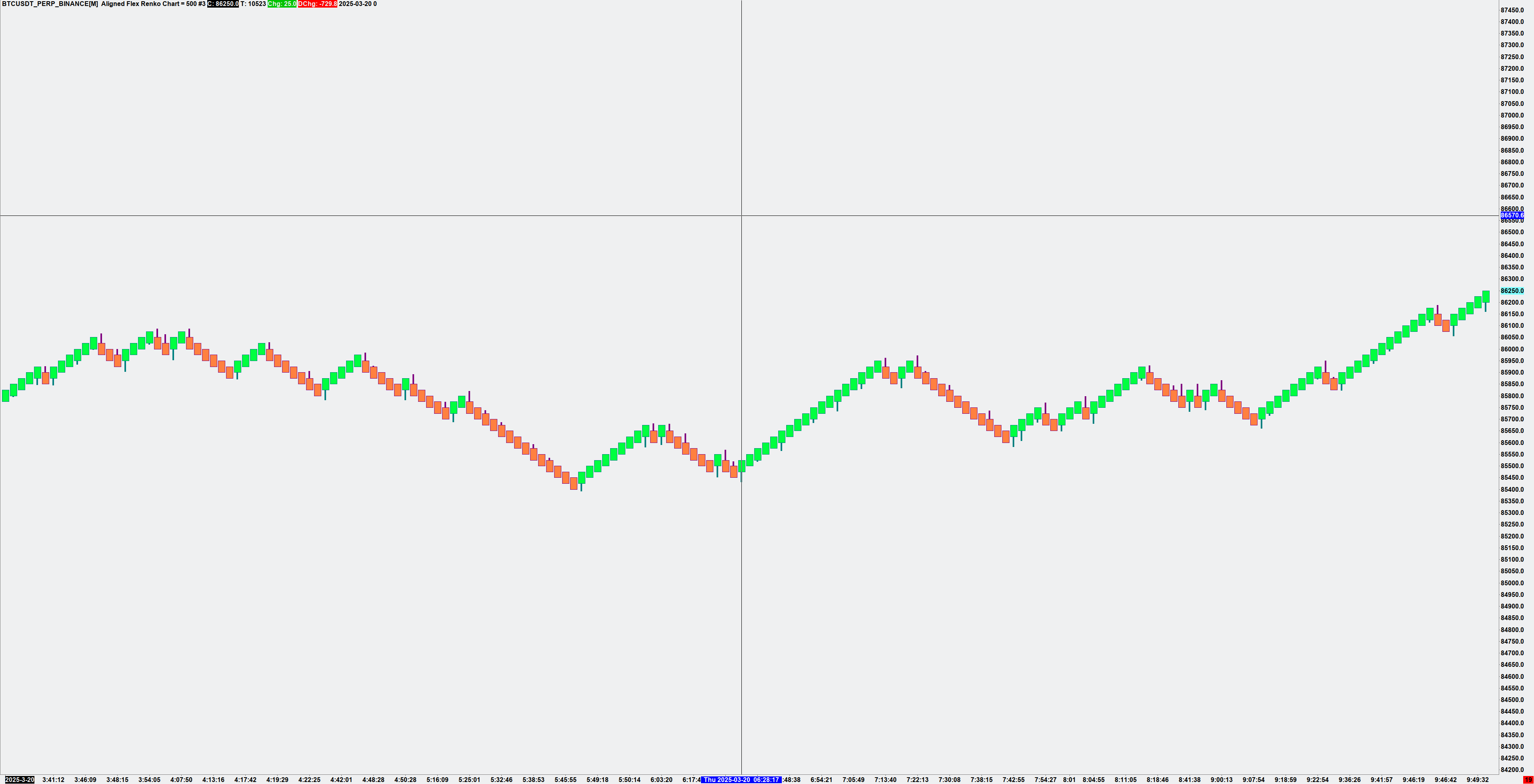

In the meantime I manage to make an aligned flex renko chart based on 1s data: https://www.sierrachart.com/image.php?Image=1742461969909.png

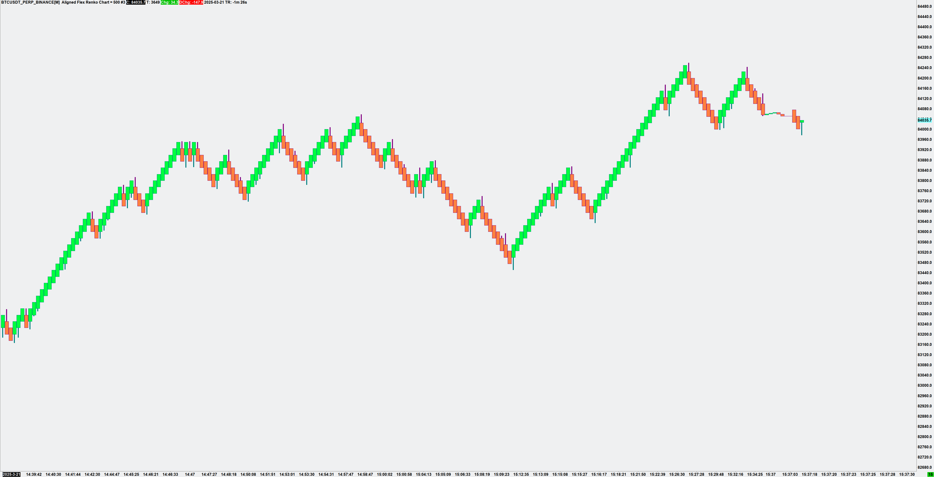

However, the most recent bars look squeezed like this: https://www.sierrachart.com/image.php?Image=1742462003713.png
Is this something related to the problem above or it's something else?

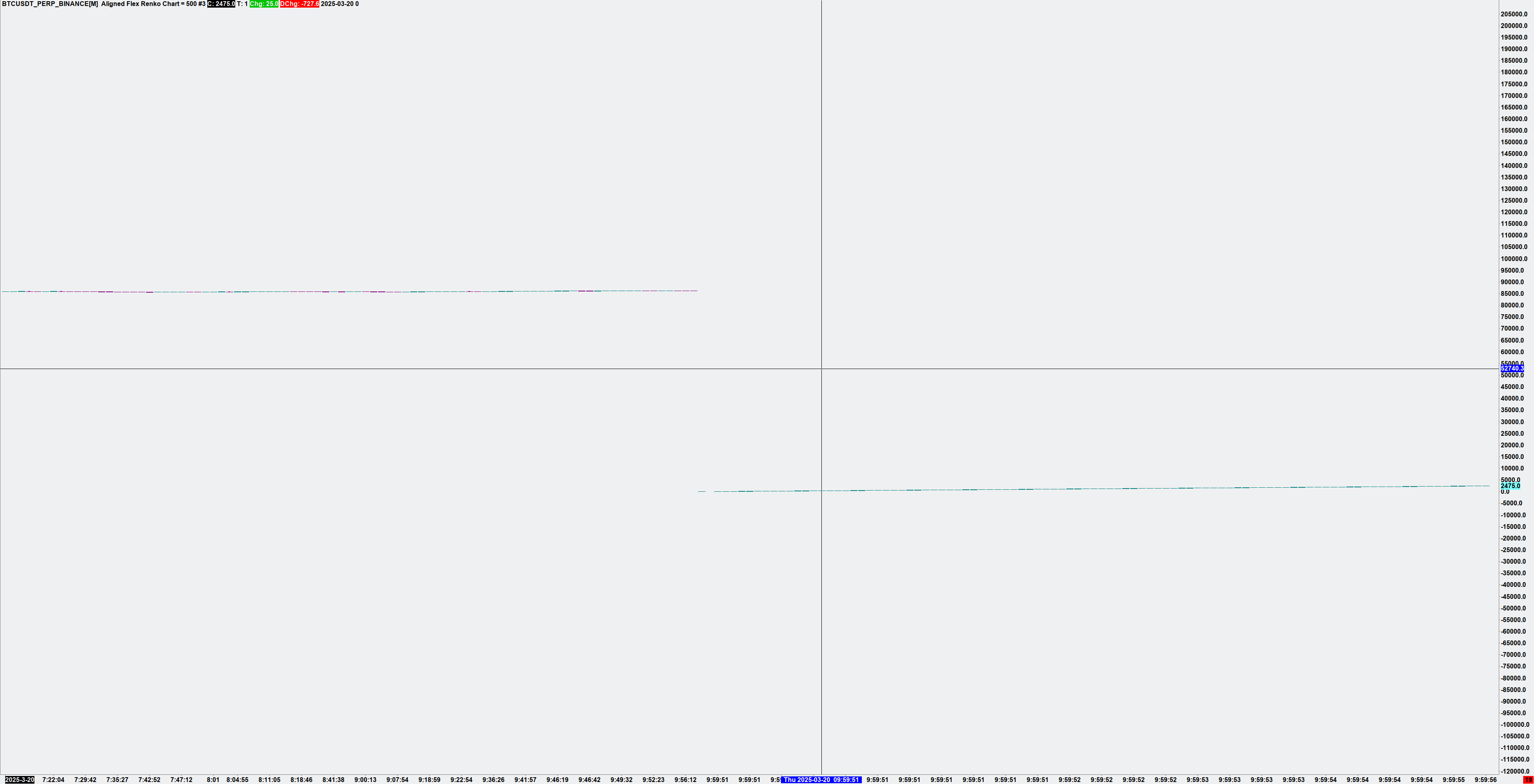

LATER EDIT: I tend to believe that the squeezed bars are actually many incomplete bars like these: https://www.sierrachart.com/image.php?Image=1742567925853.png
So it looks like it's the original problem.
