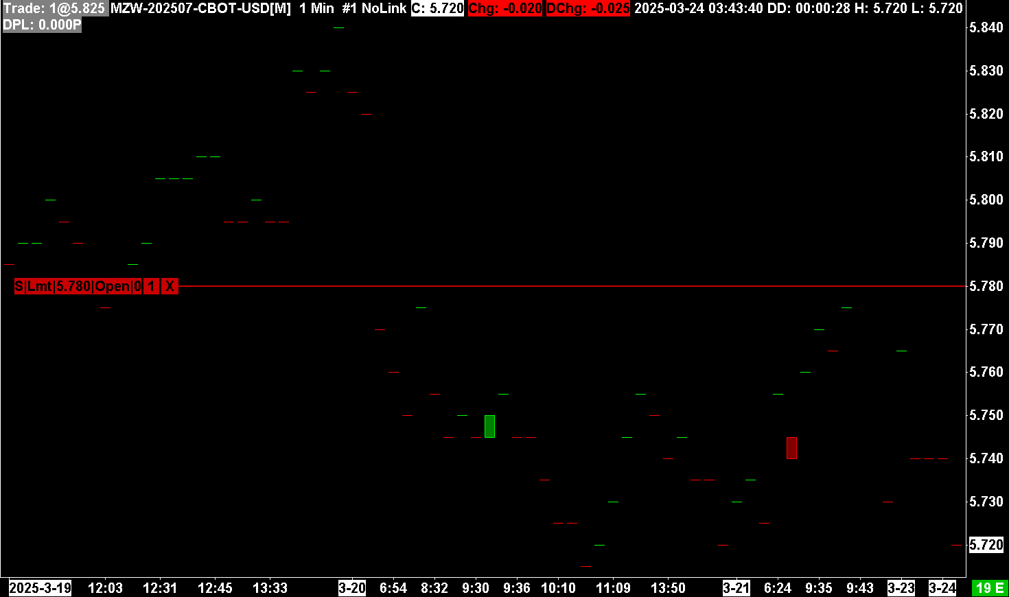

| Sierra_Chart Engineering - Posts: 25484 |
We tested this and we do not observe any problem with MZW using TWS. This is what we see for the chart and order: https://www.sierrachart.com/image.php?Image=174280385696.png The order looks just fine on the chart. We can modify it and cancel it. No problems at all. We are testing on the TWS demo. Show us a chart of what you are seeing. Instructions: Provide an image of the chart or Trade DOM, by following these *exact* instructions: Support Board Posting Information: Attaching or Posting a Screenshot/Image (Optional) Sierra Chart Support - Engineering Level Your definitive source for support. Other responses are from users. Try to keep your questions brief and to the point. Be aware of support policy: https://www.sierrachart.com/index.php?l=PostingInformation.php#GeneralInformation For the most reliable, advanced, and zero cost futures order routing, use the Teton service: Sierra Chart Teton Futures Order Routing Date Time Of Last Edit: 2025-03-24 08:12:58
