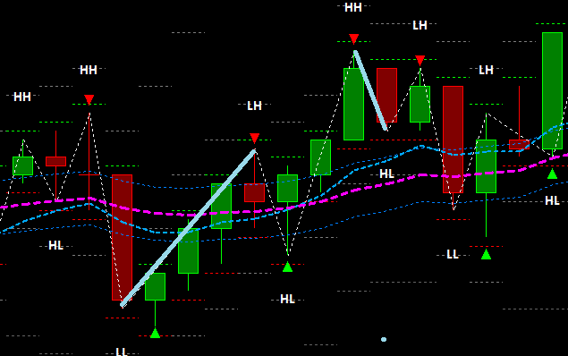

[2025-03-05 19:12:06]
User153286 - Posts: 73
See the attached file
The dotted white lines are created by the standard zigzag study using using mode 2.
I drew a blue line over two of these white lines to illustrate what I mean by skipping bars.
The first blue line spans 5 bars. The low of the bar 1 is connected to the high of the bar 5.
The second blue line does not skip bars, simply connecting the high of the first to low of the second bar
In my ASCIL study, setting the don't use 0.0 values, given a 5 bar example, is it "correct" to set subgraph[0].data[index-of-bar1] = low of bar 1, then use 0.0 values for the data values of bars 2, 3, 4 and finally set the data value of bar 5 to the high value of bar 5? Is that the "correct" recipe to use in SC writing a ACSIL study that draws similar types of lines with a subgraph structure?
imageScreenshot 2025-03-05 115635.png / V - Attached On 2025-03-05 18:57:47 UTC - Size: 13.87 KB - 233 views
[2025-03-05 19:35:06]
User431178 - Posts: 908
Check the tool values window, no bars are being skipped, the zig-zag line subgraph is populated at each bar.
If you are setting the subgraphs in your study to zero, you could use the Line Skip Zeros subgraph as the drawstyle I think.
or
You could fill the bar values in between with interpolated values, using the function sc.FillSubgraphElementsWithLinearValuesBetweenBeginEndValues.
ACSIL Interface Members - Functions: sc.FillSubgraphElementsWithLinearValuesBetweenBeginEndValues
[2025-03-05 20:14:38]
Ah that helps my brain even more! I always over think things. This is simple and it helps we with some other concepts to incorporate. If only trading was this easy. Thanks again...
