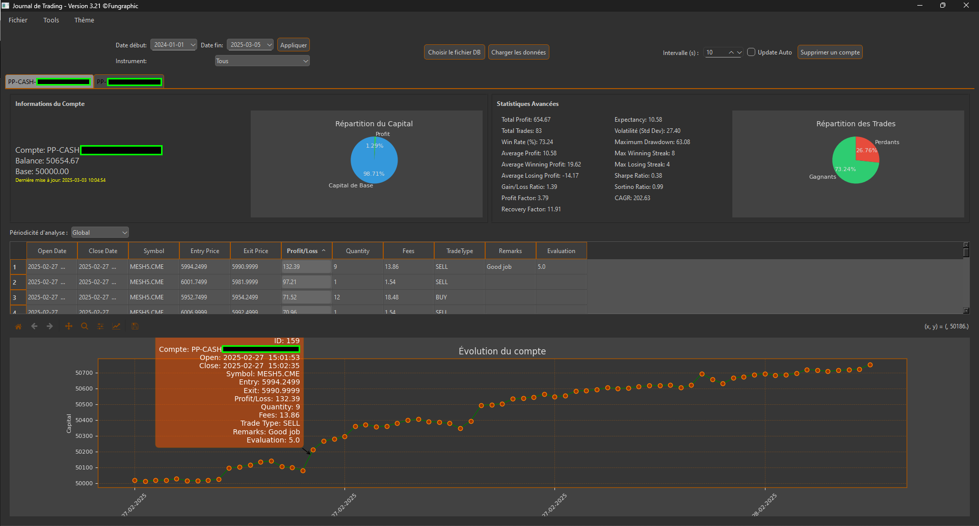

Hello, I searched in the documentation how to have the ProfitLoss of my closed trades but I did not find.
Does anyone know how to get this information?
I can get almost all the information except this one.
I tried to calculate it with the recovered data but it never reflects the reality of my trades and my trading history.
Here's a sample image of what I can recover with the DTC server.
If it is not possible to have this information, is it possible to have the method of calculation to have the good PNL.
Thank you in advance

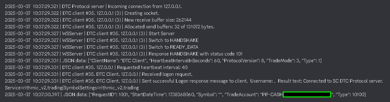

I tested, everything seems to work but I have no data in response.
I tested with the Empty symbol; then with MESH5 and MESH5.CME
I also tested with the username and password of my broker account and still no data.
Here is the structure of my python classes:

Here is a screen of the sierra messagelog.
Date Time Of Last Edit: 2025-03-07 17:05:34

I forgot to give you the format of the request sent to the server.
Here it is:
2025-03-07 23:04:55,477 - DTC_Client - INFO - Sending HistoricalTradesRequest for symbol MESH5.CME (RequestID: 1001): HistoricalTradesRequest(RequestID=1001, Symbol='MESH5.CME',
TradeAccount='PP-CASH...........', StartDateTime=1738368060)
Date Time Of Last Edit: 2025-03-08 10:02:04

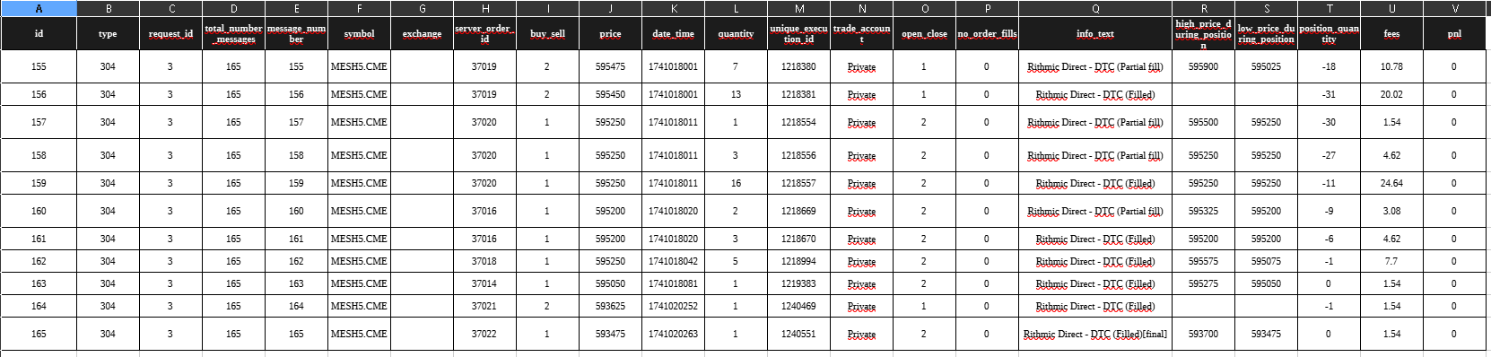

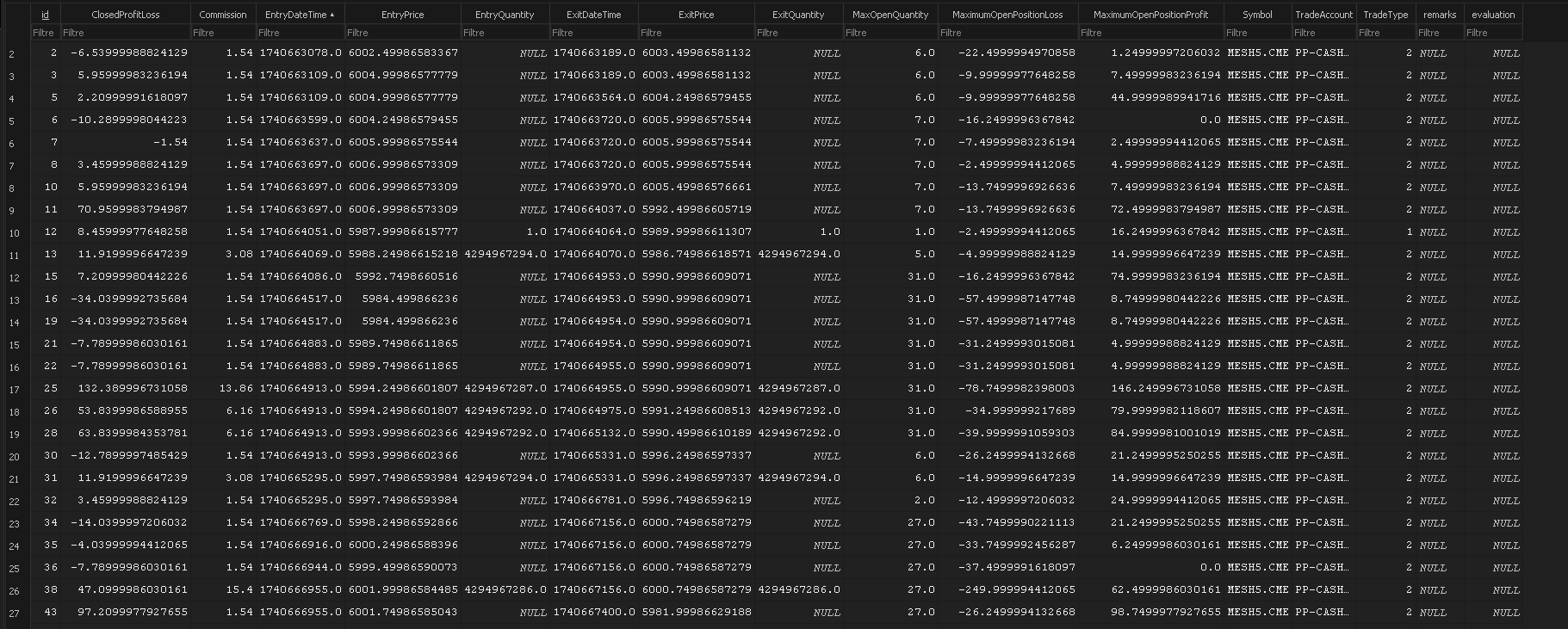

Hello, thank you very much because it works.
But there's still one thing I can't understand.
With this data I still can't calculate the exact PNL that is displayed in my Rithmic dashboard.
There is this kind of data in EntryQuantity/ExitQuantity "4294967294".
Does this represent the partial close of a trade?
Does this make it possible to aggregate partially closed trades?
I have entered the fees in sierra charts for the MESH5.CME (1.54)
I have tried several calculations but I cannot find the exact amount of the PNL.
Can you tell me which method to use?
Thanks in advance

User431178 - Posts: 910
Maybe somewhere there is a type conversion error?
4294967294 unsigned int => -2 signed int

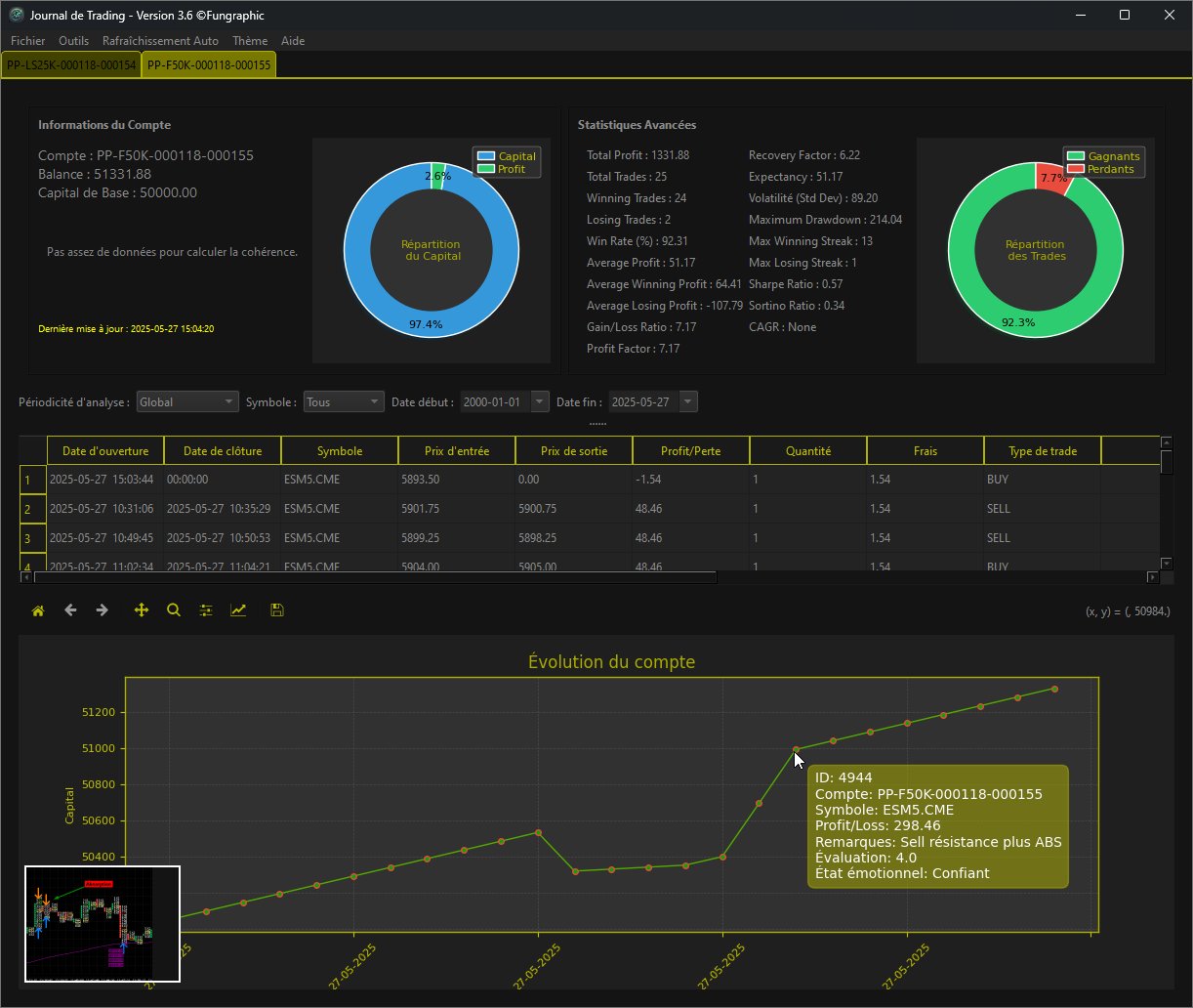

Fungraphic72 - Posts: 21
The new version 3.6 of the journal has just been released.
https://x.com/JTforSC/status/1927372653360197633
imageVersion 3.6 ©Fungraphic.png / V - Attached On 2025-05-28 09:19:21 UTC - Size: 129.42 KB - 373 views
