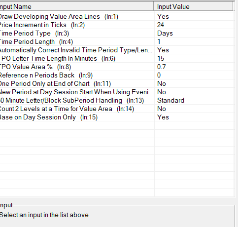

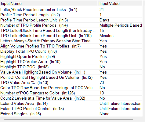

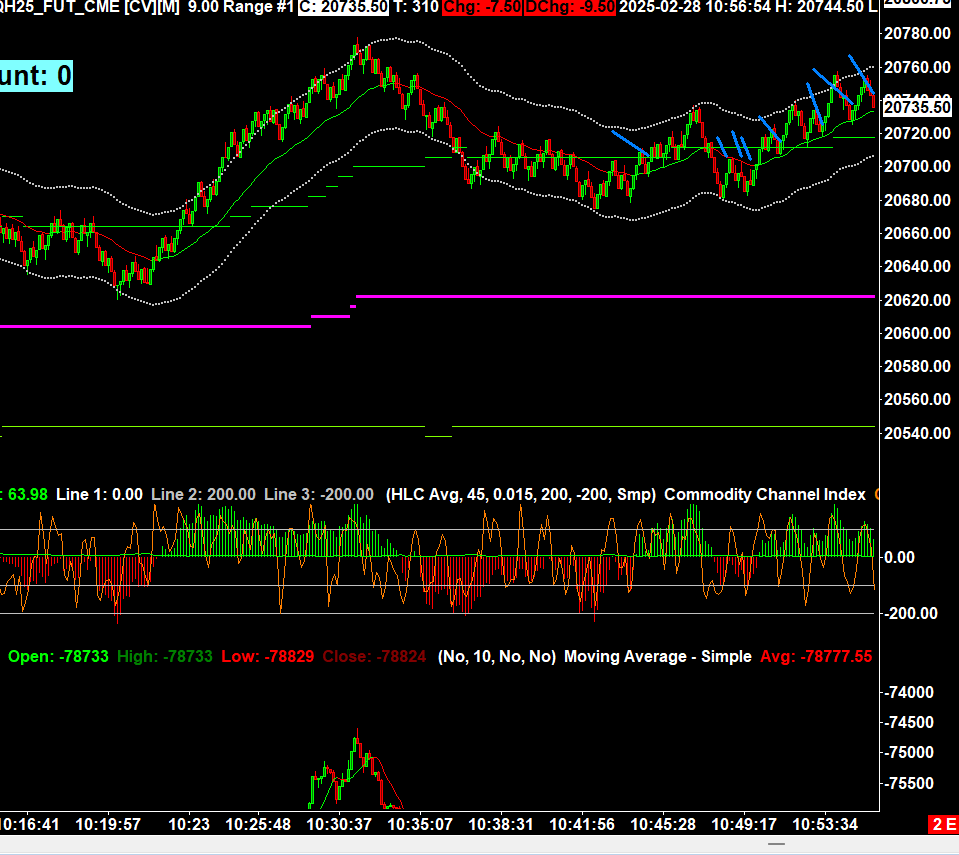

I tried to put the TPO study on the chart and line it up with a regular TPO chart on its own. Attached are the settings. The lines are off by quite a bit and the TPO value lines on the price chart dont line up to the TPO chart.
I lined up the times in this picture so the TPO chart was at the same time as the price chart attached. I also put the settings I have for each.
imagetposettings.png / V - Attached On 2025-03-01 00:04:58 UTC - Size: 14.34 KB - 225 views
imagevalueareasettings.png / V - Attached On 2025-03-01 00:05:01 UTC - Size: 11.66 KB - 240 views
imagetpo1.png / V - Attached On 2025-03-01 00:05:04 UTC - Size: 178.28 KB - 239 views

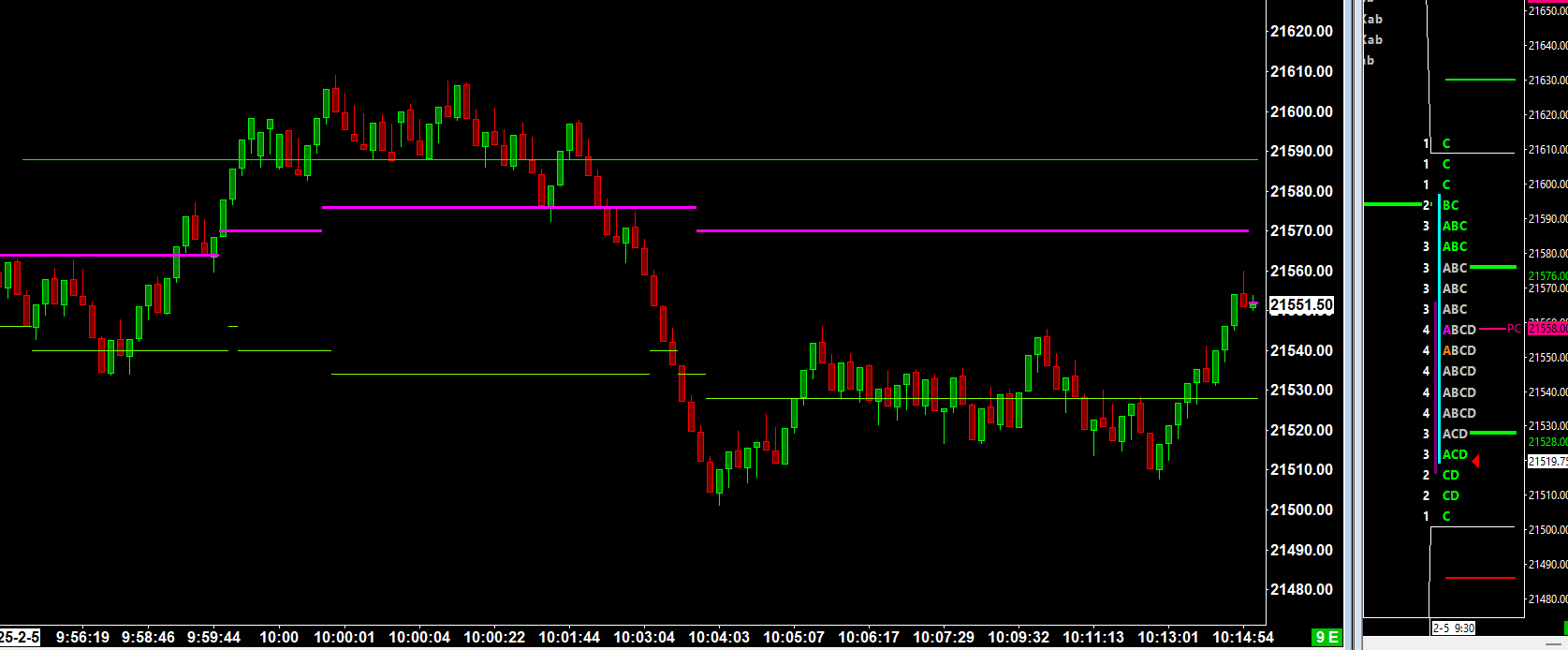

[2025-03-01 00:05:31]
User969241 - Posts: 155
1 more picture
imagetime1.png / V - Attached On 2025-03-01 00:05:27 UTC - Size: 33.47 KB - 230 views

One thing we see is that the "TPO Value Area Lines" has the Input for "Base on Day Session Only" set to "Yes". We do not know if the TPO chart is setup the same way or not. Be sure to double check this.
We can not tell what is occurring from your images as the images are too busy. You would need to give us an image with just the TPO chart showing just the lines (no other studies or drawings) and the same for the regular bar chart.

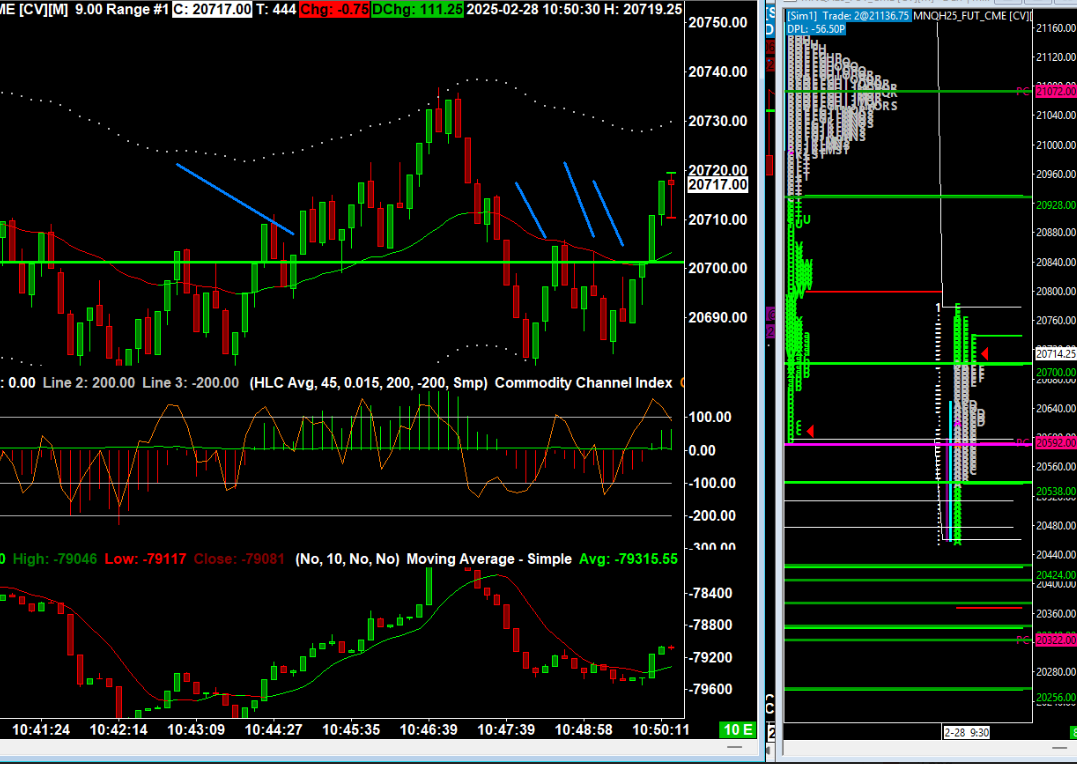

Let me know if this helps. Both are based on Day only. That is correct. I only want the values for 9:30-4PM.
imagetpo.png / V - Attached On 2025-03-03 21:57:17 UTC - Size: 61.27 KB - 213 views

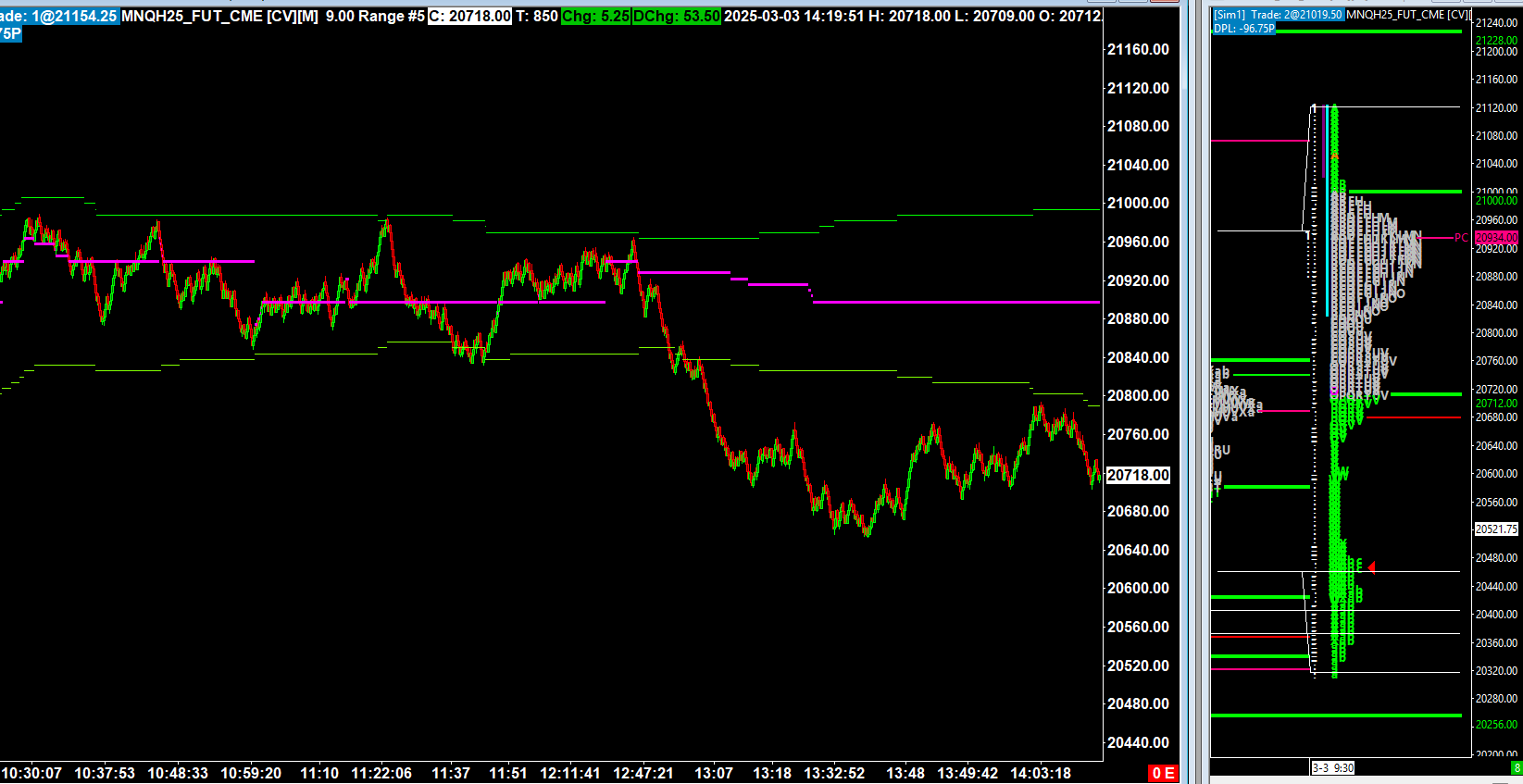

Here is another shot I took.
imagetpo2.png / V - Attached On 2025-03-03 22:39:58 UTC - Size: 33.52 KB - 189 views
