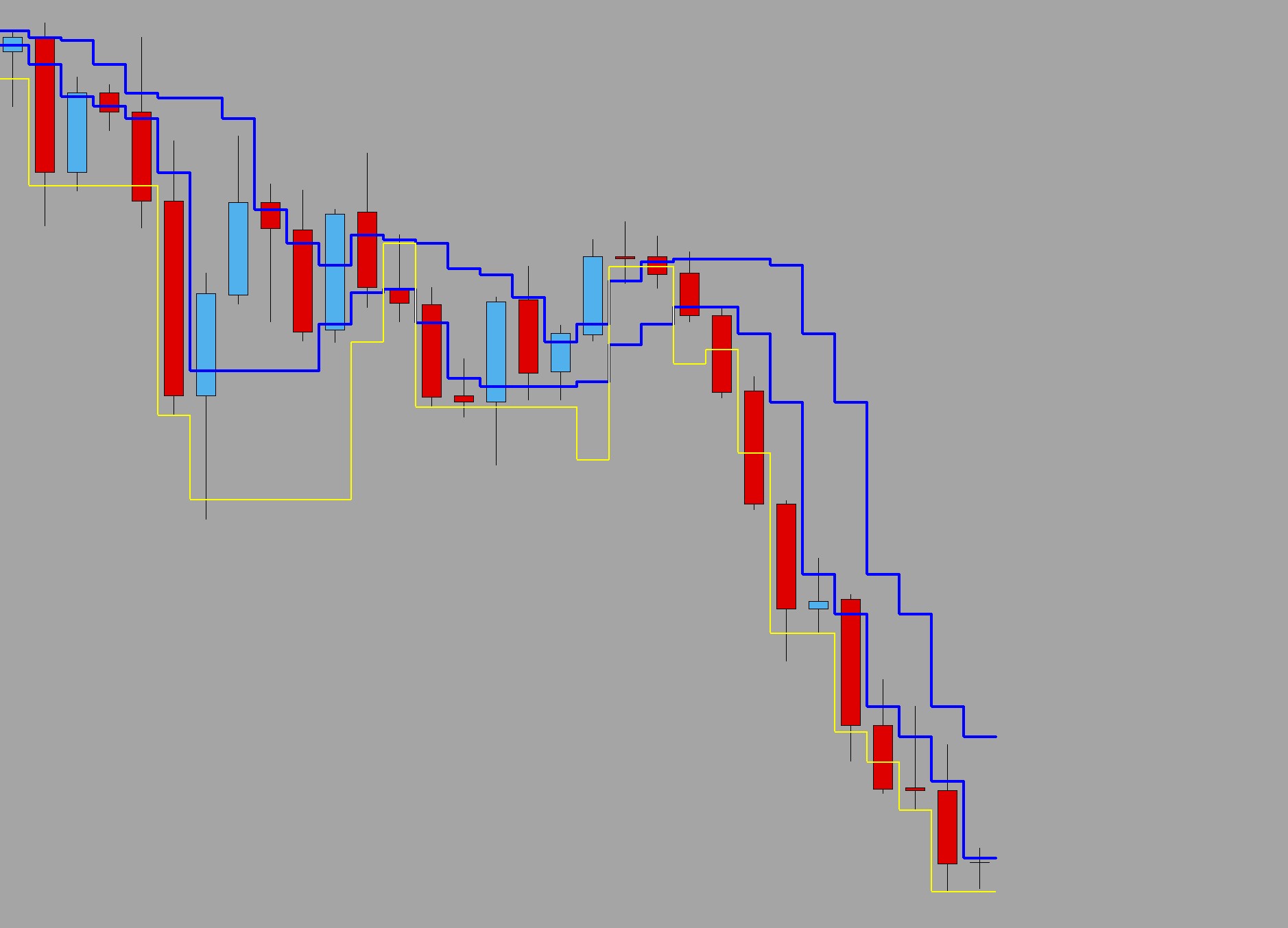

[2025-02-27 21:54:44]
cmet - Posts: 743
Not sure if this is what you were looking for but here's a Rolling Volume Value Area custom study.
Lets you plot any time frame from 1 to 1440 minutes onto any other chart and determine the % for the value area.
Attached image below is 60 min plotted on a 15 minute ES chart using 70%. Yellow line is VPOC.
Probably not the most efficient study but maybe someone else can tweak it if you need it faster.
Date Time Of Last Edit: 2025-02-27 22:02:36
imageroll_val_es_f.jpg / V - Attached On 2025-02-27 21:54:10 UTC - Size: 115.93 KB - 264 views
attachmentRoll_VAL.cpp - Attached On 2025-02-27 21:54:14 UTC - Size: 3.8 KB - 287 views

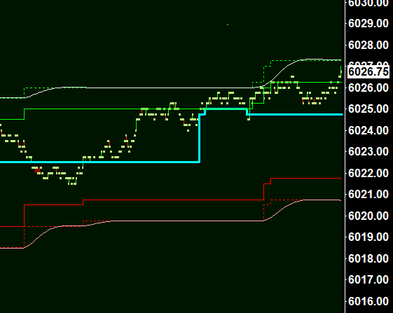

[2025-02-27 22:30:09]
User936721 - Posts: 32
Here is what I'm trying to replicate
1 sec chart, yes, fast
green line VAH
blue line - POC
red line VAL
VA lines:
Draw dev - yes
tick / vol - 1
period - mins
Period length - 60
vol % 0.7
https://www.sierrachart.com/Download.php?Folder=SupportBoard&download=116126
imageScreenshot 2025-02-27 222207.png / V - Attached On 2025-02-27 22:28:58 UTC - Size: 20 KB - 210 views
[2025-02-27 22:43:21]
The SC VA lines works perfectly but as I’m currently using them as dynamic TP / SL levels, it can’t work as each hour they reset and start developing again. I could turn off my dynamic tracking ( then an hour VA line reset would not be a problem, but tracking the TP generally works well

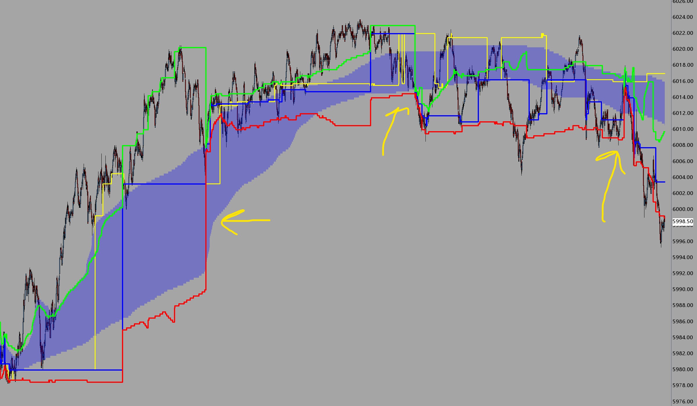

[2025-02-28 02:11:25]
cmet - Posts: 743
What do you mean by "dynamic tracking"?
Also, since the Sierra study does not use a rolling window, the plots won't match. I'm assuming you know that already though.
If I understand correctly, you want first period (60 mins) to reflect the same developing value lines as the internal study, and then start using a rolling calculation from there that does not reset to the first trades/volume of the 2nd 60 min window?
What I posted is basically continuous developing value.
This is how it plots against the sierra internal study using the settings above. Yellow arrows are where internal study resets.
image1.jpg / V - Attached On 2025-02-28 02:09:49 UTC - Size: 295.69 KB - 200 views
