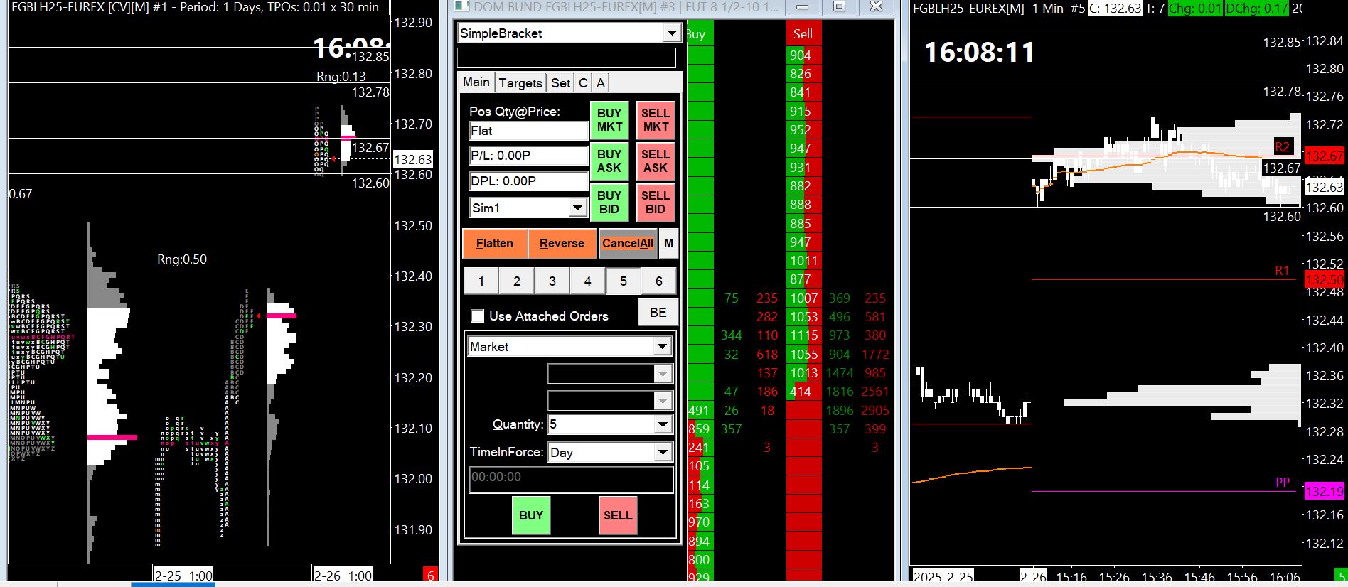

I'm missing data from yesterday morning until now. As you can see on the market profile and the graph. how to solve this problem? thanks

The chart on the right has bars going to the end of the chart and the last time that is showing in the Time Scale is February 26 at 16:06 and the clock on the chart shows that the time is 16:08. Therefore, the chart looks correct.
TPO charts do not use the time scale in the same way, so we can only see that a profile is being drawn for February 26 starting at 01:00, so this could be correct.
If you are missing data in between a period, then refer to the following:
