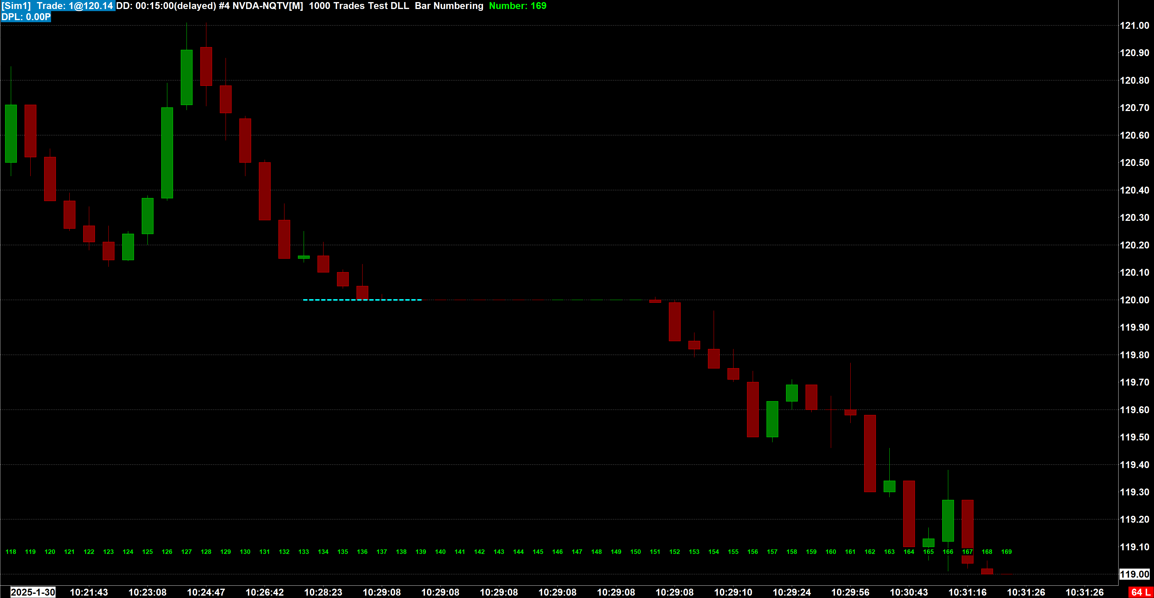

Problem Description:
When I use the s_UseTool drawing tool to draw a line on the chart, it only displays partially.
I observed that this issue occurs when the drawing line starts/ends with 3 or more dashed bars (High = Low bars).
I am using a manual loop.
Why I Don't Think It's an Issue with My Code:
After simply changing the index, the drawing displays correctly. This can be observed in the attached screenshots: good.png (index = 133) and bad.png (index = 143).
Chart: NVDA_NQTV 1000 Tick Bar
Version: 2741
Date: 2025-01-30 to 2025-01-30
core code:
if (index == 133) {
  s_UseTool Box;
  Box.Clear();
  Box.ChartNumber = sc.ChartNumber;
  Box.DrawingType = DRAWING_LINE;
  Box.AddMethod = UTAM_ADD_OR_ADJUST;
  Box.BeginValue = 120.00f;
  Box.EndValue = 120.00f;
  Box.Color = RGB(0, 255, 255);
  Box.BeginIndex = index;
  Box.EndIndex = index-10;
  Box.LineWidth = 5;
  Box.LineStyle = LINESTYLE_DASH;
  Box.TransparencyLevel = 50;
  Box.AddAsUserDrawnDrawing = 1;
  LineNumberCounter++;
  Box.LineNumber = LineNumberCounter;
  sc.UseTool(Box);

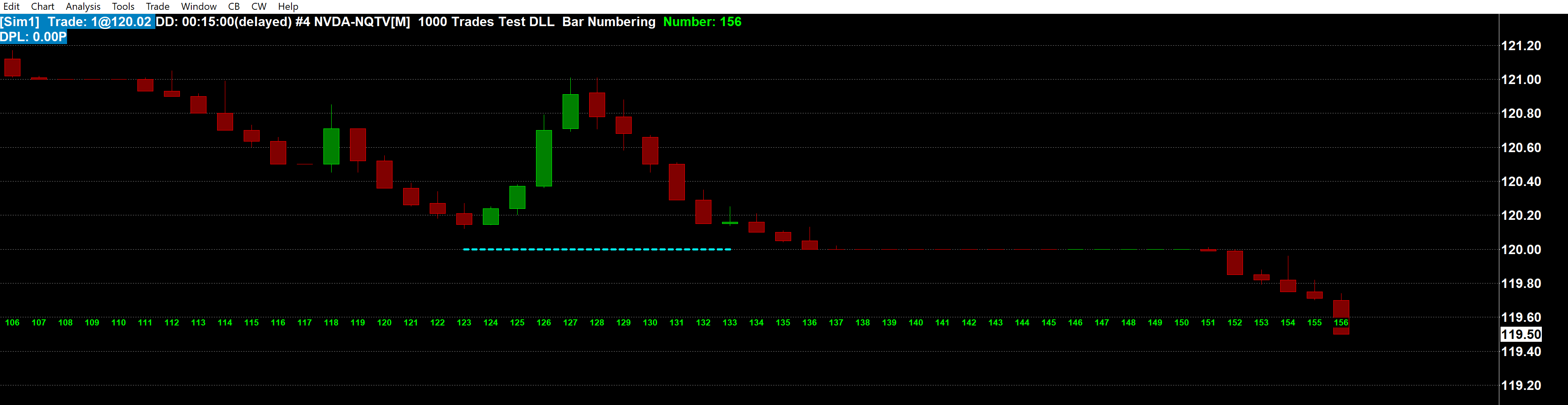

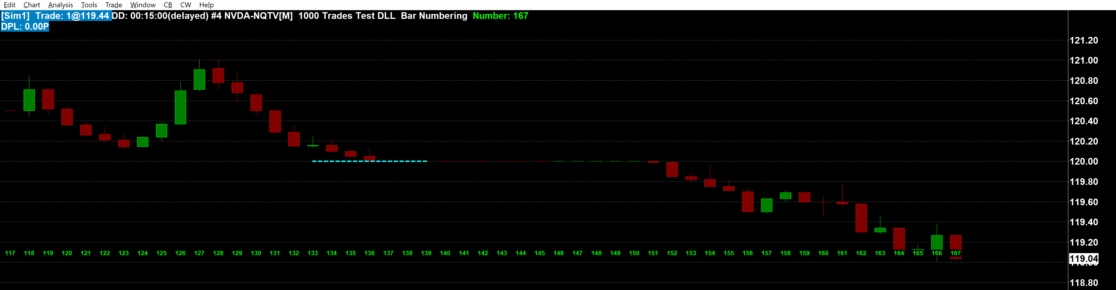

Screenshots: Attached (good.png and problem.png)
good:
https://www.sierrachart.com/image.php?Image=1740491070281.png
bad:
https://www.sierrachart.com/image.php?Image=174049112627.png
imagegood.png / V - Attached On 2025-02-25 13:38:14 UTC - Size: 70.18 KB - 224 views
imagebad.png / V - Attached On 2025-02-25 13:38:19 UTC - Size: 69.84 KB - 192 views

There definitively is no bug . This is not even possible.
Change this line like this:
Box.AddAsUserDrawnDrawing = 0;
Do not make the drawing user drawn.
