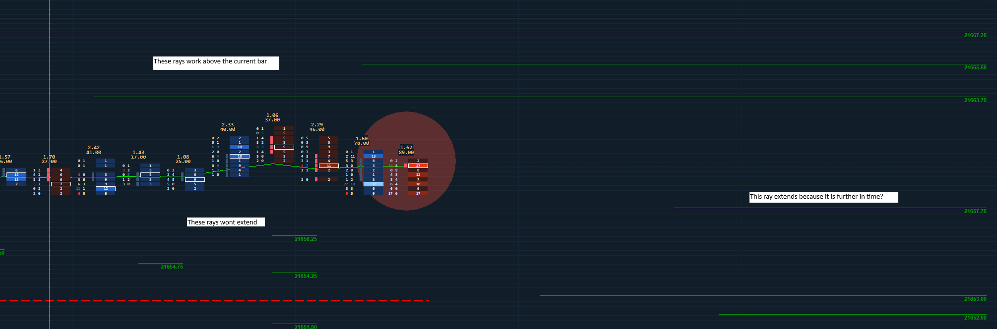

Not sure how this happened, but it was working fine last week, but now any time I use the horizontal ray tool it wont extend unless I plot it above the the current bar or further in time from the current bar.
imageScreenshot 2025-02-23 115745.png / V - Attached On 2025-02-23 17:00:26 UTC - Size: 47.22 KB - 242 views

We are not seeing any issue with the Horizontal Ray tool.
Have you used the option for "Cutting" the rays that are not extending? How exactly were these drawn? While drawing, are you seeing the ray extending?

I tried both with hot keys and just by going to tools -> horizontal ray.
It looks like it has to do with the extend until future intersection option. When I turn it off the ray extends properly. Turning it on causes the issue in my original post / screenshot.
