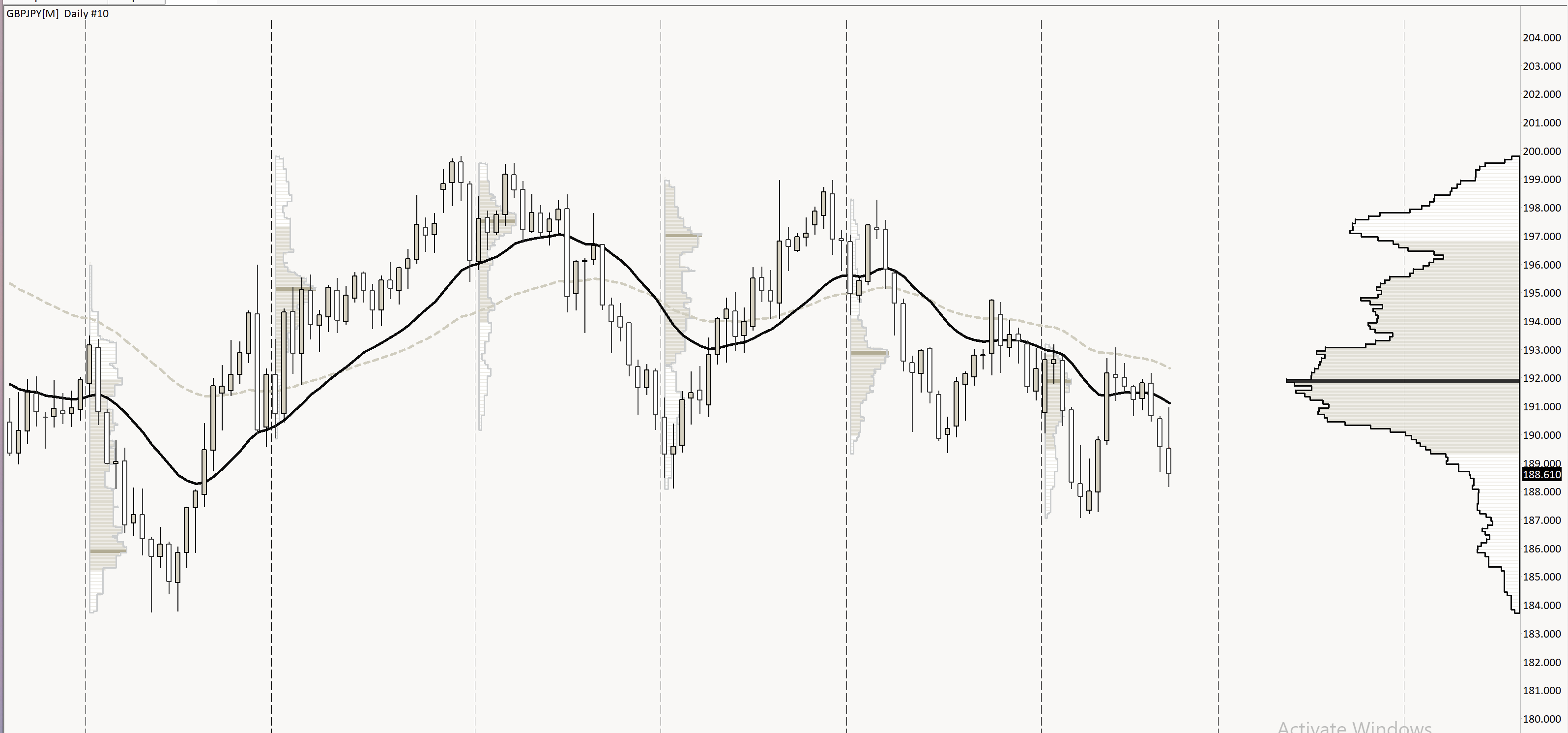

I have all my 'timeline' studies added to the H1, H4 etc. charts where they all perfectly align with my daily volume profiles. I'm also looking to do this for my D1 charts. The problem is that I can't figure out how, it's slightly misaligned no matter what I try.
- At the moment, my current volume profiles (as they should) all start on the 1st of the month at 00:00:00.
- At using the timelines study, I can't seem to set it in a way where it aligns exactly with the profiles *see attachment
- At using the chart settings display with the vertical grid, it again is close, but not quite there.
Maybe I'm missing something obvious here. Please let me know if you have the answer. Thank you.
imageScreenshot 2025-02-22 at 17.12.37.png / V - Attached On 2025-02-22 16:16:05 UTC - Size: 347.92 KB - 264 views
[2025-02-24 16:13:28]
John - SC Support - Posts: 48239
We are not certain how you are using the "Time Line" study for a daily chart. There is no support for this.
As to the Vertical Grid, for weekly and higher timeframes the lines are drawn between the bars, therefore what you are seeing is normal. There is no way to change how this occurs.
