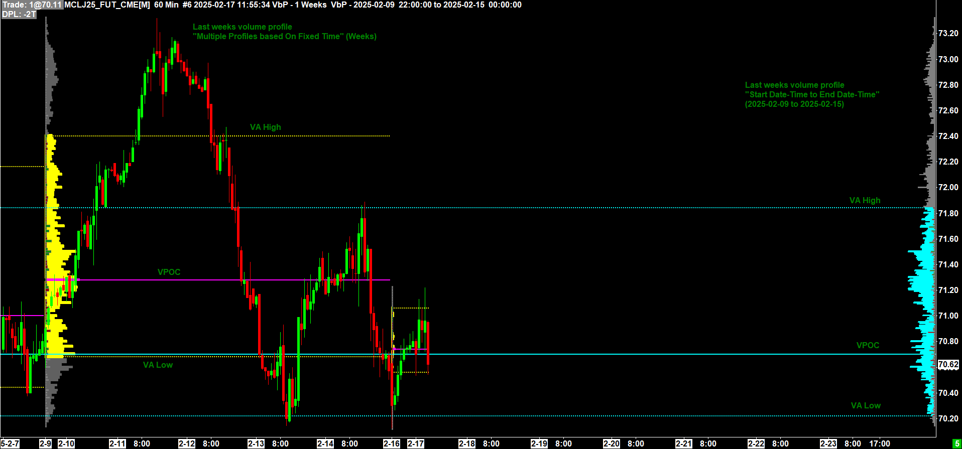

I'll try to be as concise as possible but please bare with me.
I have a VBP study set up as "From start date-time to End date-time" to cover the previous week (2025-02-09 to 2025-02-15) Mon-Sat, aligned to the right. On the same same chart I also have another VBP study set up as "Multiple Profiles Based On Fixed Time" as "Weeks", so this gives me all previous weeks volume profiles, aligned to the left.
So in theory, the "start date-time to end date-time" profile on the right should be identical to the most recent "multiple profiles based on fixed time" profile on the left, however, the VA levels and the VPOC levels are wildly different, in the range of 50-60 tics different (MCL symbol).
I've been careful to account for global market open and close times.
I've always noticed slight differences but they've been negligible (a few tics, maybe 5 at the most), but not how I'm seeing it now. Can you shed any light on this for me please?
One thing that has changed is that I had to roll-over the symbol this morning, so I'm assuming this has something to do with it?
I have posted a screenshot below.
Many thanks.
https://www.sierrachart.com/image.php?Image=1739793345544.png

Check the Ticks per Volume Bar setting, it looks like left hand VBP is set to 2, and right hand VBP is set to 1.

Thank you, that's exactly what the issue was. Your help is greatly appreciated!
