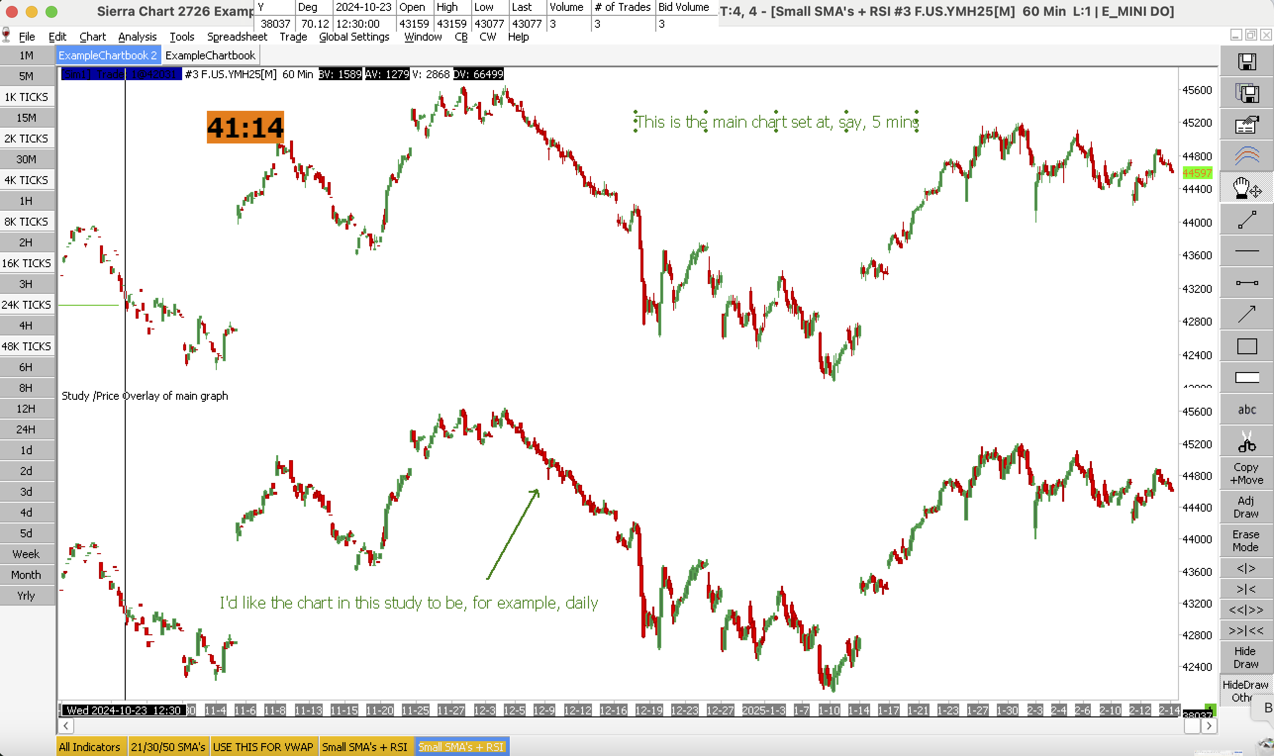

...once the main chart has been duplicated, can i change the time period of the duplicate chart so it's different from the main chart? and if i decide to change the main chart into say a line graph, how do i change the duplicated chart into a line graph also?... i suppose what i'm asking is, can the duplicate chart be controlled autonomously to the main chart? tia

[2025-02-14 20:50:06]
SafSaf - Posts: 160
i've attached a screen shot of what i'm looking for...
imageScreenshot 2025-02-14 at 20.48.45.png / V - Attached On 2025-02-14 20:49:50 UTC - Size: 305.78 KB - 292 views
[2025-02-14 22:41:35]
There is not a way to do exactly what you are asking for - where you can have one time period in one region and a different time period in another region. The workaround for this is to have 2 charts and have them stacked horizontally one above the other so you have visually what you want.
