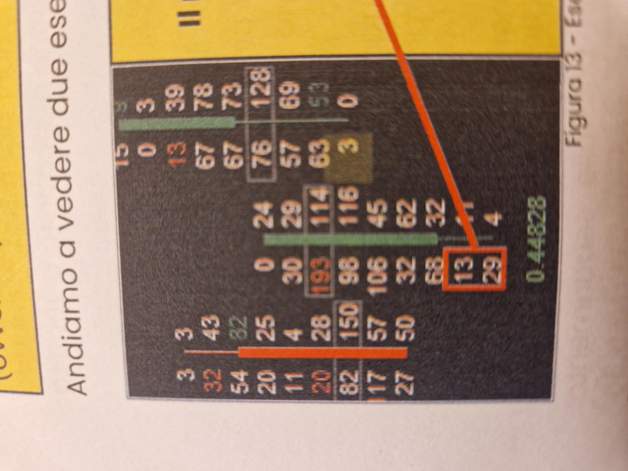

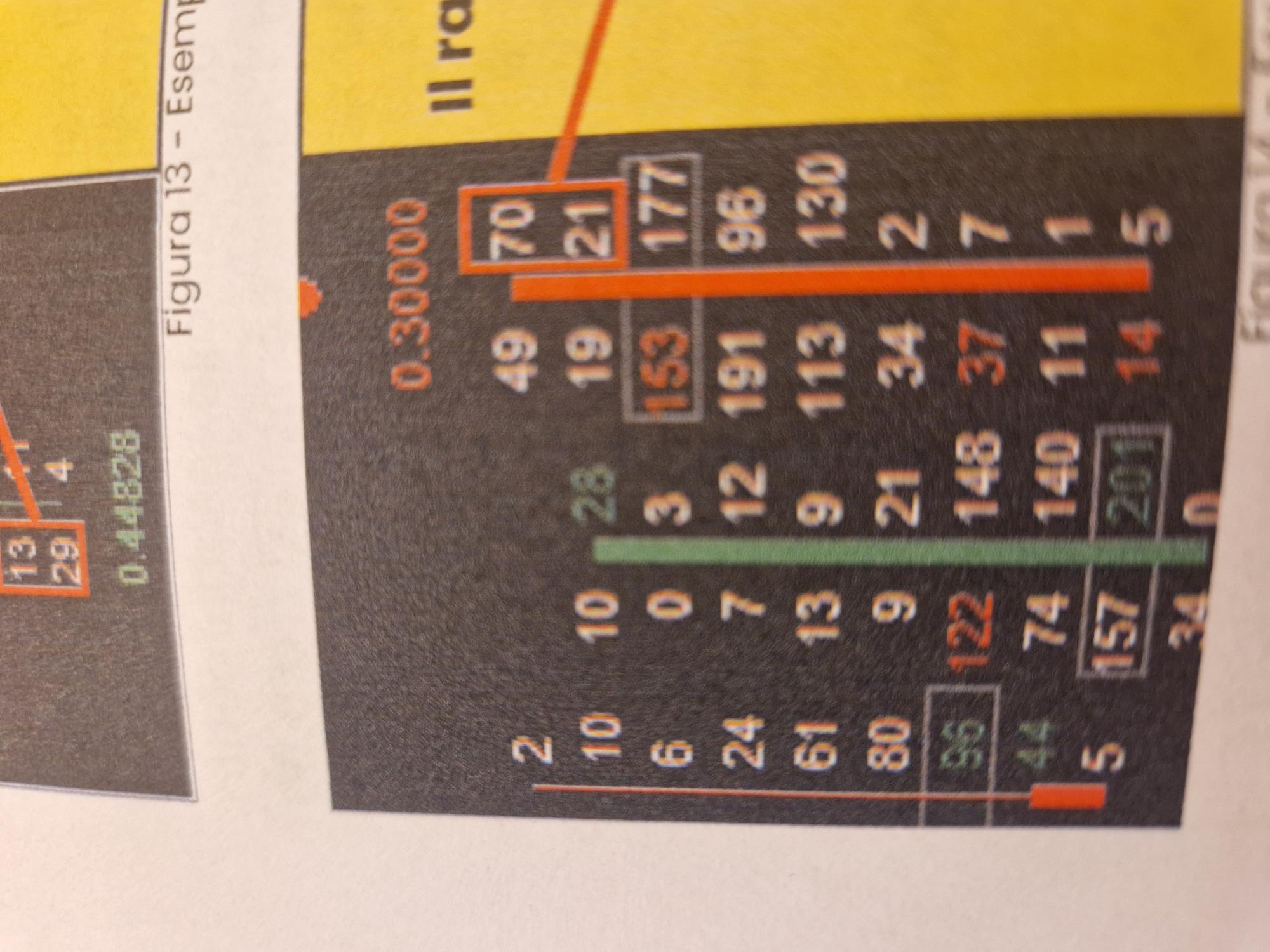

I need to create a simple ratio
for bearish candles the calculation is as follows starting from the top of the candle: second value ask column divided by first value of the same column
For bullish candlestick the calculation is as follows: starting from the bottom the penultimate bid column value divided last bid column value
I have followed the guides on the site but I cannot, which studies should I use?
I attach photo of what I would like to get
image1.jpg / V - Attached On 2025-02-14 17:36:09 UTC - Size: 254.67 KB - 185 views
image2.jpg / V - Attached On 2025-02-14 17:36:17 UTC - Size: 263.43 KB - 188 views

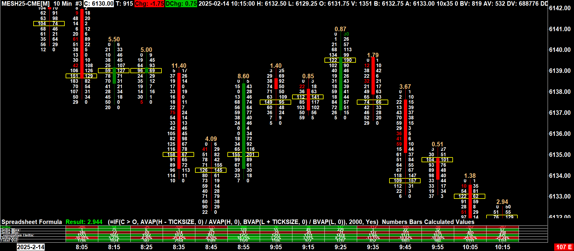

I copy and paste your formula and this is what I see (I've uploaded screen from Sierra)
As concrete example: green candle at the center with 8.60 should displayed (23/7)=3,28 and red candle with 4.09 should display (29/6)=4,83
How can I fix the formula to obtain this?
https://www.sierrachart.com/image.php?Image=1739570886534.png
Thank you
[2025-02-14 22:49:30]
Sorry - yes, we reversed the Bear and Bull candles. The formula should be the following:
=IF(C > O, BVAP(L + TICKSIZE, 0) / BVAP(L, 0), AVAP(H - TICKSIZE, 0) / AVAP(H, 0))
