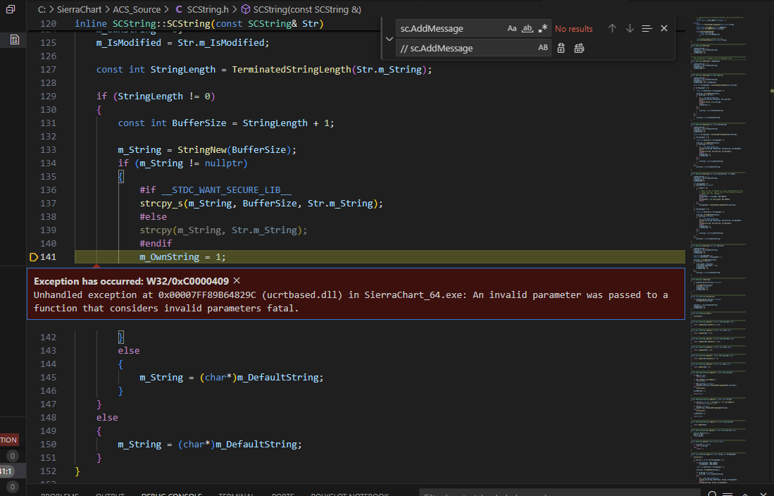

Summary:
Sierra Chart crashes with a "Buffer is too small" error (corecrt_internal_string_templates.h) during high-speed Chart Replay backtesting in sim accounts when using sc.GetTradePosition. The issue is linked to SCString Symbol and TradeAccount in s_SCPositionData.

Suspected Cause:
Potential buffer or corrupt string issue in sc.GetTradePosition or SCString handling during rapid backtesting. The issue occurs when passing the s_SCPositionData instance to functions that cause a copy. In particular, with the Symbol and/or TradeAccount strings.

imageScreenshot 2025-02-13 182257.png / V - Attached On 2025-02-14 12:54:48 UTC - Size: 110.8 KB - 203 views

I have seen strange exceptions under the debugger (very rarely) in the Sierra SCString class. In my case, strings were being assigned in SetDefaults for inputs. But no solid repro for me. I have always been able to continue, and Sierra loads charts as expected.
Also sounds like you are causing a copy of the s_SCPositionData struct and not passing by const reference. (guessing here)
Are you modifying this data?
If you share the most trimmed down study code that can reliably repro this, I will compile it locally and run it on my machine to see if I get similar results.
