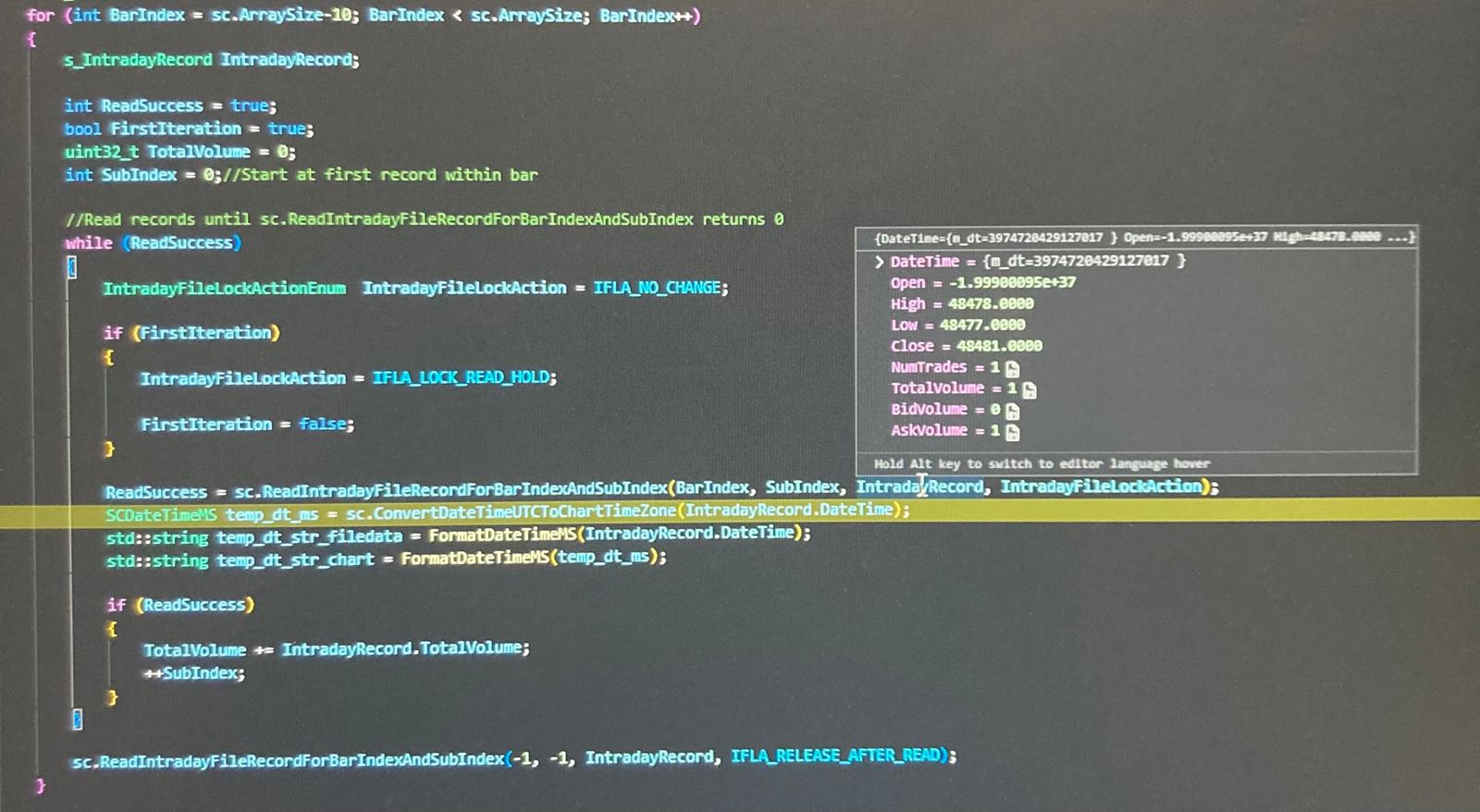

[2025-12-15 08:05:23]
Pavel - Posts: 6
please see the debug picture.
Could you please advise why the Open price is not being returned correctly in s_IntradayRecord IntradayRecord?
The Open price is not valid for all file indexes.
The same issue occurs when using sc.ReadIntradayFileRecordAtIndex.
Thank you, Pavel
images_IntradayRecord.jpg / V - Attached On 2025-12-15 08:00:35 UTC - Size: 147.82 KB - 120 views
[2025-12-15 12:32:04]
User431178 - Posts: 910
It's documented, you can read it here: Intraday Data File Format
