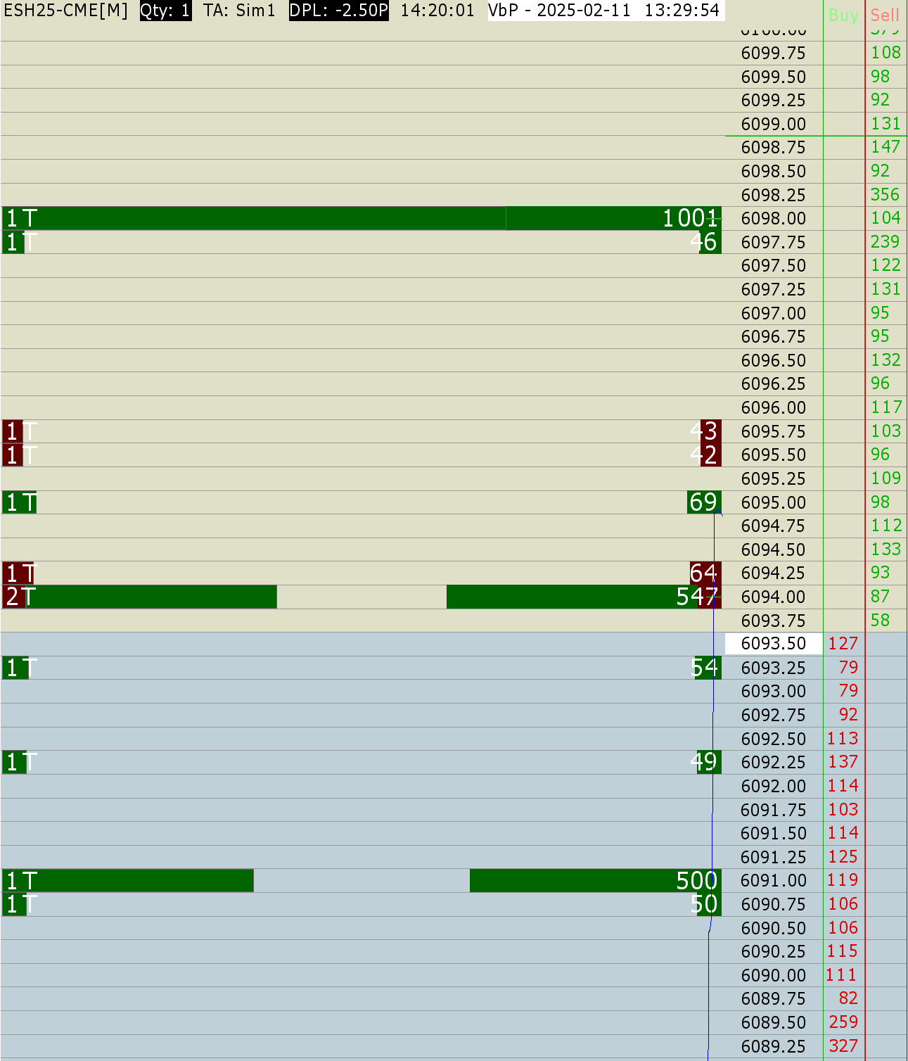

[2025-02-11 20:25:02]
John - SC Support - Posts: 48142
1. We are not seeing any line on the DOM in the Chartbook you have sent us. Attache is an image of what we see.
Did you copy the DOM to a new chartbook and send us that, or is this the actual chartbook where you are seeing the line?
2. There are keyboard shortcut options for the following:
- Reset Scales (default setting is "Alt - Shift - R")
- Reset Scales - All Charts
- Auto Scale the ChartDOM
Refer to the following for how to setup Keyboard Shortcuts:
Global Settings Menu: Customize Keyboard Shortcuts (Global Settings menu)
imageESH25-CME[M] #1 2025-02-11 14_20_01.508.png / V - Attached On 2025-02-11 20:21:08 UTC - Size: 138.5 KB - 225 views

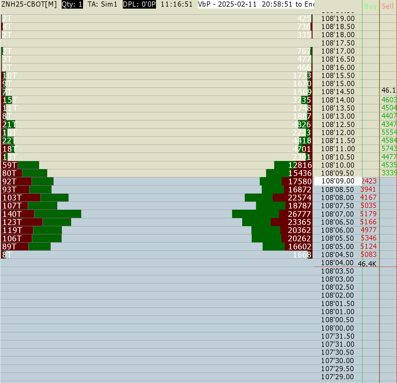

[2025-02-11 22:26:00]
We do not see the same Control Keys that you have set when you send us a chart. The Control Bar settings are stored in the global settings files Sierra4.config. What exactly are those buttons set to (what item in the Control Bar list)?
[2025-02-12 17:20:01]
Sorry, but we still do not see it. Attached is an image of what we see.
The things to try are the following:
- Remove any extraneous studies to ensure that it is not a study causing it.
- Duplicate the Trading DOM and see if the line shows on the duplication. If it is, then remove all studies, one by one, to determine if it is coming from any study.
- If it is not from a study, then select "Chart >> Tools >> Manage Chart Drawings Window" and remove any drawings that are on that Trading DOM.
imageZNH25-CBOT[M] #1 2025-02-12 11_16_52.286.png / V - Attached On 2025-02-12 17:17:39 UTC - Size: 157.76 KB - 223 views
