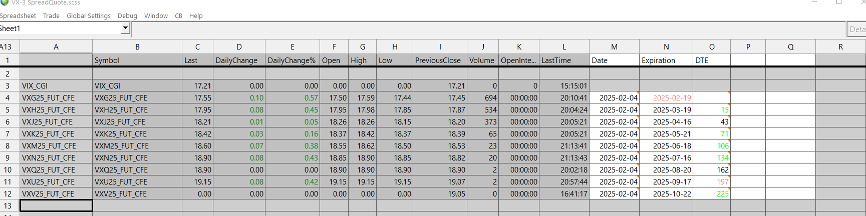

User841161 - Posts: 357
Should either format update at approximately the same rate(know it is delayed), because when i replaced VX?##_CFE with the VX?##_FUT_CFE format. The LastTime column for most of symbols are approximately an hour and a half behind it. Before changing the symbols had updated all around 21:15-21:42.
image02-4-25.PNG / V - Attached On 2025-02-05 04:15:49 UTC - Size: 60.79 KB - 288 views
[2025-02-05 05:29:40]
They are identical. But when you start using the other symbol format you must completely remove the use of the symbol format you were using previously and reconnect with File >> Reconnect.
