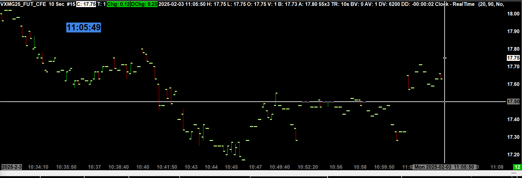

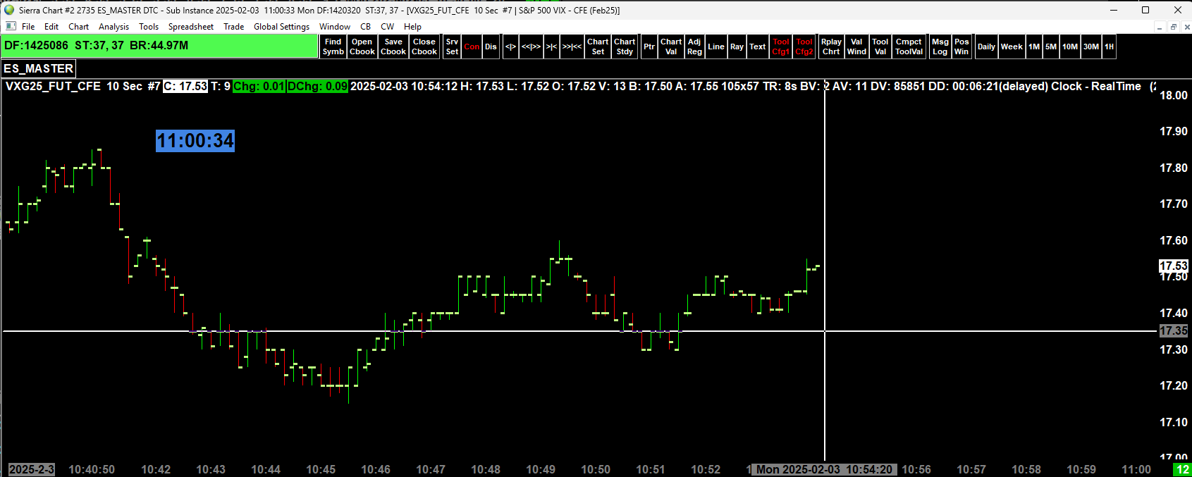

User677437 - Posts: 102
VXG25_FUT_CFE the mini does not update for me. The micro chart DOES update live VXMG25_FUT_CFE.
I also brought up VXH25_FUT_CFE and that one doesn't update live either.
It looks like the micro feed updates live, but not the mini feed.

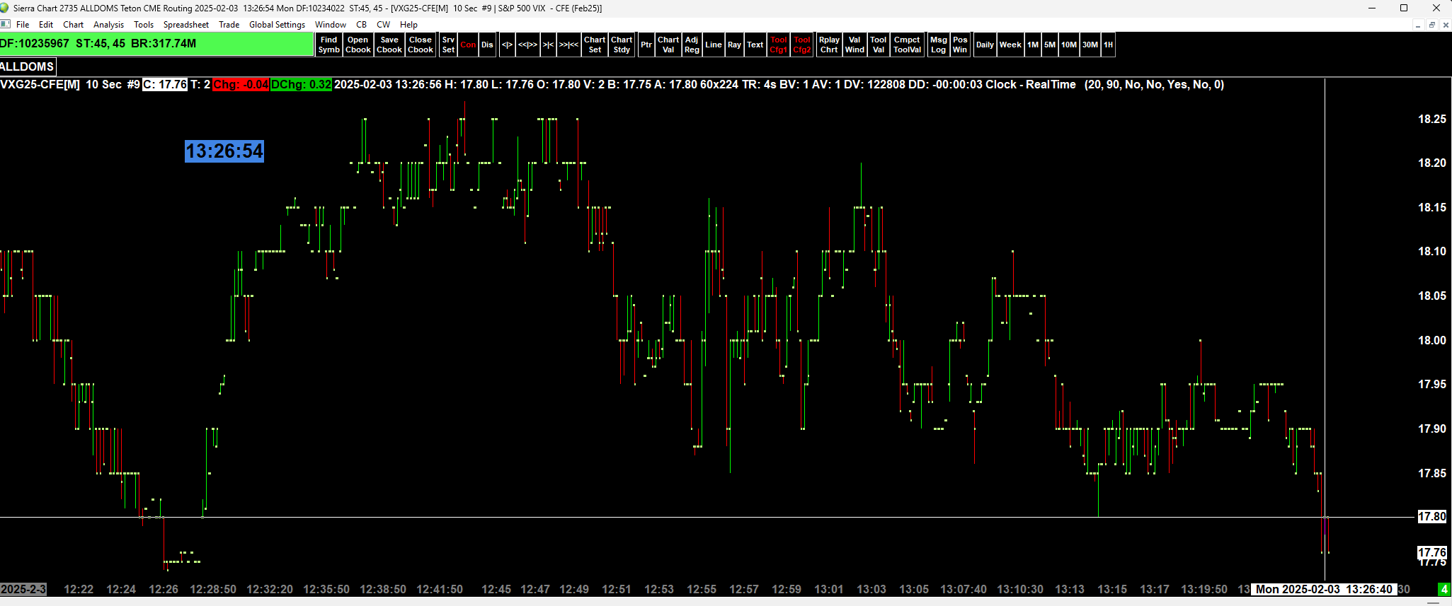

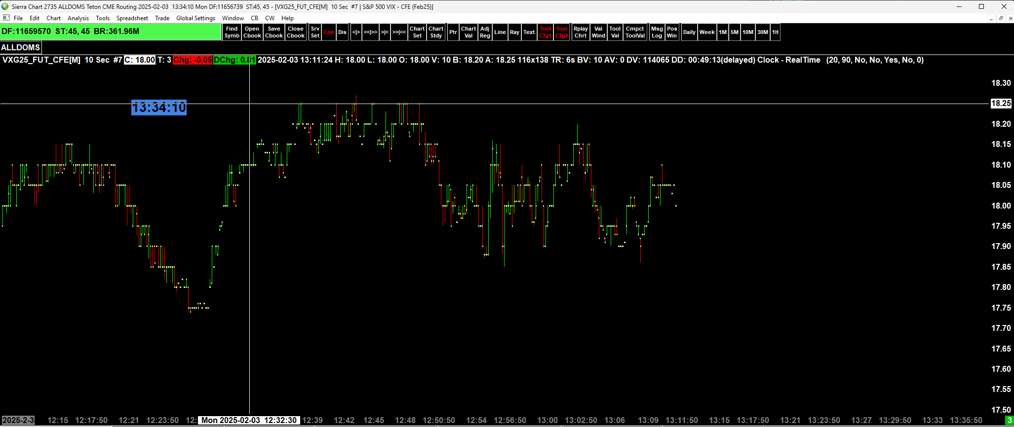

Opened up the charts back up again in the main instance, data downloaded, but fails to update live on 10 second chart on VXG25_FUT_CME. - the second screenshot.
VXH25_FUT_CFE doesn't update live either on the main instance.
There should be plenty of range that I'm not seeing, it's not like non consistent update interval on the other contracts.
I tried the CFE feed,
VXG25_CFE does update live. - The first screenshot.
We should be using the _FUT_CFE feed right ? The 2 different feeds should all be working ?
