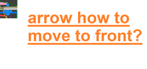

I've few indicator on same chart, 1 of the indicator is an arrow behind another indicator,
how to display the arrow in front? Please see attached arrow pic for the issue.
What code or function or setting to display the arrow in the indicator to the front?
Appreciate advice and help....
Date Time Of Last Edit: 2025-02-02 12:15:14
imagearrow.png / V - Attached On 2025-02-02 12:08:37 UTC - Size: 19.76 KB - 209 views
[2025-02-02 13:34:54]
JohnR - User831573 - Posts: 340
I have not used this, but this should get what you want based on the docs.
Hope this helps,
John
s_UseTool::DrawUnderneathMainGraph
Type: Integer
When DrawUnderneathMainGraph is set to 0 (FALSE), then the chart drawing will be drawn above the main price graph and studies, independent of how the Chart >> Chart Settings >> Chart Drawings >> Draw Non-Highlight Chart Drawings Underneath Main Graph and Studies or Chart >> Chart Settings >> Chart Drawings >> Draw Highlight Drawings Underneath Main Graph and Studies options are set.
When DrawUnderneathMainGraph is not set, then the chart drawing will be drawn based on the values of Chart >> Chart Settings >> Chart Drawings >> Draw Non-Highlight Chart Drawings Underneath Main Graph and Studies and Chart >> Chart Settings >> Chart Drawings >> Draw Highlight Drawings Underneath Main Graph and Studies options are set.
The default for DrawUnderneathMainGraph is not set.
[2025-02-02 19:50:25]
cmet - Posts: 746
That's simply a matter of ordering them correctly in Chart Studies list.
