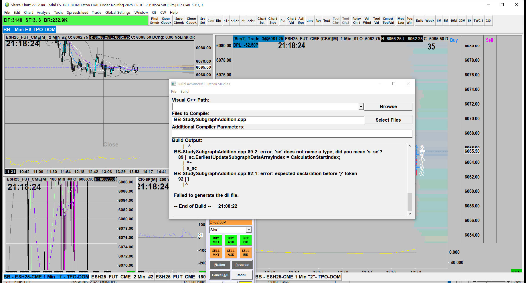

Can you forward project line in "Study Subgraph Add" as you can do with the "Current Price Line Study" ? I used the Study Subgraph Add and based it on the Current Price Line Study, which works well, however it does not have a forward project feature like the Price Line. Was hoping I could forward project the added Subgraph Add line as well.
I have gone through the Scale documentation and have not found anything that creates that feature. Not sure if I'm missing something or maybe it isn't available. Thanks in advance.

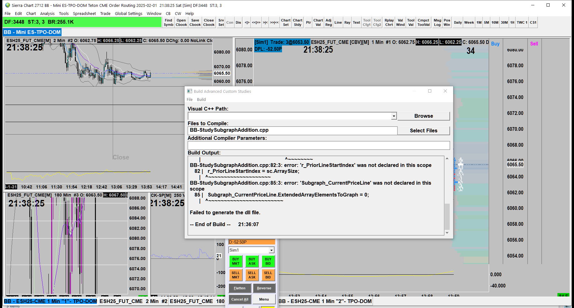

Have been working on this for a bit and keep running into dead ends. Please see the attached build error messages. I also included a PDF of the Notepad file.
imageSierra_Chart_MainWindow_2025-02-01 21_38_23.779.png / V - Attached On 2025-02-02 06:01:11 UTC - Size: 134.96 KB - 257 views
imageSierra_Chart_MainWindow_2025-02-01 21_18_22.889.png / V - Attached On 2025-02-02 06:01:18 UTC - Size: 134.64 KB - 250 views
