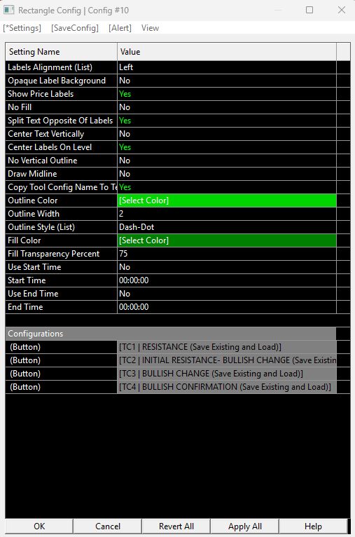

So you want to change the default configuration for the Rectangle tool? There are buttons, located on the Config tab to do this. They work as they always have.

Those are not savable. You cannot set defaults for those.
You can only change those for an existing Rectangle drawing on the chart.

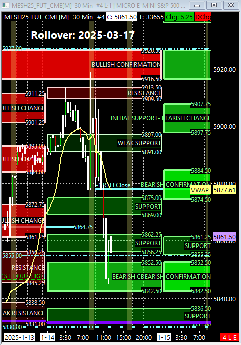

1. A 30 minute chart from Jan 14 - All the drawings on the 14th were created with the time set in the then active settings window, 9:30 - 9:29. This created a rectangle that extended to the next day.

If I have to keep using the new menu, I'd have to change the times for every drawing every day, a miserable task, and again using the settings window I would not be able to extend the chart beyond 23:59 except by pulling it right.
