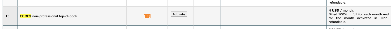

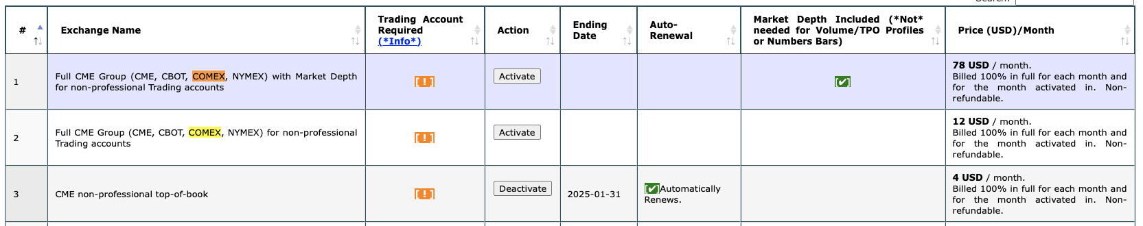

I have an active trading plan for my CME non-professional top-of-book. It’s package 11 and is set to two systems.
Can I activate this plan and add COMEX non-professional top-of-book as well? According to these screenshots, would CME get canceled, and would I only have one COMEX active?
I would like to have COMEX non-professional top-of-book alongside CME non-professional top-of-book simultaneously.

[2025-01-28 16:21:18]
Yes, you can do this.
The "CME Non-Professional Top-of-Book" will not get cancelled unless you specifically deactivate it. This is true for all the exchanges.
Activate the "COMEX Non-Professional Top-of-Book" to make that exchange active along with any other exchanges that you are already have active.
Note that the cost for the "COMEX Non-Professional Top-of-Book" is twice the standard rate since you have the option for "2 systems" selected. This option applies to all exchanges that you activate.
Also, note that exchanges are not pro-rated, so if you activate an exchange today (January 28, 2025) you will pay the full price to get the data for the remaining time in January, and then you will pay again on February 1, 2025 to get the data for the month of February.
