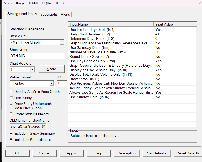

You should have day session and evening session times set up on the chart and “use evening session” set to yes. Then you add once instance of the study with “use day session” set to “no” for FS Mid and one instance with “use day session” set to “Yes” for RTH mid. I’m sure this is how I had it , I’m away from computer atm but I’ll check later
[2025-01-27 19:56:55]
weav - Posts: 60

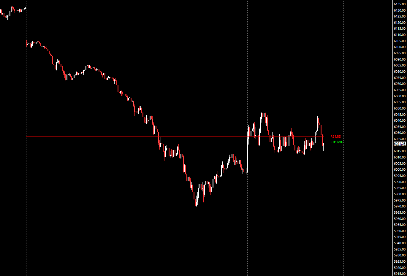

it works with Daily OHLC , attached screenshot is ES with 2 instances of the study one set to Use Day Session Yes and the other No.

[2025-01-27 22:11:04]
warpigs - Posts: 83
I think you're right, it seems to be working now. Weird. Maybe I double clicked something by accident before. It looks like it's working now though, so thanks!
