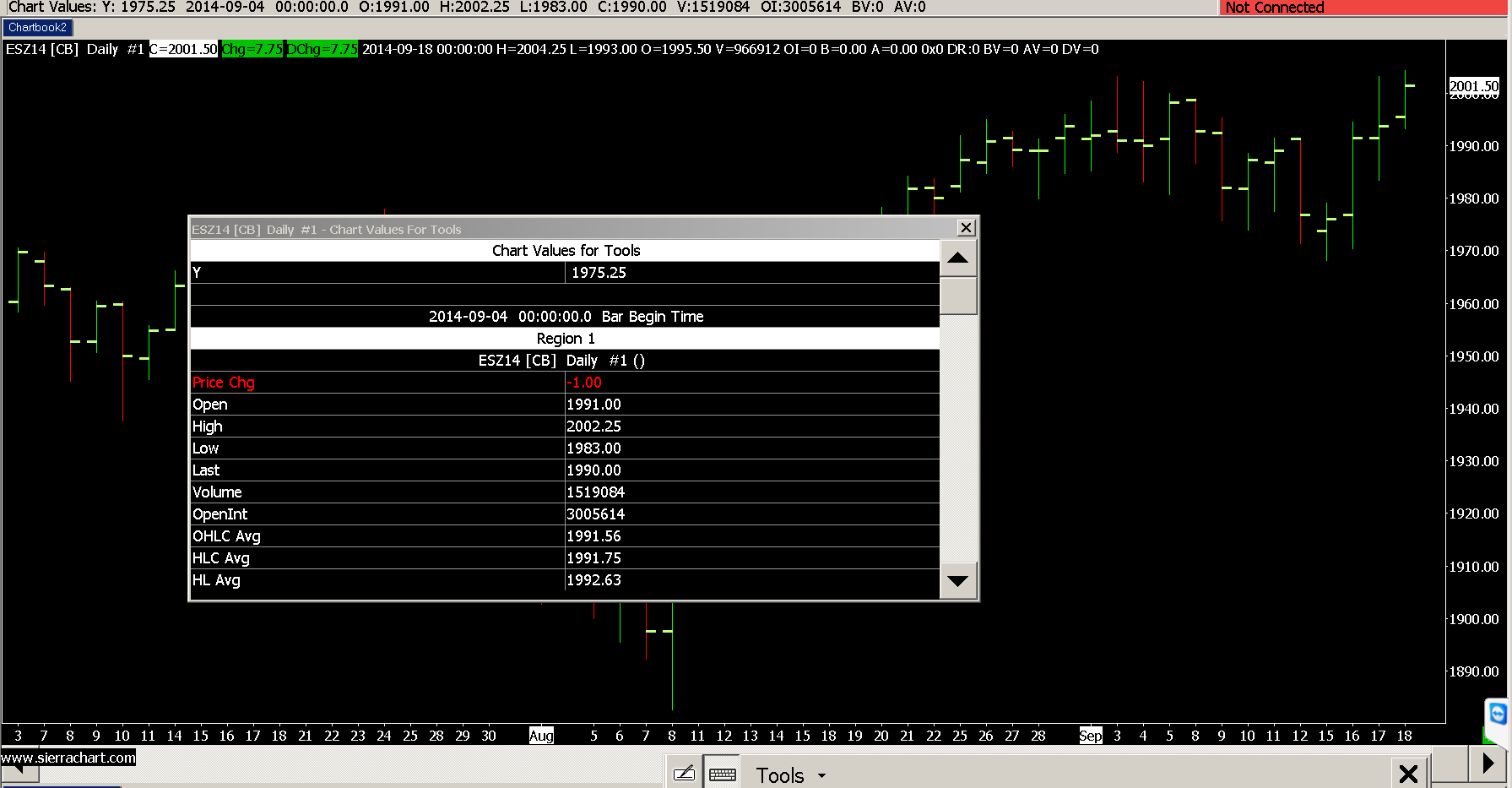

We checked on the back adjustment calculations for the ES futures.
With the method that Sierra Chart uses, which is a good method, the back adjusted high for September 4 is 2002.25 as shown in this image:
http://www.sierrachart.com/image.php?l=1411066462891.png
So there is nothing wrong with that value.
