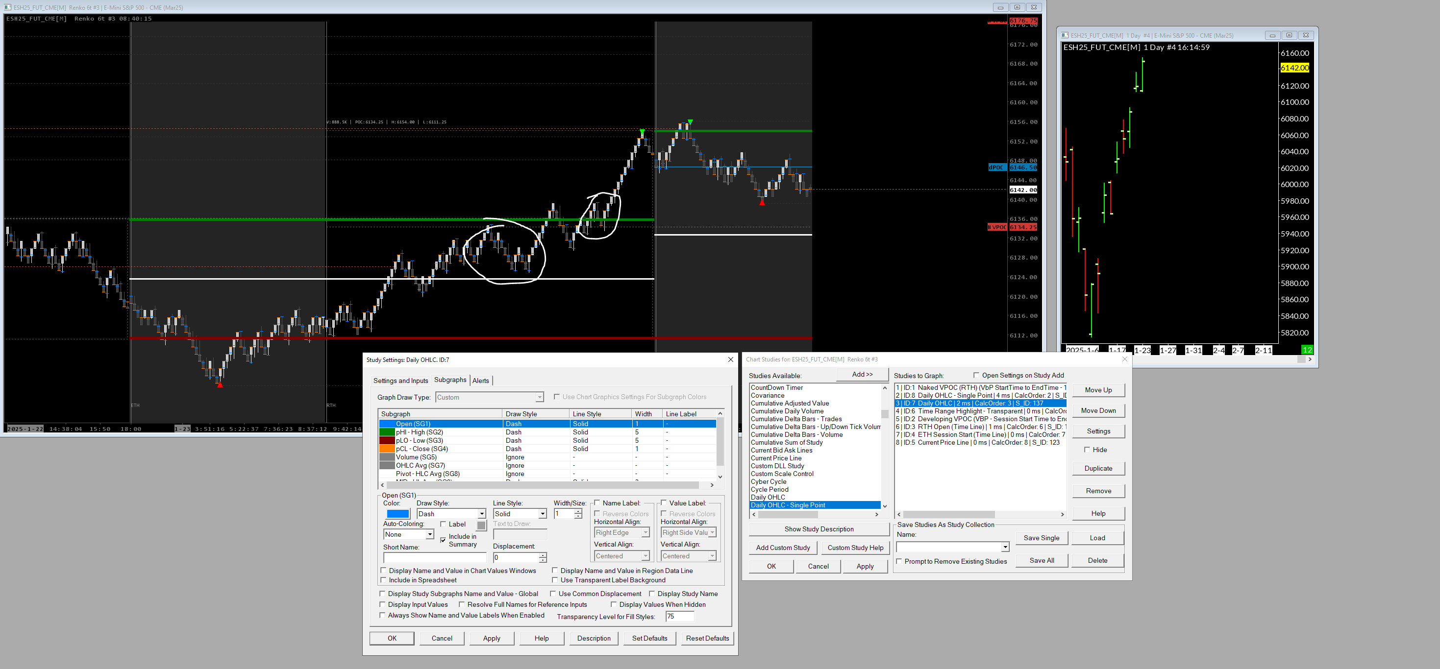

Daily OHLC drawing open and closes wrong showing each bar's vs DAY

I am not sure how to fix this High Low and Mid showing correctly but for the open and close its using each bar's value. I have it set to reference another Daily chart #4. As you can see hi low and mid are correct but the open and close shows up on each bar.

[2025-01-24 16:01:09]
You have the option for "Graph Open and Close Historically" set to "Yes". Therefore, it is showing the Open and Close for each bar, as that is showing the historical Open and Close. If you just want the Open and Close for the day, set this to "No".
