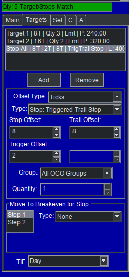

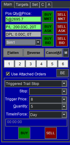

Hi guys,
I have a strange problem trying to use 'Stop: Triggered Trail Stop' - my understanding from the documentation is that if for example I set the trail offset to 8, then the stop will only begin to trail after price has move into profit by 8 ticks. However, my stop is moving immediately as soon as price starts to rise, it's not waiting for the 8 ticks to begin to move. I have provided screenshots of my current settings, and hope I have explained this clearly enough.

Change the Trigger Offset to 8.
Also the second screenshot, the order prices are completely wrong. They need to be actual prices. Not in ticks like Attached Orders.
