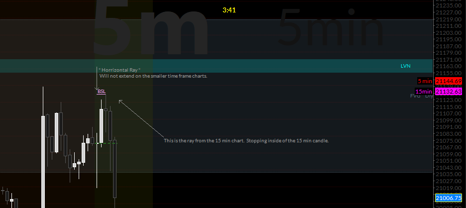

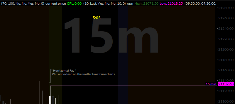

Just wanted to let you know, maybe you can fix it in the near future:
The "Horizontal Ray Tool" and maybe others, If you place the tool lets say on a 15 min chart and mark the swing high with it, extending to the right.
Then I go to say a 5 or a 1 min chart, the ray will stop at the candle just after the setting on a smaller time frame chart. So on the smaller time frame chart the ray does NOT extend if you set it to extend till further intersection.
My guess is that it is set to mark price on the fist minute of the candle rather than the last, so the 15 min chart marks price on minute one rather than minute 15, When you go to a smaller time frame and add more candles, if there is a price higher than minute 1 on the inside of the HTF candle it is stopped on the smaller time frame candles.
image5 min cht.png / V - Attached On 2025-01-20 02:13:40 UTC - Size: 27.95 KB - 239 views
image15 min cht.png / V - Attached On 2025-01-20 02:13:58 UTC - Size: 18.13 KB - 226 views

Attached is an example of what I am talking about.
As you can see the horizontal ray does not stop at an intersection on a different time frame.
You can see on the 5 min chart the ray will not extend when drawn on the 15 min chart.
This makes the tool a bit useless if you want to use drawings that translate to multiple charts.
This does not happen on every instance, but the tool can't be trusted.
I would have to say that this is an issue.
