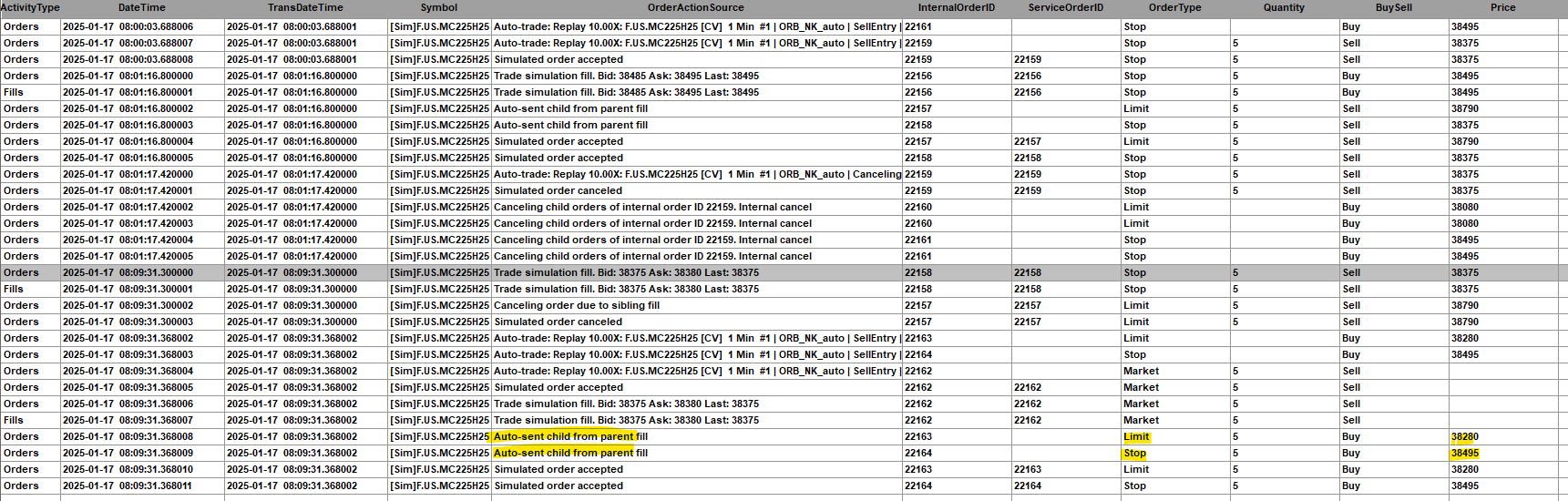

I have a trading spreadsheet that was expertly built by a very competent 3rd party. It has been extensively tested and performs perfectly in replay. The logic works every time.
- The Spreadsheet System for Trading study opens a position with Attached Orders target and stop.
- If price moves to the Attached Stop, position is reversed, and new Attached Orders are placed.
- This works as expected in sim replay. See the attached image "replay" from the the Trade Activity Log.

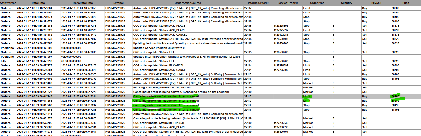

- However, in live trading the position reverses, but no Attached Orders are placed. See the attached "live" for the TAL.
The reversal and new attached orders happen at 08:09:30. In the Live TAL image, I have highlighted in green where the attached target and stop are incorrectly cancelled. In Replay TAL you see no such cancellation, which is correct. In Replay TAL I have highlighted in yellow where the attached child orders of the new reversed position are placed.
Can you offer some insight why it doesn't work as expected when trading live, and some solutions to resolve this?

[2025-01-19 21:26:46]
Go to the trade window for the chart that contains the automated trading system:
Basic Trading and the Trade Window: Opening Trade Window for Chart or Trade DOM
And make sure this is unchecked:
Basic Trading and the Trade Window: Main/C >> Menu >> Orders >> Cancel Orders on Flat Position (chart specific)
[2025-01-21 00:32:06]
User745789 - Posts: 402
That solved the problem, thank you.
