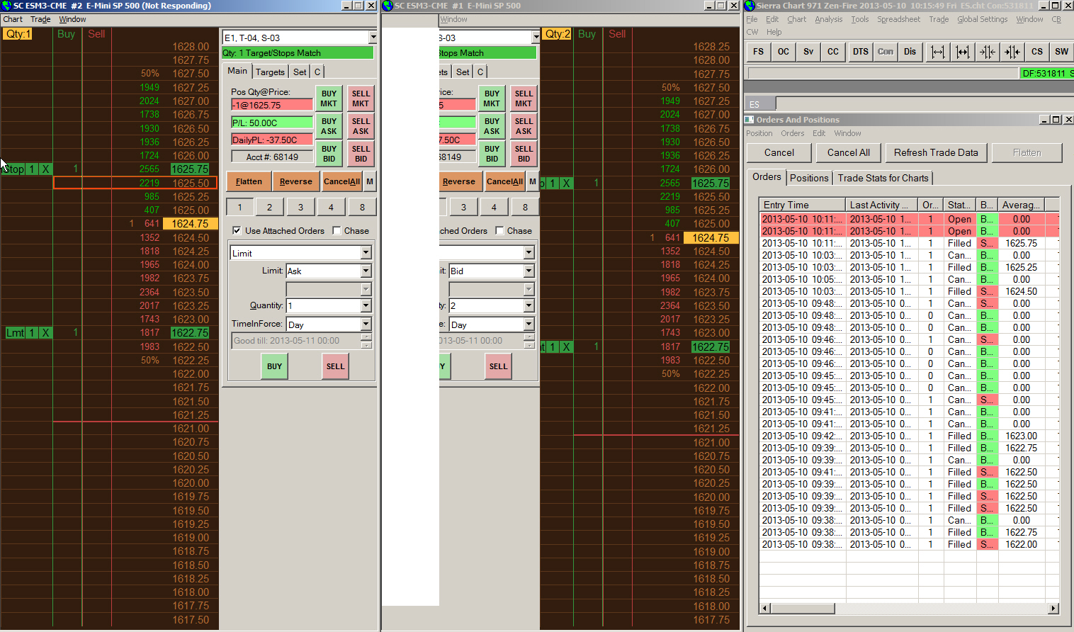

It's happened twice this morning. Here's the screenshot. Sorry did not get the cpu usage
Date Time Of Last Edit: 2013-05-10 15:24:41
imageCapture1.jpg / V - Attached On 2013-05-10 15:23:56 UTC - Size: 1.11 MB - 881 views

Thank you. Please do let us know what the CPU usage is next time this happens.
We also indicated by email that we are going to be changing the integration method to Rithmic to prevent an issue like this assuming it is caused by the Rithmic software. We tend to suspect this might be the case, because something like this is exceptionally unusual.
