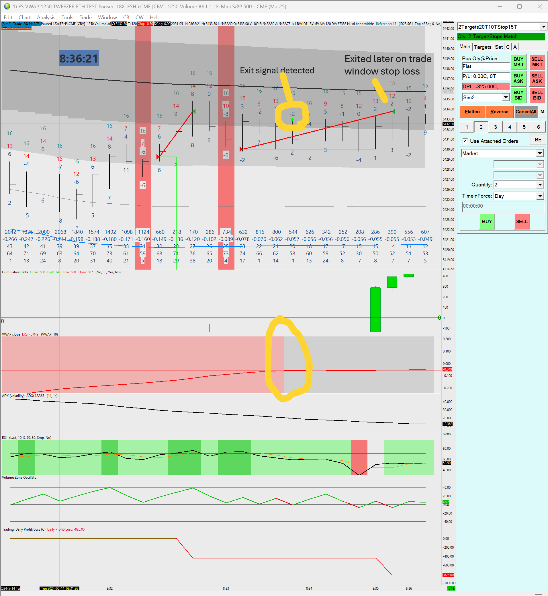

I can confirm that the exit signal is detected as it should, as shown in the attached screenshot (little dot circled by correct bar) and also in the associated log. However, the signal is not being actioned, but the trade played out until the stop loss (from trade window) was hit.

imageExample1.png / V - Attached On 2025-01-14 12:56:00 UTC - Size: 287.1 KB - 230 views
