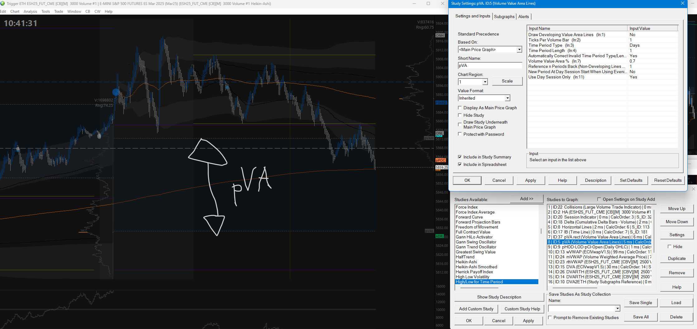

OriolCasas - Posts: 190
Attached a picture of how the pVA is shown. Blue rectangle with gray dash.
Thank you
imageimage.png / V - Attached On 2025-01-09 17:37:19 UTC - Size: 175.04 KB - 258 views
[2025-01-09 20:51:01]
We do not see any blue rectangle with a gray dash. Where is this in the image? And which chart is it in (the one on the left or the one on the right). We do see orange labels for the pVAH and pVAL in the image on the left.
Please give us just a single chart image that has nothing but the pVA showing on it. And we need to know why you think it is incorrect. What exactly is wrong? What are you comparing it against? What values are you expecting and where are you getting those values from?

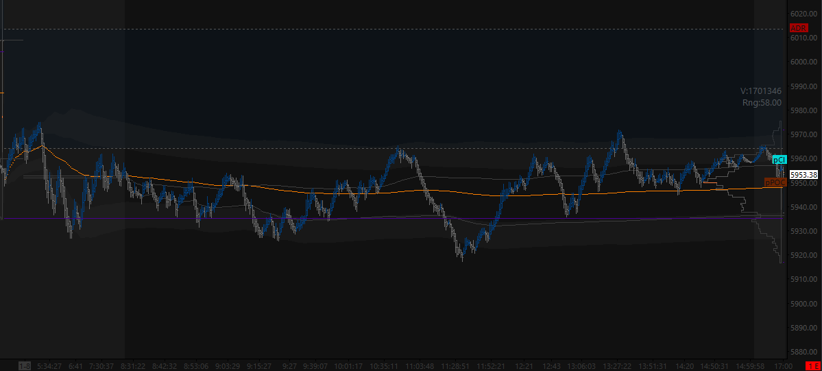

[2025-01-14 16:45:27]
Labels for pVAH - pVAL are orange on the picture I sent you before. But there's also a rectangle (blue) and dash lines (gray)
See at the new attached image how is the pVA shown.
image1.png / V - Attached On 2025-01-14 16:43:27 UTC - Size: 230.28 KB - 196 views
[2025-01-14 18:27:32]
We see the lines and labels for the pVAH and pVAL. But we do not understand why you are stating that these are incorrect. What are you comparing to? Why are they wrong?

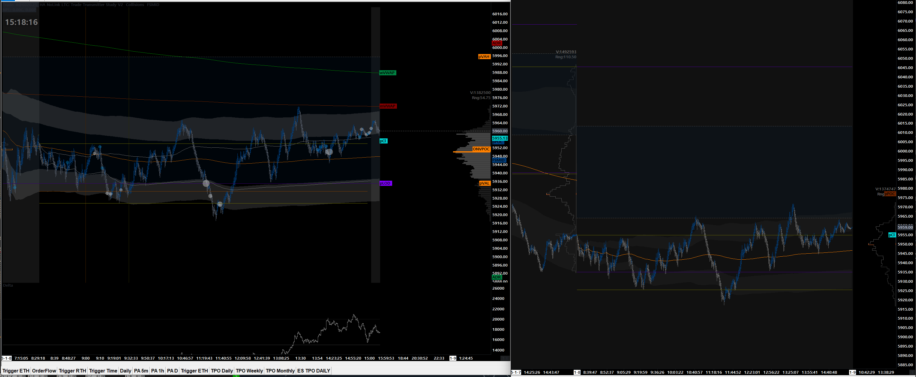

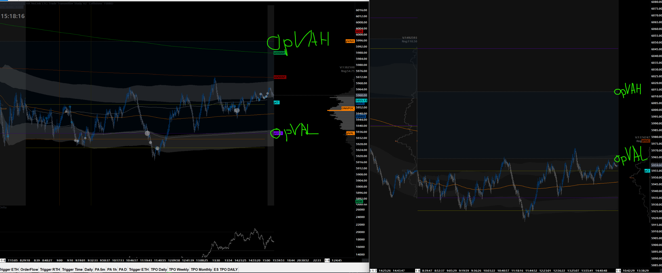

[2025-01-22 08:32:25]
As I told you earlier. I can open 2 different chartbooks with the same settings for pVA AND IT'S SHOWN DIFFERENT.
See attached picture as an example. See the old messages where you can find the chartbooks attached.
imagepVAs.png / V - Attached On 2025-01-22 08:31:06 UTC - Size: 378.92 KB - 144 views

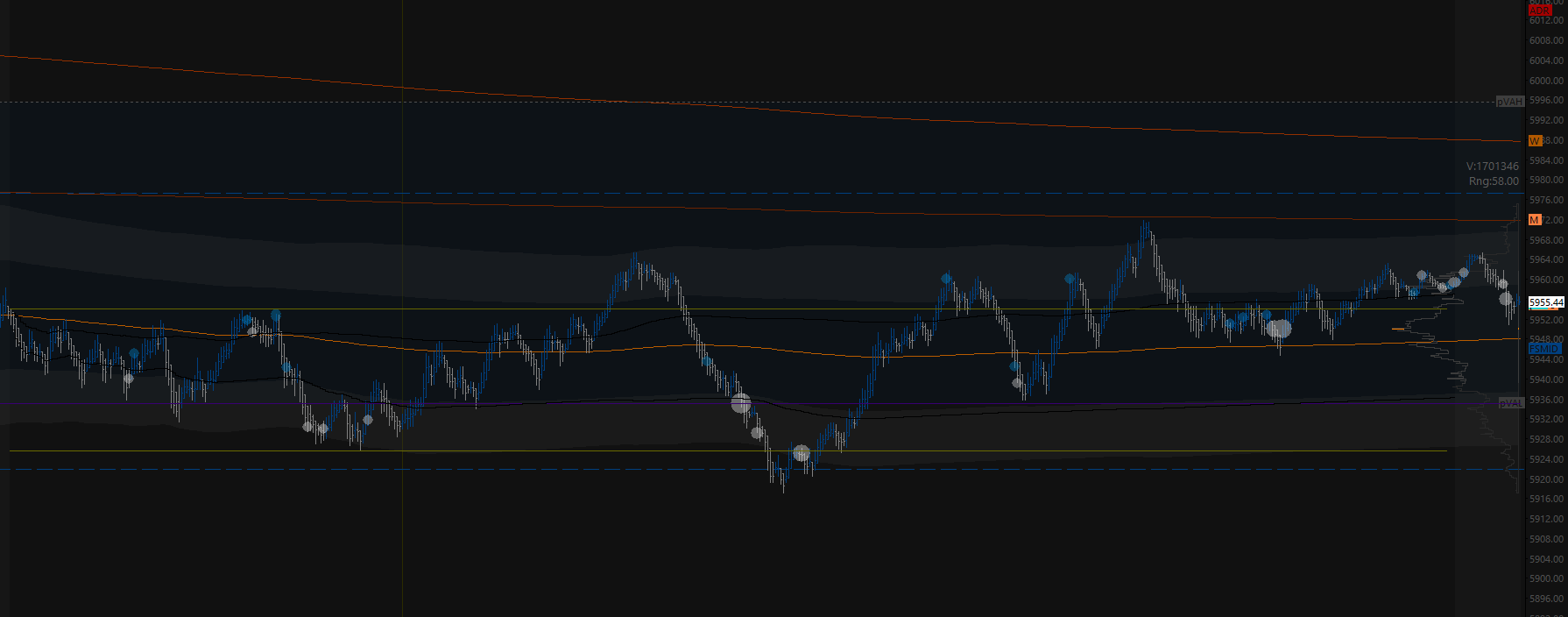

[2025-01-24 21:26:16]
Attached screen captures on how this chartbooks on 01.08.2025 are seen on my PC.
imageHA+Daily+TPOs+DVAs+ADR picture.png / V - Attached On 2025-01-24 21:23:31 UTC - Size: 34.28 KB - 236 views
imageES24 screen capture.png / V - Attached On 2025-01-24 21:26:06 UTC - Size: 50.27 KB - 242 views
