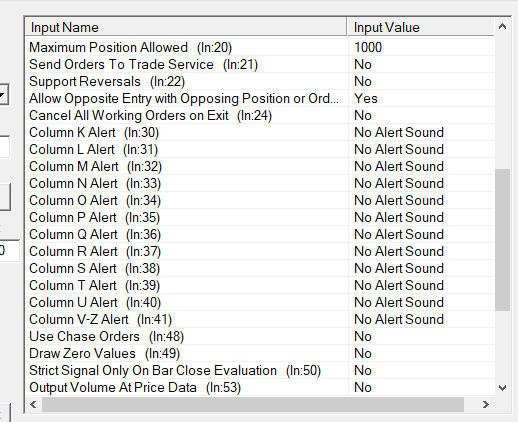

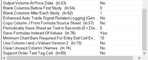

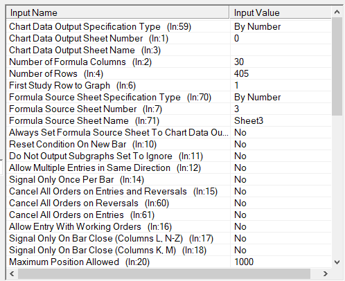

User484096 - Posts: 20
SC support please look into this.
I am running into this "Row 4 is true" issue when I am testing this in SIMS.
The alert triggered when the 10:30 plotted (=AND($J$8 = 0, AND(FRACTIME($J$41) >= TIMEVALUE("10:30:00"), FRACTIME($J$41) < TIMEVALUE("15:30:00")))), but the beginning of the 10:30 would not trigger a trade on Row 3.
Study | Replay 5.00X: MNQH25[M] 5 Min #3 | FuturesNQ5Test | CWAlgo | Alert - Chart: Replay 5.00X: MNQH25[M] 5 Min #3 | Study: CWAlgo | Formula: Sell Entry at Row 4 is true. | Last Price: 21367.50 | Bar start: 2025-01-27 10:25:00.000 | Bar end: 2025-01-27 10:29:59.995 | No alert sound/email. | 2025-01-29 11:32:15
I have attached the screenshots of the spreadsheet trading.
Date Time Of Last Edit: 2025-01-29 16:45:37
imageSpreadsheetSettings1.png / V - Attached On 2025-01-29 16:37:44 UTC - Size: 19.04 KB - 268 views
imageSpreadsheetSettings2.png / V - Attached On 2025-01-29 16:37:46 UTC - Size: 15.94 KB - 274 views
imageSpreadsheetSettings3.png / V - Attached On 2025-01-29 16:37:48 UTC - Size: 11.76 KB - 262 views
