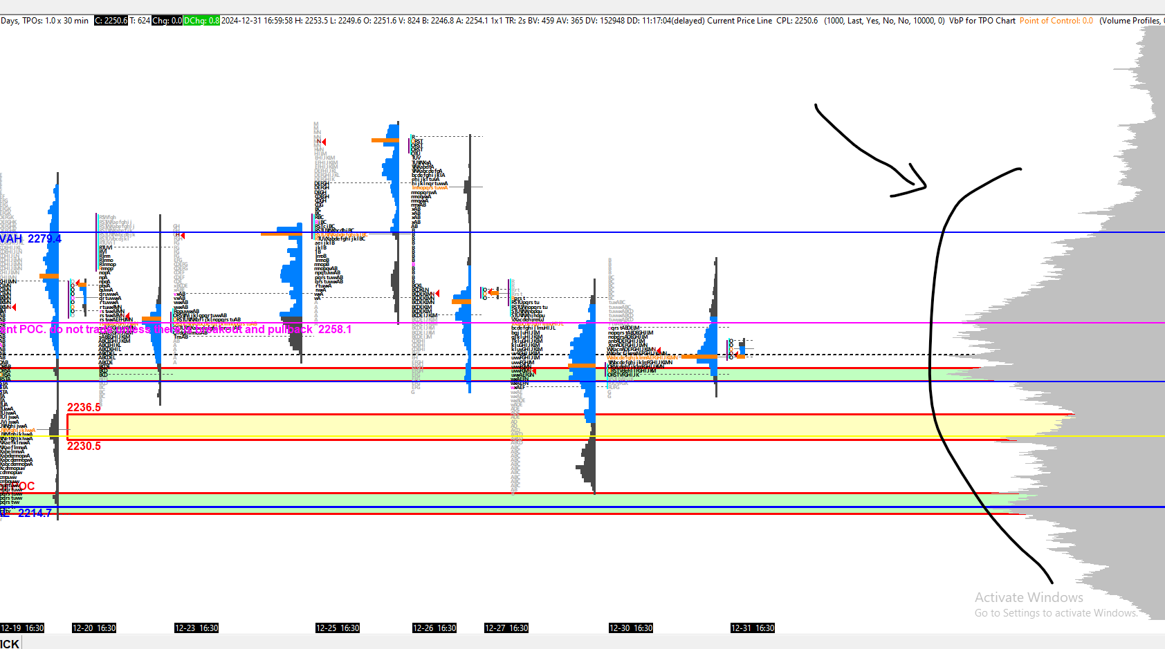

How do I remove the Volume profile on the right hand side of my TPO (which setting is it)? Have attached a pic
imageTPO.png / V - Attached On 2025-01-01 09:19:12 UTC - Size: 149.42 KB - 237 views
[2025-01-02 16:31:56]
You need to find the particular Volume by Price study that is drawing that and remove it. That particular one will be set to "One Period" and will have the option for "Set as Independent Volume Profile for TPO Chart" set to "Yes". Refer to the following:
Volume By Price Study: Set as Independent Volume Profile for TPO Chart

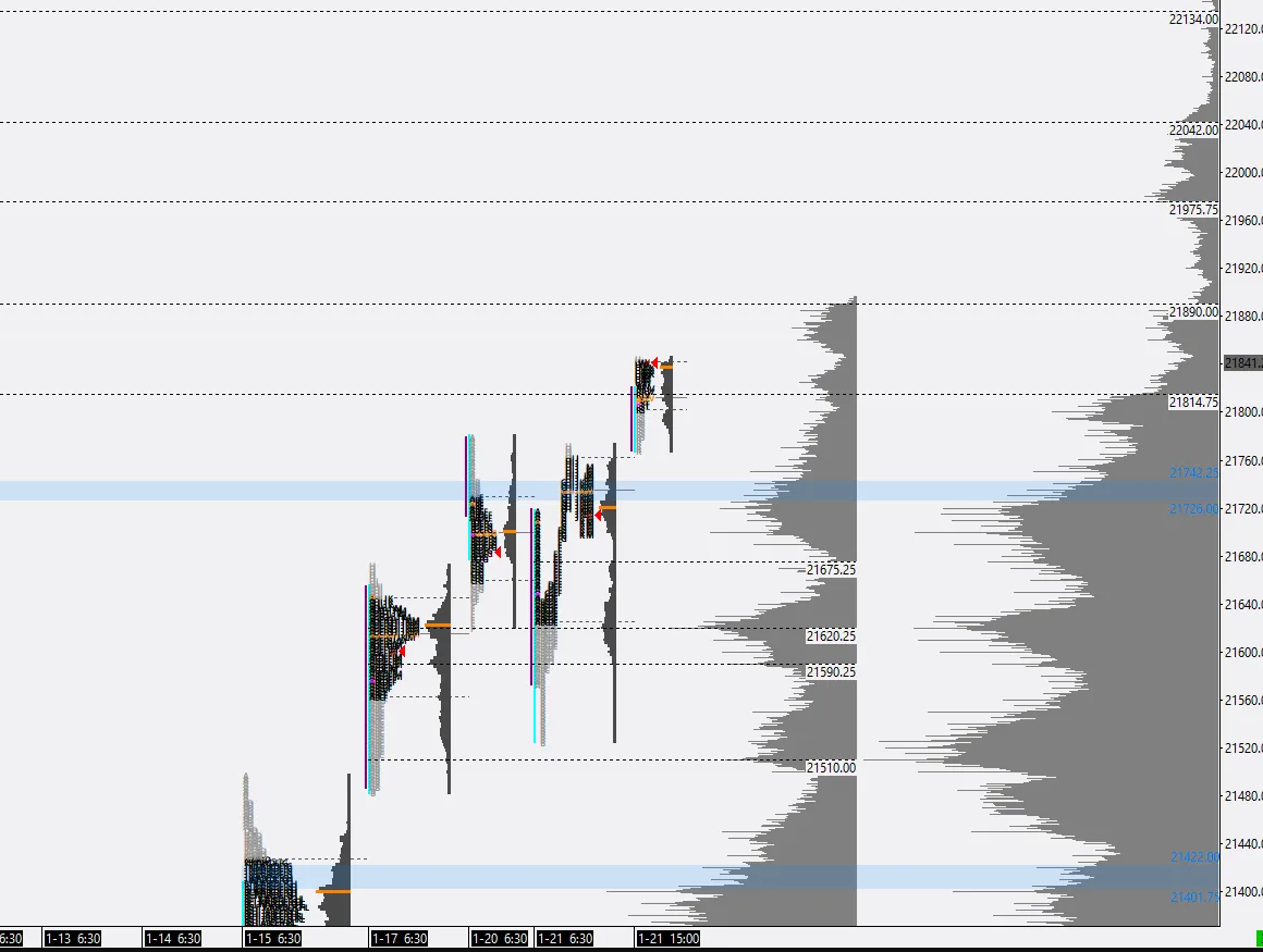

I actually would prefer to separate it into two profiles side by side. This is a screenshot of one of the traders I follow for two independent volume profiles, one for the last 2 years and another for only 2025 volume. How do I separate the two profiles into side by side ones as seen in the screenshot attached?
imageseparate independent volume profiles .png / V - Attached On 2025-01-22 17:32:01 UTC - Size: 284.03 KB - 223 views
[2025-01-22 19:41:30]
These are the instructions for this:
Volume By Price Study: Single Volume Profiles At End of Chart
The important item in this case is the Input for "Allow Side by Side Profiles on Right Side" to be set to "Yes". Refer to the following:
Volume By Price Study: Allow Side-By-Side Profiles on Right Side
Also, if you are adding these to a TPO Profile chart, then you would also need to ensure that the individual profiles have the Input for "Set as Independent Volume Profile for TPO Chart" set to "Yes". Refer to the following:
