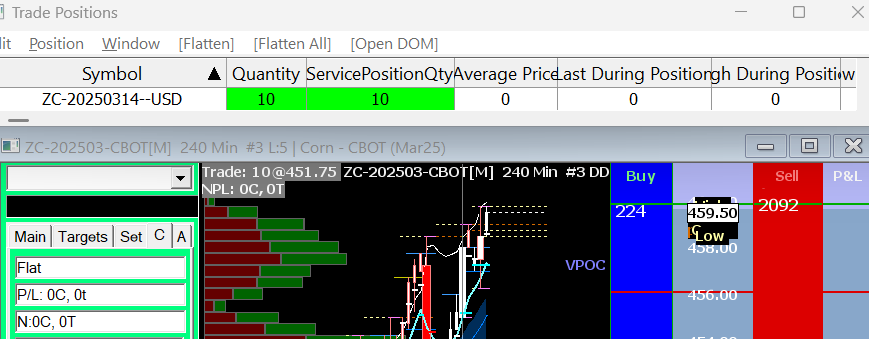

1. Position shows in TWS not in SC. Have tried symbol settings update and translate symbols and disconnect/reconnect, and restarting SC. All other positions showing fine in SC.

1. The position does show in the Trade Positions window, but not on the chart/DOM. Is it possibly a symbol issue, related to the USD at the end?
See attachment.
2. The average price/pnl is a separate problem, is it possible to retrieve these also? They only work fine when executed through SC, but it is more practical to execute in IBKR mobile or TWS sometimes.

Sierra_Chart Engineering - Posts: 25484
1. Yes this is a symbol issue. We do not know why that is happening. It should not be. There is something unusual going on related to that symbol from TWS.

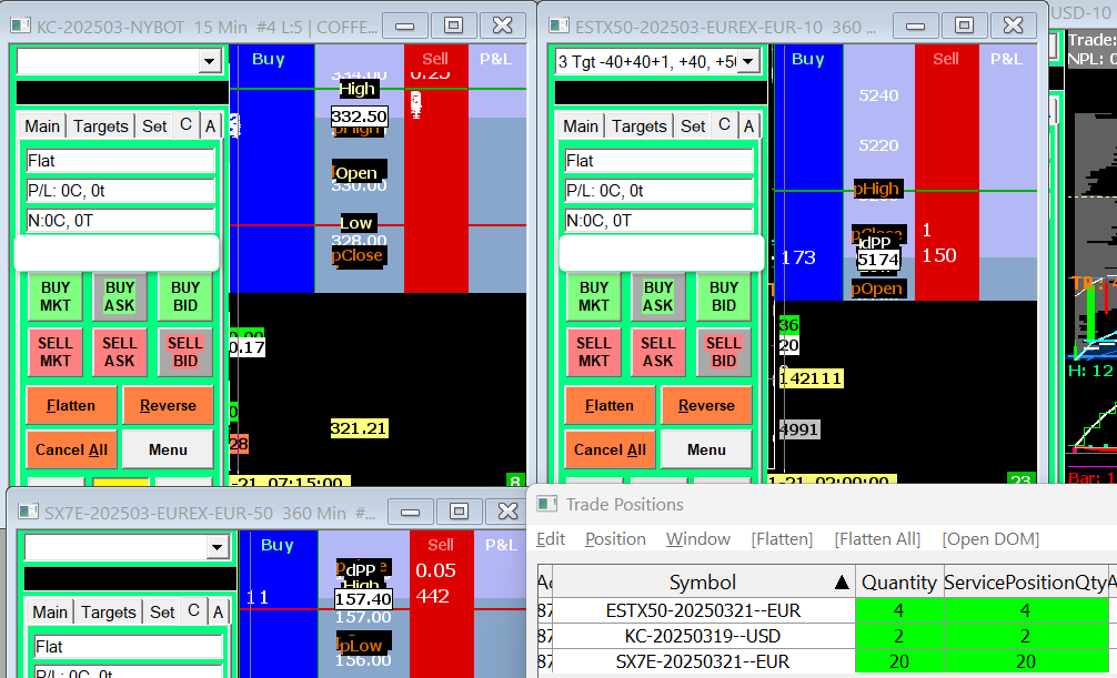

This issue is currently occurring on multiple symbols across all positions at this time.
We just tried trading CBOT corn through TWS and we do see the correct position in the Trade Positions Window:
Symbol  Quantity  Trade Account  Average Price  Open Profit/Loss  Daily Profit/Loss  Daily P/L Reset DateTime  High During Position  Low During Position  Last During Position  Margin Requirement  ServicePositionQty  Currency  Entry DateTime  MaxPotentialPosQty
ZC-202503-CBOT  1  DU018  0.00  0.00  0.00  00:00:00  487.50  487.50  487.50  0.00  1  USD  00:00:00  0
And that symbol, we see matches with the chart. So everything is correct from the Sierra Chart side. You will need to have Interactive Brokers help with this.
