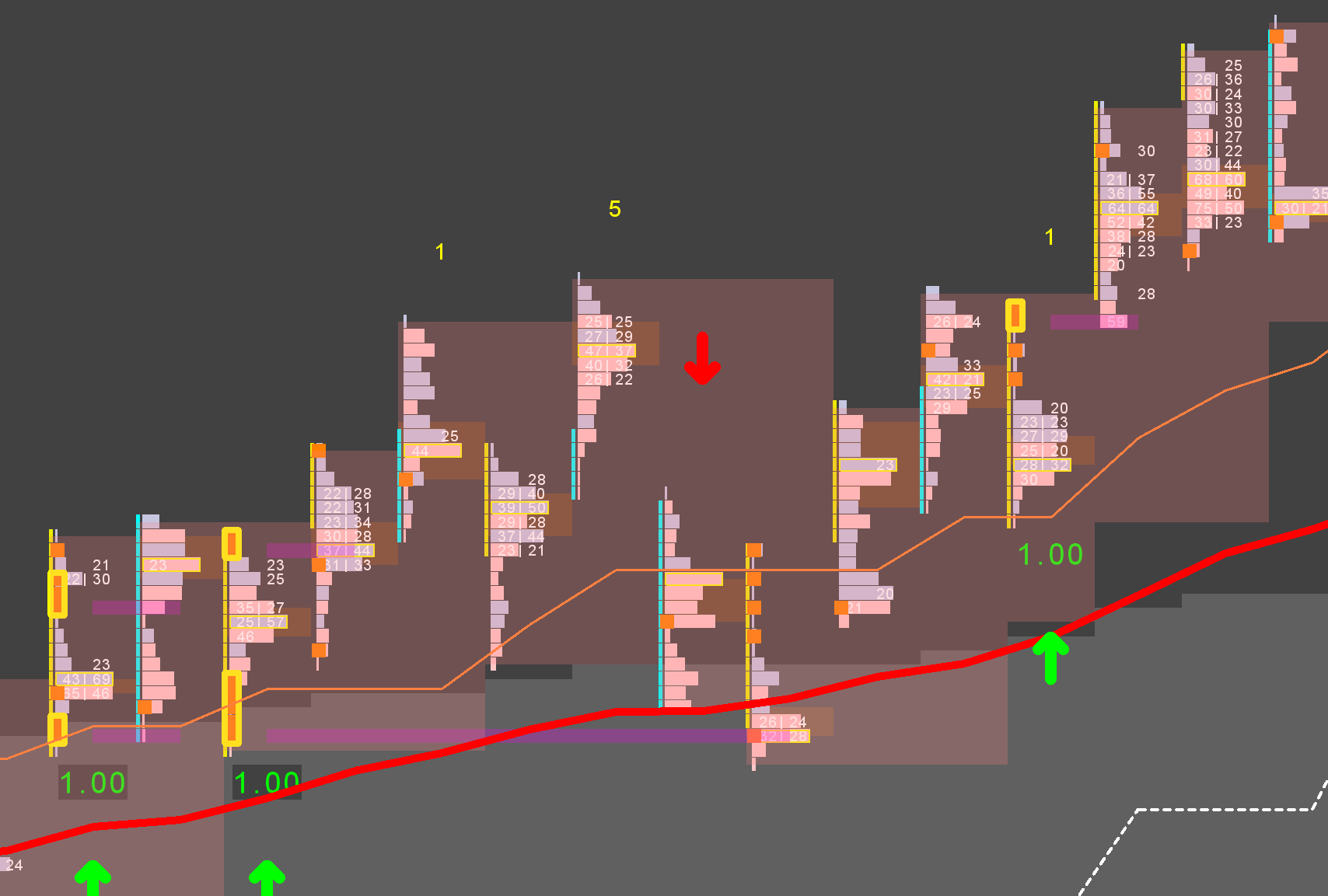

I need serious help from ACSIL gurus as I cant figure out how to make a vector persistent. I want create a vector that holds the values (lines) of imbalances that are still not crossed, so I can calculate with them later and access them quicker rather than doing a for loop in sc.GetStudyLineUntilFutureIntersectionByIndex.
So I created the vector (std::vector(....), the code does the calculations correctly, the vectors stores the values of the lines I want stored.
BUT then on the next cycle(Bar) (i have autoloop set to true). the vector is empty(?) and refills them with the values found in on that Bar (if any). I know this because I have the size of the vector printed on every bar (see picture). it is not a consecutive number ( size of vector for bar n adding to the value of bar n-1), but a size only true for that bar. every bar show 1 instead of 1 ... 2.... 3 (adding the number of found lines of that bar to the vector).
So long story short. How can I make the vector persistent so the new found values of the current bar are added to the vector of the previous bar?

Thanks for the fast reply. Just to give some context: I have read every letter of the documentation. I think I grasp the core of STL_vectors, classes, ect. I have implemented the examples from the sierra website including some code they refer to in their ASC_source folder. and again, the code works fine it does what it needs to, to the extent of creating the vector, setting everything to NULL, initiating a persistentpointer, etc. It just loses the values wehn a new bar comes to the chart.
I could refer to a previous index [sc.Index-1] and reuse the vector at that index, however, I don't know if that is possible at all. The codes I tried give an error.
see code bellow. I cant seem to get past this issue. So if you have any concrete code tips, I would be more than gratefull.
