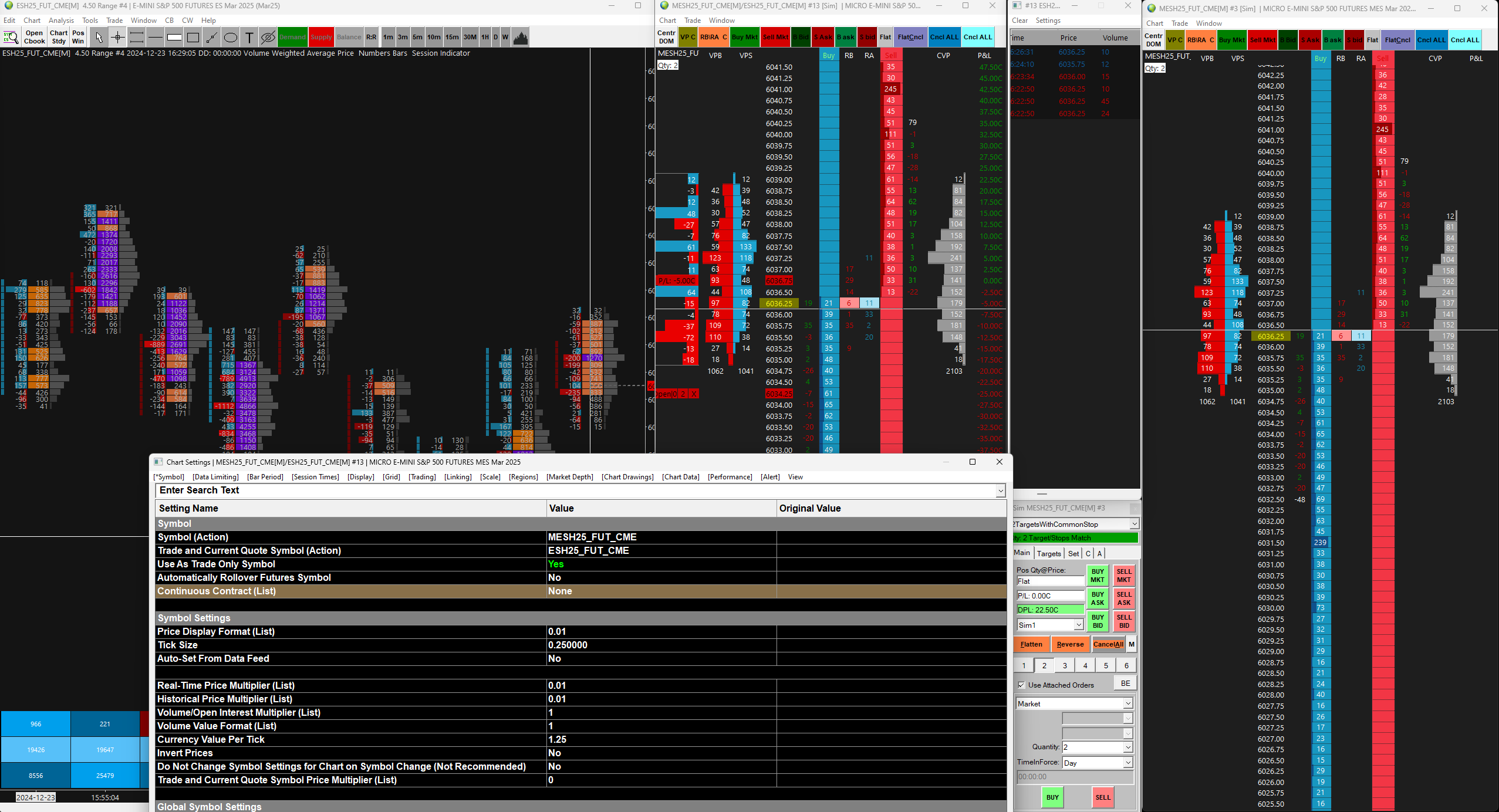

I am trying to figure out the cross symbol trading into the DOM,
1) My question is I want to keep the DOM data for ES all the bids, offers and current trades but when I execute the trade it should execute the trade onto the MES.
2) Please take a look at the screenshot the symbol data column was ESH25 before, trade and current quote symbol was empty.
3) First I added the MESH25 into the trade & Current quote column the DOM beside the footprint chart started showing data only for MESH25 not the ES(Chart Settings are from the beside footprint DOM)
4) Then changed into how it is now in the screenshot the trades being executed only on ES not the MES(Checked trade log)
Let me know is there a solution this or is this something not offered in the software at the moment.
Manpreet
imagecross symbol settings.png / V - Attached On 2024-12-23 21:44:57 UTC - Size: 425.2 KB - 338 views

You did your setup backwards.
If you want to view the data for the ES and trade the MES, then you need to enter the following in your Chart Settings:
- Symbol: ESH25_FUT_CME
- Trade and Current Quote Symbol: MESH25_FUT_CME
- Use as Trade Only Symbol: Yes

Thanks it worked, I had exactly like this before submitting the form
Only it was selected
- Use as Trade Only Symbol: No
this may caused the issue in the first place but it worked.
