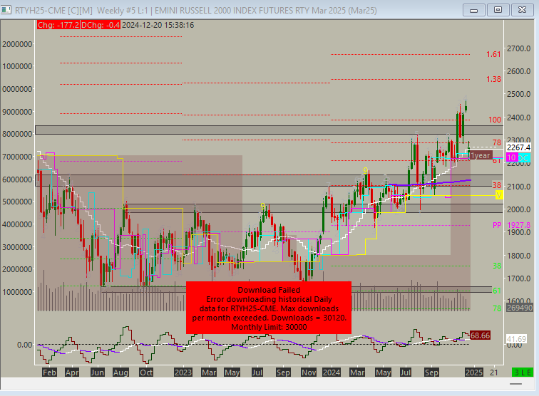

Hello
My historical charts weekly and daily missing data of 2 weeks. There is no problem on intraday charts.
What is happening, it keeps printing missing data of 2 previous weeks after new week starts
After I open the software there is an error code displayed on historical charts "Max downloads per month exceeded. Downloads=30120. Monthly limit 30000.
In general I did not make any changes to my existing settings for a while.
I noticed the problem a while ago. It might happened after you had a problem with delivering data with your providers for few days over few weeks ago.
I just updated to recent version of Sierra chart 2720.
I used "delete all data and downloaded"
The problem is still exist.
I Attached picture
imageScreenshot 2024-12-21 104257.png / V - Attached On 2024-12-21 18:25:47 UTC - Size: 54.99 KB - 214 views
imageScreenshot 2024-12-21 104643.png / V - Attached On 2024-12-21 18:25:56 UTC - Size: 34.76 KB - 264 views
[2024-12-23 14:56:53]
There is a limit of 30000 historical downloads per month, which you have met. In order to get more downloads, you need to pay $25.00 for an additional 50000 downloads. You can enable this option at the following link:
https://www.sierrachart.com/UserControlPanel.php?page=ServicesActivation#AdditionalHistoricalDownloads
You will want to enable this option, make sure you are able to download the data and then disable it. By disabling it, you are setting it to not renew for the next month, but you will still have those downloads for the remainder of this month.

[2024-12-23 15:30:41]
The prices for historical end of day data are going to be increased significantly. Refer to:
Historical End of Day Data for Futures and $ Indices Additional Cost if Over Monthly Limit

2024-12-23 04:28:18.755 | Added historical Daily data request for NQH5.CME to the queue.
2024-12-23 04:28:18.804 | NQH5.CME [CV] 1 Day #12 | Waiting for historical downloads to complete with the IDs: 1, 2, 3,
2024-12-23 04:28:18.843 | SQEW 1 Min #16 | Reloading chart.
2024-12-23 04:28:18.854 | SQEW 1 Day #8 | Reloading chart.
2024-12-23 04:28:19.023 | IEF 60 Min #41 | Reloading chart.
2024-12-23 04:28:19.376 | Loading DLL: D:\SierraChart\Data\UserContributedStudies.dll (UserContributedStudies_64.dll). Handle: 7ffb144a0000
2024-12-23 04:28:19.431 | NQH5.CME [C] Renko 160t #40 | Reloading chart.
2024-12-23 04:28:19.433 | NQH5.CME [C] Renko 160t #40 | Waiting for historical downloads to complete with the IDs: 2,
2024-12-23 04:28:19.461 | + Loading additional symbol data.
2024-12-23 04:28:19.635 | IEF Daily #14 | Reloading chart.
2024-12-23 04:28:19.648 | NQH5.CME [CV] 7 Day #23 | Reloading chart.
2024-12-23 04:28:19.709 | + Loading additional symbol data.
2024-12-23 04:28:20.125 | NQH5.CME [CV] 7 Day #23 | Waiting for historical downloads to complete with the IDs: 1, 2, 3,
2024-12-23 04:28:20.148 | NQH5.CME [CV] 2 Min #18 | Reloading chart.
2024-12-23 04:28:20.169 | NQH5.CME [CV] 2 Min #18 | Waiting for historical downloads to complete with the IDs: 1, 2, 3,
2024-12-23 04:28:20.185 | NQH5.CME [C] 15 Min #3 | Reloading chart.
2024-12-23 04:28:20.186 | NQH5.CME [C] 15 Min #3 | Waiting for historical downloads to complete with the IDs: 2,
2024-12-23 04:28:20.312 | ABVDIFF-NQ 1 Min #2 | Reloading chart.
2024-12-23 04:28:20.525 | ESH5.CME [C] 1 Min #6 | Reloading chart.
2024-12-23 04:28:21.649 | Added historical Intraday data request for ESH5.CME to the queue.
2024-12-23 04:28:21.649 | ESH5.CME [C] 1 Min #6 | Waiting for historical downloads to complete with the IDs: 4,
2024-12-23 04:28:21.662 | NQH5.CME [C] Renko 40t #7 | Reloading chart.
2024-12-23 04:28:21.663 | NQH5.CME [C] Renko 40t #7 | Waiting for historical downloads to complete with the IDs: 2,
2024-12-23 04:28:22.974 | NISS-NQ 2 Min #9 | Reloading chart.
2024-12-23 04:28:23.026 | NQH5.CME [C] Renko 40t #13 | Reloading chart.
2024-12-23 04:28:23.028 | NQH5.CME [C] Renko 40t #13 | Waiting for historical downloads to complete with the IDs: 2,
2024-12-23 04:28:23.694 | ABVDIFF-NQ 1 Min #2 Record has been filtered due to large range while loading Intraday data for ABVDIFF-NQ *
2024-12-23 04:28:24.847 | NISS-NQ Renko 10t #11 | Reloading chart.
2024-12-23 04:28:25.362 | QYLD 1 Day #15 | Reloading chart.
2024-12-23 04:28:25.383 | NQH5.CME [CV] 240 Min #20 | Reloading chart.
2024-12-23 04:28:25.409 | NQH5.CME [CV] 240 Min #20 | Waiting for historical downloads to complete with the IDs: 1, 2, 3,
2024-12-23 04:28:25.432 | NQH5.CME [C] Renko 40t #1 | Reloading chart.
2024-12-23 04:28:25.433 | NQH5.CME [C] Renko 40t #1 | Waiting for historical downloads to complete with the IDs: 2,
2024-12-23 04:28:25.454 | NQH5.CME [CV] 60 Min #4 | Reloading chart.
2024-12-23 04:28:25.485 | NQH5.CME [CV] 60 Min #4 | Waiting for historical downloads to complete with the IDs: 1, 2, 3,
2024-12-23 04:28:25.837 | NQH5.CME #10 | Reloading chart.
2024-12-23 04:28:25.837 | NQH5.CME #10 | StartDateTimeForLoadingOrderFills: 00:00:00
2024-12-23 04:28:25.854 | NQH5.CME #10 | Chart data loading complete.
2024-12-23 04:28:25.881 | NQH5.CME [C] 5 Min #5 | Reloading chart.
2024-12-23 04:28:25.882 | NQH5.CME [C] 5 Min #5 | Waiting for historical downloads to complete with the IDs: 2,
2024-12-23 04:28:25.900 | Mapping META to META. Service code: us_equities_utp_cta_exchange.data
2024-12-23 04:28:25.900 | Using symbol data fast lookup vector
2024-12-23 04:28:25.900 | Denali Data Feed | Starting real-time market data updates for: META (META). ID: 1 Service code: us_equities_utp_cta_exchange.data
2024-12-23 04:28:25.902 | Denali Data Feed | Connecting to the server ds33.sierracharts.com. Port 443
2024-12-23 04:28:25.902 | Denali Data Feed | Requesting security definition data for: META (META). ID: 1
2024-12-23 04:28:25.902 | Mapping SBUX to SBUX. Service code: us_equities_utp_cta_exchange.data
2024-12-23 04:28:25.902 | Denali Data Feed | Starting real-time market data updates for: SBUX (SBUX). ID: 2 Service code: us_equities_utp_cta_exchange.data
2024-12-23 04:28:25.902 | Denali Data Feed | Requesting security definition data for: SBUX (SBUX). ID: 2
2024-12-23 04:28:25.902 | Mapping NFLX to NFLX. Service code: us_equities_utp_cta_exchange.data
2024-12-23 04:28:25.902 | Denali Data Feed | Starting real-time market data updates for: NFLX (NFLX). ID: 3 Service code: us_equities_utp_cta_exchange.data
2024-12-23 04:28:25.902 | Denali Data Feed | Requesting security definition data for: NFLX (NFLX). ID: 3
2024-12-23 04:28:25.902 | Mapping AMGN to AMGN. Service code: us_equities_utp_cta_exchange.data
2024-12-23 04:28:25.902 | Denali Data Feed | Starting real-time market data updates for: AMGN (AMGN). ID: 4 Service code: us_equities_utp_cta_exchange.data
2024-12-23 04:28:25.902 | Denali Data Feed | Requesting security definition data for: AMGN (AMGN). ID: 4
2024-12-23 04:28:25.902 | Mapping VRTX to VRTX. Service code: us_equities_utp_cta_exchange.data
2024-12-23 04:28:25.902 | Denali Data Feed | Starting real-time market data updates for: VRTX (VRTX). ID: 5 Service code: us_equities_utp_cta_exchange.data
2024-12-23 04:28:25.902 | Denali Data Feed | Requesting security definition data for: VRTX (VRTX). ID: 5
2024-12-23 04:28:25.902 | Mapping AMD to AMD. Service code: us_equities_utp_cta_exchange.data
2024-12-23 04:28:25.903 | Denali Data Feed | Starting real-time market data updates for: AMD (AMD). ID: 6 Service code: us_equities_utp_cta_exchange.data
2024-12-23 04:28:25.903 | Denali Data Feed | Requesting security definition data for: AMD (AMD). ID: 6
2024-12-23 04:28:25.903 | Mapping ADBE to ADBE. Service code: us_equities_utp_cta_exchange.data
2024-12-23 04:28:25.903 | Denali Data Feed | Starting real-time market data updates for: ADBE (ADBE). ID: 7 Service code: us_equities_utp_cta_exchange.data
2024-12-23 04:28:25.903 | Denali Data Feed | Requesting security definition data for: ADBE (ADBE). ID: 7
2024-12-23 04:28:25.903 | Mapping INTC to INTC. Service code: us_equities_utp_cta_exchange.data
2024-12-23 04:28:25.903 | Denali Data Feed | Starting real-time market data updates for: INTC (INTC). ID: 8 Service code: us_equities_utp_cta_exchange.data
2024-12-23 04:28:25.903 | Denali Data Feed | Requesting security definition data for: INTC (INTC). ID: 8
2024-12-23 04:28:25.903 | Mapping QCOM to QCOM. Service code: us_equities_utp_cta_exchange.data
2024-12-23 04:28:25.903 | Denali Data Feed | Starting real-time market data updates for: QCOM (QCOM). ID: 9 Service code: us_equities_utp_cta_exchange.data
2024-12-23 04:28:25.903 | Denali Data Feed | Requesting security definition data for: QCOM (QCOM). ID: 9
2024-12-23 04:28:25.903 | Mapping COST to COST. Service code: us_equities_utp_cta_exchange.data
2024-12-23 04:28:25.903 | Denali Data Feed | Starting real-time market data updates for: COST (COST). ID: 10 Service code: us_equities_utp_cta_exchange.data
2024-12-23 04:28:25.903 | Denali Data Feed | Requesting security definition data for: COST (COST). ID: 10
2024-12-23 04:28:25.903 | Mapping NVDA to NVDA. Service code: us_equities_utp_cta_exchange.data
2024-12-23 04:28:25.903 | Denali Data Feed | Starting real-time market data updates for: NVDA (NVDA). ID: 11 Service code: us_equities_utp_cta_exchange.data
2024-12-23 04:28:25.903 | Denali Data Feed | Requesting security definition data for: NVDA (NVDA). ID: 11
2024-12-23 04:28:25.903 | Mapping TSLA to TSLA. Service code: us_equities_utp_cta_exchange.data
2024-12-23 04:28:25.903 | Denali Data Feed | Starting real-time market data updates for: TSLA (TSLA). ID: 12 Service code: us_equities_utp_cta_exchange.data
2024-12-23 04:28:25.903 | Denali Data Feed | Requesting security definition data for: TSLA (TSLA). ID: 12
2024-12-23 04:28:25.903 | Mapping AMZN to AMZN. Service code: us_equities_utp_cta_exchange.data
2024-12-23 04:28:25.903 | Denali Data Feed | Starting real-time market data updates for: AMZN (AMZN). ID: 13 Service code: us_equities_utp_cta_exchange.data
2024-12-23 04:28:25.903 | Denali Data Feed | Requesting security definition data for: AMZN (AMZN). ID: 13
2024-12-23 04:28:25.903 | Mapping GOOG to GOOG. Service code: us_equities_utp_cta_exchange.data
2024-12-23 04:28:25.903 | Denali Data Feed | Starting real-time market data updates for: GOOG (GOOG). ID: 14 Service code: us_equities_utp_cta_exchange.data
2024-12-23 04:28:25.903 | Denali Data Feed | Requesting security definition data for: GOOG (GOOG). ID: 14
2024-12-23 04:28:25.903 | Mapping MSFT to MSFT. Service code: us_equities_utp_cta_exchange.data
2024-12-23 04:28:25.903 | Denali Data Feed | Starting real-time market data updates for: MSFT (MSFT). ID: 15 Service code: us_equities_utp_cta_exchange.data
2024-12-23 04:28:25.903 | Denali Data Feed | Requesting security definition data for: MSFT (MSFT). ID: 15
2024-12-23 04:28:25.903 | Mapping AAPL to AAPL. Service code: us_equities_utp_cta_exchange.data
2024-12-23 04:28:25.904 | Denali Data Feed | Starting real-time market data updates for: AAPL (AAPL). ID: 16 Service code: us_equities_utp_cta_exchange.data
2024-12-23 04:28:25.904 | Denali Data Feed | Requesting security definition data for: AAPL (AAPL). ID: 16
2024-12-23 04:28:25.927 | Mapping NQZ4.CME to NQZ24. Service code: cme
2024-12-23 04:28:25.929 | HD Request # 1 | Downloading Historical Daily chart data for NQZ4.CME. Starting date: 2024-11-26. Service: rithmic.trading
2024-12-23 04:28:25.929 | Mapping NQH5.CME to NQH25. Service code: cme
2024-12-23 04:28:25.929 | HD Request # 2 | Downloading Intraday chart data for NQH5.CME to the file NQH5.CME.scid. Service: cme
2024-12-23 04:28:25.930 | HD Request # 2 | Download start date-time: 2024-12-22 18:32:42.000000. File last date-time: 2024-12-22 18:32:42.673000
2024-12-23 04:28:25.930 | HD Request # 2 | Using server: ds28.sierracharts.com port 10149
2024-12-23 04:28:25.946 | SQEW 1 Min #16 | Chart data loading complete.
2024-12-23 04:28:25.954 | SQEW 1 Day #8 | Chart data loading complete.
2024-12-23 04:28:25.956 | Denali Data Feed | Starting real-time market data updates for: NQH5.CME (NQH25). ID: 18 Service code: cme
2024-12-23 04:28:25.959 | Denali Data Feed | Connecting to the server ds25.sierracharts.com. Port 10048
2024-12-23 04:28:25.959 | Denali Data Feed | Requesting security definition data for: NQH5.CME (NQH25). ID: 18
2024-12-23 04:28:25.959 | Requesting market depth updates for: NQH5.CME if supported. NumLevels=10
2024-12-23 04:28:25.959 | Denali Data Feed | Starting real-time market data updates for: NQZ4.CME (NQZ24). ID: 17 Service code: cme
2024-12-23 04:28:25.959 | Denali Data Feed | Requesting security definition data for: NQZ4.CME (NQZ24). ID: 17
2024-12-23 04:28:25.959 | Requesting market depth updates for: NQZ4.CME if supported. NumLevels=10
2024-12-23 04:28:25.963 | Mapping UUP to UUP. Service code: us_equities_utp_cta_exchange.data
2024-12-23 04:28:25.964 | Denali Data Feed | Starting real-time market data updates for: UUP (UUP). ID: 19 Service code: us_equities_utp_cta_exchange.data
2024-12-23 04:28:25.964 | Denali Data Feed | Requesting security definition data for: UUP (UUP). ID: 19
2024-12-23 04:28:25.964 | Added historical Intraday data request for UUP to the queue.
2024-12-23 04:28:25.964 | Intraday data recording state for symbol UUP is set to download 'Pending'.
2024-12-23 04:28:25.964 | Triggering next historical data download in queue.
2024-12-23 04:28:25.964 | IEF 60 Min #41 | Started historical data download for additional symbol UUP. Download ID: 5
2024-12-23 04:28:25.969 | IEF 60 Min #41 | Chart data loading complete.
2024-12-23 04:28:25.973 | Added historical Daily data request for UUP to the queue.
2024-12-23 04:28:25.977 | IEF Daily #14 | >= 1 Day from current Date to last Date in file. Downloading historical Daily data
2024-12-23 04:28:25.977 | IEF Daily #14 | Chart data loading complete.
2024-12-23 04:28:26.005 | DTC Client socket (5) | Creating socket.
2024-12-23 04:28:26.005 | DTC Client socket (5) | New receive buffer size: 0
2024-12-23 04:28:26.005 | DTC Client socket (5) | Connecting to IP: 69.39.70.245.
2024-12-23 04:28:26.101 | Socket (9) | Creating socket.
2024-12-23 04:28:26.101 | Socket (9) | New receive buffer size: 0
2024-12-23 04:28:26.101 | Socket (9) | Connecting to IP: 67.214.125.5.
2024-12-23 04:28:26.218 | DTC Client socket (10) | Creating socket.
2024-12-23 04:28:26.218 | DTC Client socket (10) | New receive buffer size: 0
2024-12-23 04:28:26.218 | DTC Client socket (10) | Connecting to IP: 64.152.155.20.
2024-12-23 04:28:26.463 | HD Request # 2 | Setting DTC encoding to Binary VLS
2024-12-23 04:28:26.463 | HD Request # 2 | Sending historical data logon request message.
2024-12-23 04:28:26.684 | HD Request # 2 | Requesting Intraday data. Start date-time: 2024-12-22 18:32:42. Record interval: 0. Symbol: NQH25
2024-12-23 04:28:26.860 | HD Request # 2 | Decompressing data.
2024-12-23 04:28:27.398 | HD Request # 2 | Receiving Intraday data for NQH5.CME starting at 2024-12-22 18:32:42.186000
2024-12-23 04:28:30.572 | HD Request # 2 | Timestamp of first Intraday data file record written: 2024-12-22 18:32:44.178000.
2024-12-23 04:28:33.165 | Socket (9) | CloseSocket call.
2024-12-23 04:28:33.165 | Socket (9) | Shutdown started. Waiting for graceful close.
2024-12-23 04:28:33.339 | Socket (9) | Socket gracefully closed by remote side.
2024-12-23 04:28:33.339 | Socket (9) | Closed.
2024-12-23 04:28:36.243 | Rithmic Direct - DTC | Heartbeat from server , ServerReceivedClientHeartbeatSecondsAgo=0, NumberOfOutstandingSendBuffers=0, TransmissionDelayInMilliseconds=0, ServerSendBufferSizeInBytes=0, ActualMessageDelay=0.0 seconds, DataCompRatio=0.00, UncompressedBytes=0, CompressionTime=0.000000(secs), NumCompressions=0, Source=0.0.0.0
2024-12-23 04:28:36.590 | DTC Client socket (5) | Socket gracefully closed by remote side.
2024-12-23 04:28:39.477 | ABVDIFF-NQ 1 Min #2 | Chart data loading complete.
2024-12-23 04:28:39.739 | NISS-NQ 2 Min #9 | Chart data loading complete.
2024-12-23 04:28:39.756 | QYLD 1 Day #15 | Chart data loading complete.
2024-12-23 04:28:39.768 | Denali Data Feed | Network connection to server complete.
2024-12-23 04:28:39.768 | Denali Data Feed | Starting socket receive thread.
2024-12-23 04:28:39.768 | Denali Data Feed | Sending encoding request to server: Binary VLS. Compression: high
2024-12-23 04:28:39.832 | NISS-NQ Renko 10t #11 | Chart data loading complete.
2024-12-23 04:28:40.782 | DTC Client socket (5) | Socket gracefully closed by remote side.
2024-12-23 04:28:41.185 | DTC Client socket (10) | Socket gracefully closed by remote side.
2024-12-23 04:28:48.366 | Created process D:\SierraChart\SierraChartInstance_2\SierraChart_64.exe. Current folder: D:\SierraChart\SierraChartInstance_2
2024-12-23 04:28:48.369 | Denali Data Feed | Network connection to server complete.
2024-12-23 04:28:48.369 | Denali Data Feed | Starting socket receive thread.
2024-12-23 04:28:48.369 | Denali Data Feed | Sending encoding request to server: Binary VLS. Compression: high
2024-12-23 04:28:48.374 | Historical data download thread signaled to stop.
2024-12-23 04:28:48.374 | HD Request # 2 | Received 50915 Intraday data records from 2024-12-22 18:32:42.186000 to 2024-12-23 04:28:28.185000 (9.9 hours. Delay: 20.2 seconds) and wrote 50912 records for NQH5.CME
2024-12-23 04:28:48.380 | HD Request # 2 | Add time&sales data | Remembered last file record date-time: 2024-12-23 11:28:28.185000
2024-12-23 04:28:48.380 | HD Request # 2 | Completion time: 23s.
2024-12-23 04:28:48.380 | HD Request # 2 | Intraday data download complete for NQH5.CME. Unique request ID: 2
2024-12-23 04:28:48.380 | Removing historical data download ID 2.
2024-12-23 04:28:48.380 | Real-time Intraday chart data file updates started for NQH5.CME
2024-12-23 04:28:48.380 | Intraday chart data file opened for NQH5.CME
2024-12-23 04:28:48.380 | HD Request # 2 | Enabling Intraday chart updating for symbol.
2024-12-23 04:28:48.380 | Triggering next historical data download in queue.
2024-12-23 04:28:48.380 | Historical data for NQH5.CME is delayed because connection to main data feed is not present. Current data will be received upon connection.
