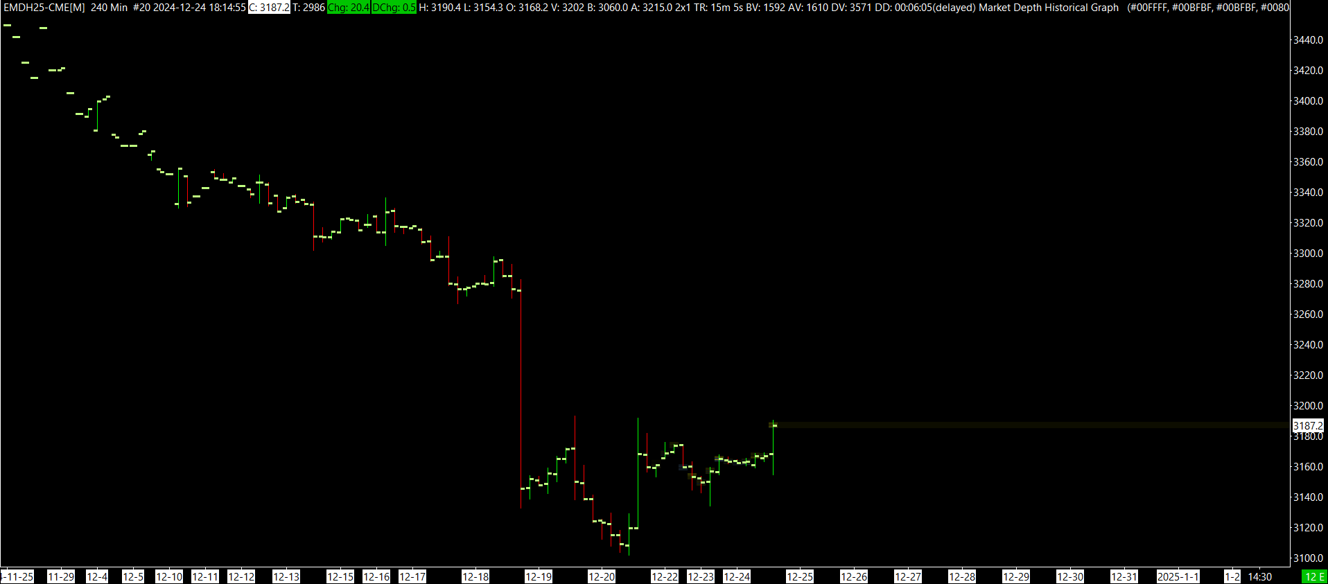

Hello John, With the CME I see nothing on the chart apart from the candlesticks and i do not have any other studies on it. Please see the image is below. Thanks https://www.sierrachart.com/image.php?Image=1735087081589.png |

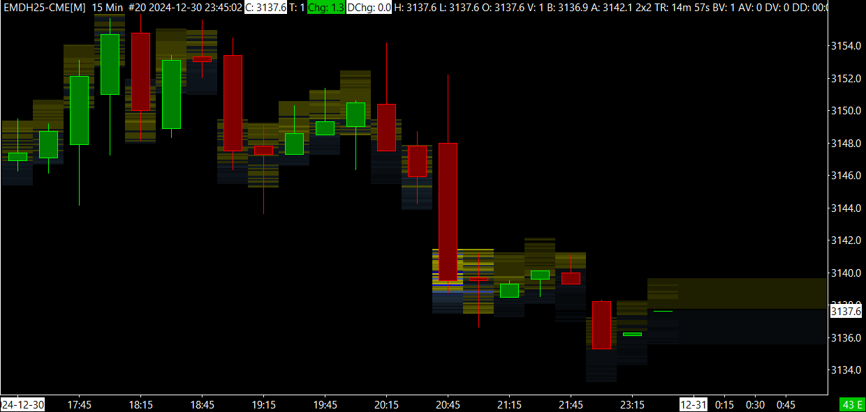

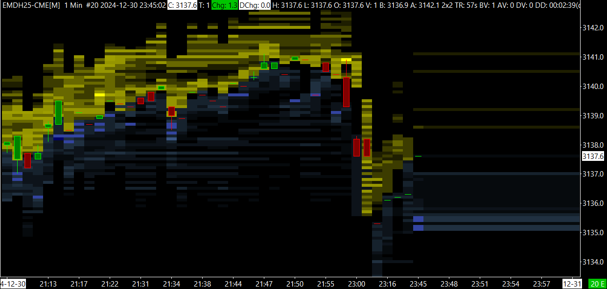

Hello, Thank you for your response The first link is the 1min chart The second link is the 15min chart When i use the market depth on a different symbol the data is shown above and below the candle whilst on the image it is shown on a small part of the candles. Please check and see if what i am seeing is correct. Thank you https://www.sierrachart.com/image.php?Image=1735604597298.png https://www.sierrachart.com/image.php?Image=1735604641413.png |
| [2024-12-31 17:37:32] |
| Sierra_Chart Engineering - Posts: 25441 |
Check this Input setting: Market Depth Historical Graph: Maximum Levels to Display (0 for All) Also use lighter colors, controlled through the Input settings. So they are more visible. This may be a visibility issue. Sierra Chart Support - Engineering Level Your definitive source for support. Other responses are from users. Try to keep your questions brief and to the point. Be aware of support policy: https://www.sierrachart.com/index.php?l=PostingInformation.php#GeneralInformation For the most reliable, advanced, and zero cost futures order routing, use the Teton service: Sierra Chart Teton Futures Order Routing |
| [2025-01-04 22:52:54] |
| User611040 - Posts: 7 |
Hello John Thank you for your response This has fixed the issue Once again thank you very much |
