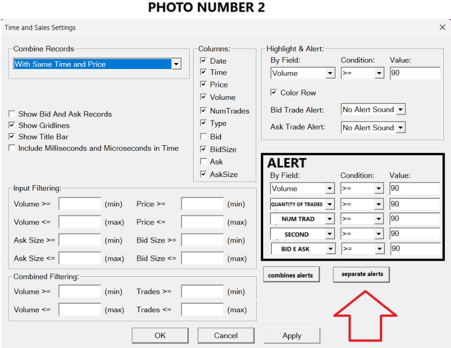

[2024-12-19 13:25:03]
User847503 - Posts: 18
I would need on time and sales something like this, (EXAMPLE MADE WITH PAINT)
imageImmagine WhatsApp 2024-12-19 ore 14.20.48_ab69c5ac.jpg / V - Attached On 2024-12-19 13:24:53 UTC - Size: 126.94 KB - 308 views
[2024-12-19 15:57:21]
The Time and Sales does not have that kind of alert settings. And it is not something that we would be changing any time soon.
The workaround we have given you is the best option.

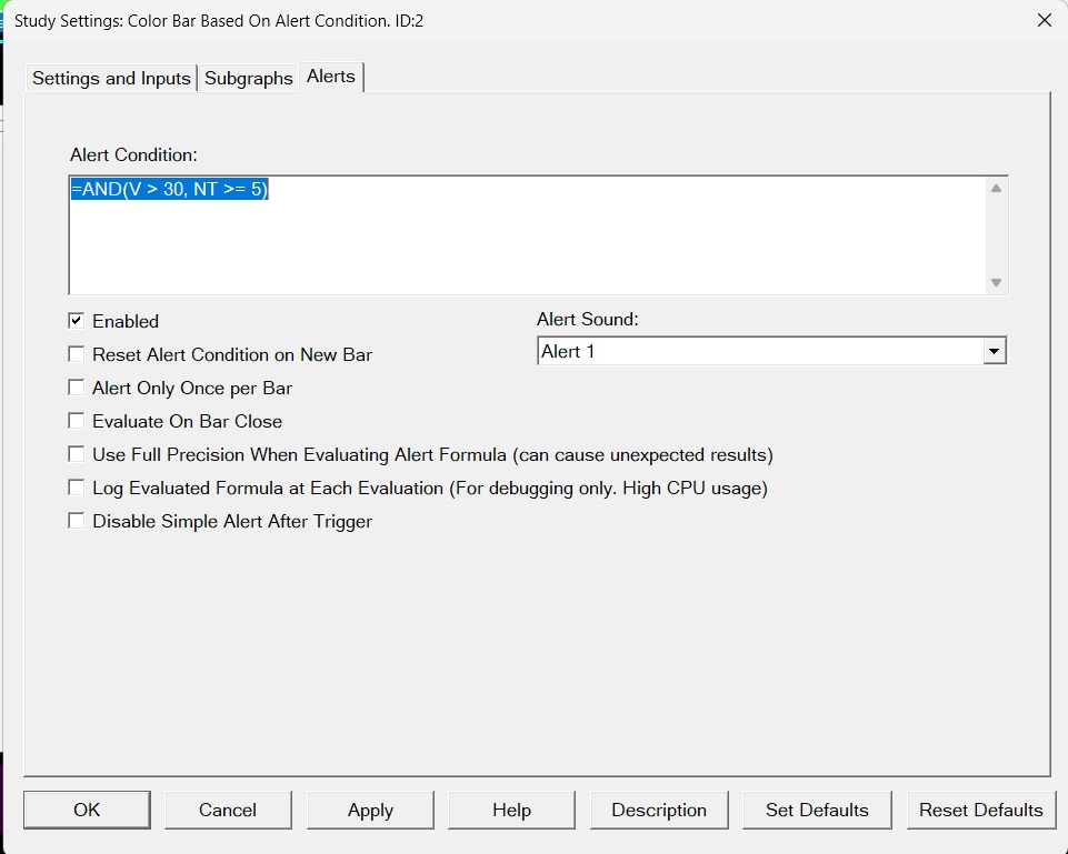

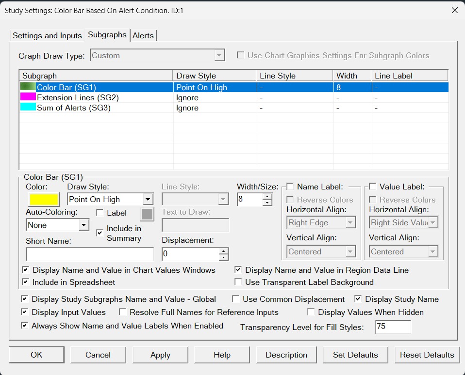

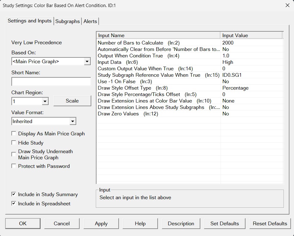

[2024-12-19 22:33:59]

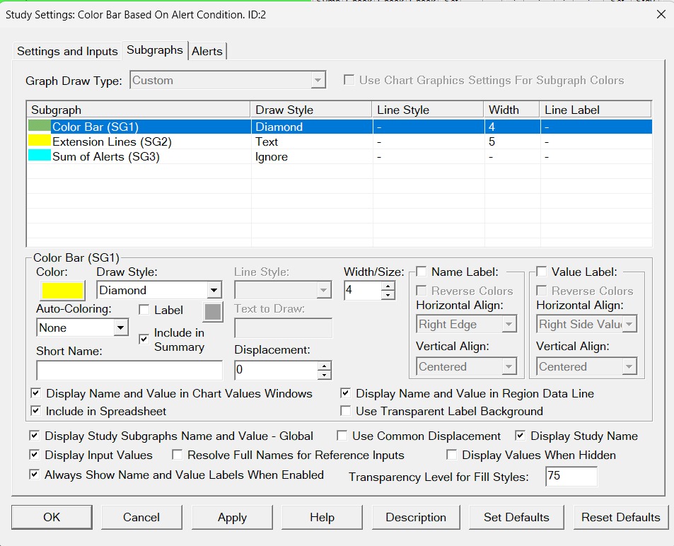

ok so in the end I used the Color Based On Alert Condition study as the study where to write this alert and I put the text you told me and the volume filter in the graph settings plus I also set the visual alert with a diamond, if everything is ok I should see a diamond when everything I set happens right?
imageImmagine WhatsApp 2024-12-19 ore 23.31.31_6f093c3d.jpg / V - Attached On 2024-12-19 22:32:38 UTC - Size: 194.49 KB - 342 views
imageImmagine WhatsApp 2024-12-19 ore 23.31.13_c4b574fb.jpg / V - Attached On 2024-12-19 22:32:47 UTC - Size: 87.65 KB - 369 views
imageImmagine WhatsApp 2024-12-19 ore 23.31.49_d8a64bc0.jpg / V - Attached On 2024-12-19 22:32:55 UTC - Size: 167.07 KB - 317 views

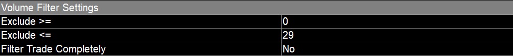

[2024-12-19 23:54:59]
and these are the settings in the 1-second chart
imageImmagine WhatsApp 2024-12-20 ore 00.51.27_0fd3c67f.jpg / V - Attached On 2024-12-19 23:54:52 UTC - Size: 24.16 KB - 355 views

the only thing I don't cpaisoc is where I have to put this formula you gave me =AND(V > 30, NT >= 5), I know I have to put it in the alerts field but how do I connect that with a visual study, forgive me if I don't understand very well and that I am just starting to use sierra and I would like to understand, can you make me a step by step list of what I should do to complete the operation I want to do? i.e.: a signal has to appear when 5 different orders are placed in the same second with volume >30 and NT>1 both bid and ask
[2024-12-20 15:20:58]
With the Color Bar Based on Alert Condition, what you need to understand is that the item you define in the Subgraph is going to be placed at the location defined by the Input for "Output When Condition True". Therefore, by selecting "Diamond" and having that Input set to "1.0", the diamond will get drawn at a price level of 1.
You can do one of two things to fix this:
1.
- Set the "Output When Condition True" to be either the "High" or "Low" of the Main Price Graph.
- Use whatever Draw Style you want, such as diamond.
- Set the "Draw Style Percentage/Ticks Offset" to be some value so that the diamond will be offset from the bar.
2.
- Use a Draw Style of "Point on High" or "Point on Low" rather than diamond. This draw style will put a point just above the high/low.

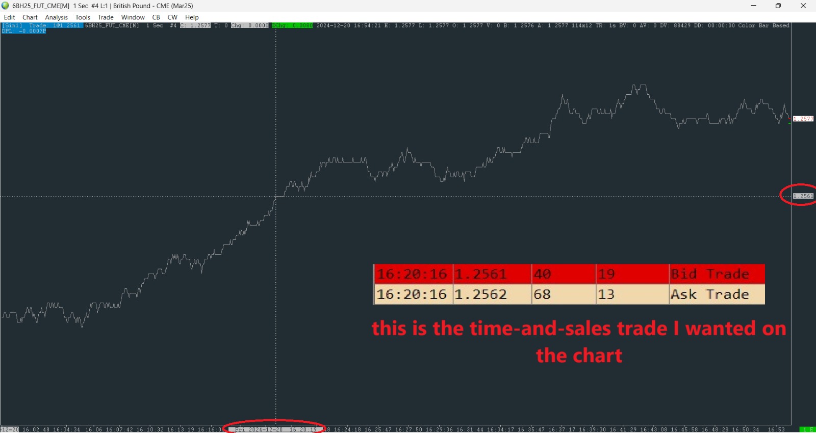

[2024-12-20 17:04:59]
as you can see in the picture I sent, there is the chart at 1 second and I put the settings like this in the trade alert:=AND(V > 30, NT >= 2) i.e. I want a volume of 30 upwards, and number of trades in the same second >=2, so two trades or more in the same second, as you can see in the same picture, I read the time and sales and it gave me an example I was looking for but the indicator didn't, here are the rest of the settings I put in addition to the volume filter of the 1sec chart at 30<=... Nothing appears in the graph, when a yellow dot should appear, could it be because they are on two different price levels? if so, what can I do? it happens that some orders are placed in the same second but on more than one price level, if not this then what is it?

[2024-12-20 17:47:38]
i have just realised that the problem is that time and sales has the COMBINED PRICE AND TYPE filter, while the indicator data obviously does not, so the request i made was based on the COMBINED PRICE AND TYPE filter of time and sales, how should i write to get the same result but without the automatic filter of time and sales?
[2024-12-20 18:02:33]
There is not a way to get the same information when the Time and Sales is set to "Combined by Price and Type" in a chart.
In this case, the only thing you can do is to create a custom study that would look at the Time and Sales information to get what you want. Note that this is looking at the stored Time and Sales, so it is not combined, you would need to do that within your study. Refer to the following:
ACSIL Interface Members - Functions: sc.GetTimeAndSales()
https://www.sierrachart.com/index.php?page=doc/SierraChartStudyAndSystemProgrammers.php
