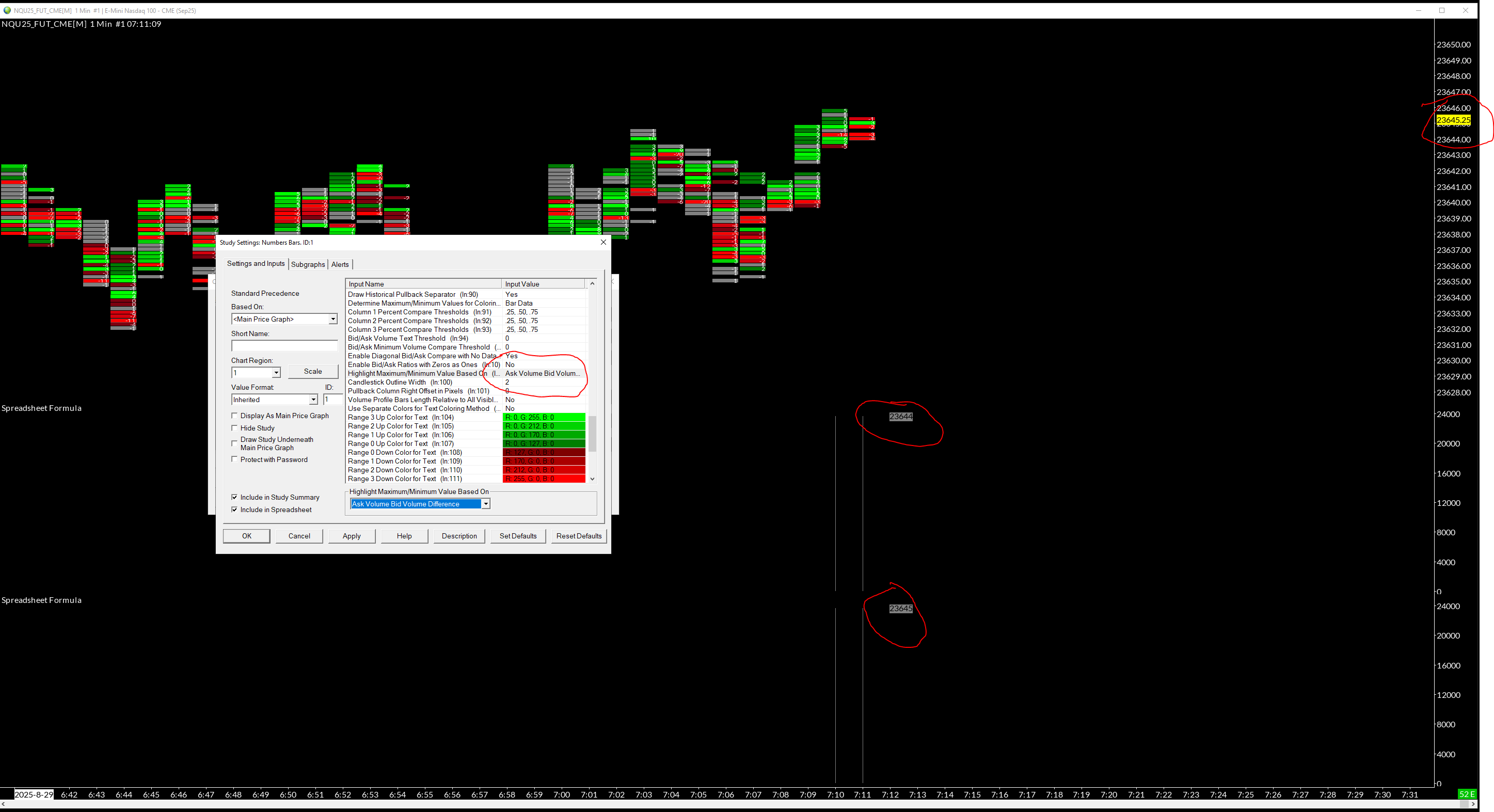

[2025-08-29 11:13:29]
TopGunTrader - Posts: 313
I really need this functionality and tried this and it doesn't work for me the SG4 and SG5 reports the PRICE where highest and lowest delta is and NOT the actual delta values. I spent 15 mins trying to get this to work followed directions above but not working for me tried 1m chart and 5 second chart same problem.
imageCapture.PNG / V - Attached On 2025-08-29 11:13:16 UTC - Size: 189.78 KB - 237 views
[2025-08-29 15:03:04]
Sierra_Chart Engineering - Posts: 25479
We will create a new study for post #1. If you want the actual minimum and maximum ask volume and bid volume differences at each chart bar, use this study:
Ask/Bid Volume Difference Bars
Date Time Of Last Edit: 2025-08-29 15:03:31
