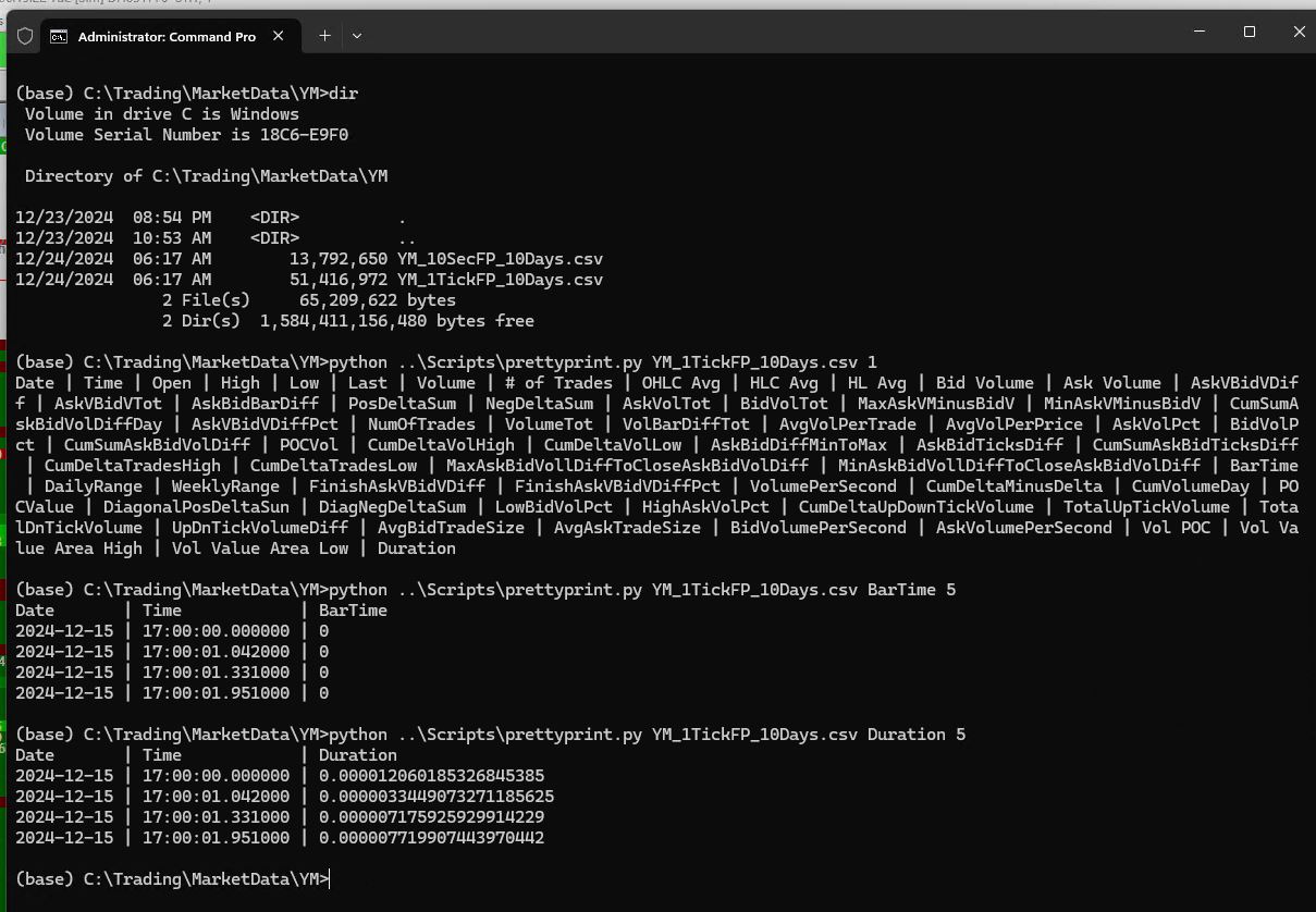

(test) C:\Trading\MarketData\CL>python prettyprint.py CL_1TickFP_10Days.csv BarTime
Date | Time | BarTime
2024-12-15 | 17:00:00.000000 | 0
2024-12-15 | 17:00:00.002000 | 0
2024-12-15 | 17:00:00.002001 | 0
2024-12-15 | 17:00:00.002002 | 0
(test) C:\Trading\MarketData\CL>python prettyprint.py CL_1TickFP_10Days.csv Duration
Date | Time | Duration
2024-12-15 | 17:00:00.000000 | 0.000000023148148287077674
2024-12-15 | 17:00:00.002000 | 1.1574074164355519e-11
2024-12-15 | 17:00:00.002001 | 1.1574074164355519e-11
2024-12-15 | 17:00:00.002002 | 0.000004849513970839325
It's not a big deal. I can hide the BarTime and add the Duration study to include that column. I just wasn't sure if it was a bug or I'm doing it wrong.

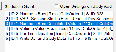

Both studies are in Sierra Chart.
Numbers Bars Calculated Values and Bar Time Duration.
I'm writing the data out to a csv with the write bar and study data to file
I wrote a python script to show the column differences from the csv so it wasn't displaying a mess like my previous messages.
BarTime shows "0"
Duration shows the fraction
I expected to see the fraction in the "BarTime" output from Numbers Bars Calculated Values.
Date Time Of Last Edit: 2024-12-23 17:38:49

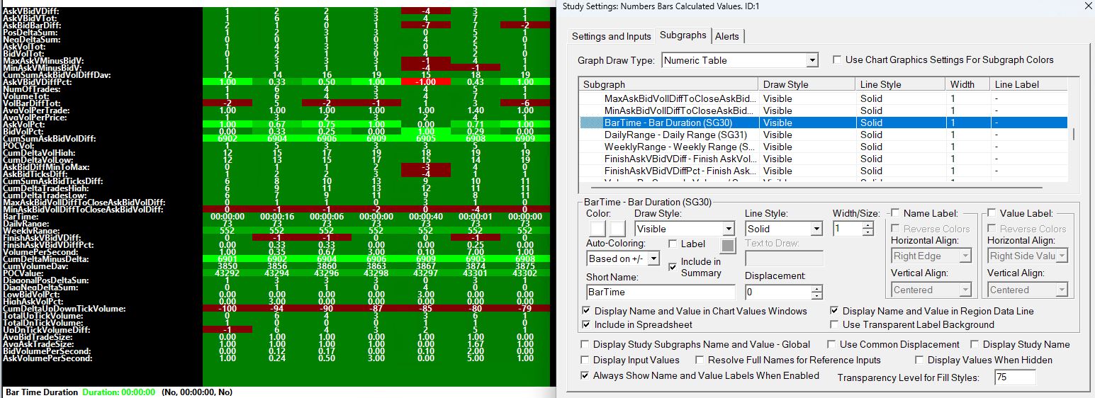

Numbers Bar Calculated Values Study is a Sierra Chart provided study and it has a SubGraph called "Bar Duration" which is a separate feature to Date and Time columns.
In the csv, it should show the duration of the bar such as a range bar as a floating point decimal so that it can be calculated externally. When that subgraph is enabled and written to csv it's always zero. There are other values like day and week range that are consistently 0s in the CSV. It's not just the BarTime-Bar Duration deal.
If I add the separate but also supplied Sierra Chart study called Bar Time Duration as an secondary study to numbers bars calculated and write that out to csv it naturally shows the CORRECT value.
I'm not sure how else to explain it so here are the steps to reproduce
Steps To Reproduce
Load Numbers Bars Calculated Values on any numbers bars chart like ES, CL, NQ, GC, RTY, YM
Enable all subgraphs to visible.
Load Write Bar and Study Data to File study and give it a file name to export the bar data.
Compare the output of the csv to the output on the screen.

We did not realize you were referring to the "Bar Duration" subgraph, we thought it was about the time of the bar.
The Numbers Bars Calculated Values internally sets the format for values that are displayed, since you can have different types of values, which is not normally supported in a study. As such, the default "Value Format" that is set for the study is "1", as most items are volumes. The reason you are seeing zeros is due to this setting for the "Value Format". Change the "Value Format" for the Numbers Bars Calculated Values to be 0.00000001 and then you will be able to get more decimal places for the subgraph being outputted. Although this also means you will see additional decimal places for any other subgraphs from that study.
[2024-12-26 20:03:21]
Yes this is a problem with the Value Format.
