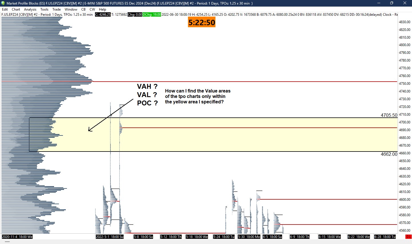

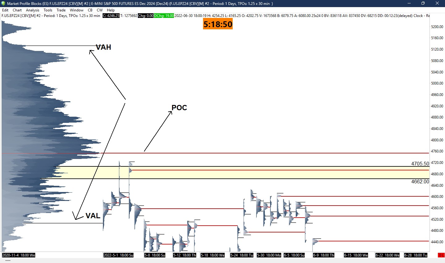

Hello, I am merging tpo graphs from the long distance. But not all the tpo graphs I merge, For example I want to see only the Vah, Val and Poc points of the blue region. How can I do this? Thanks. (Image in the attachment)

We are not understanding what you are wanting to do. We need more information on exactly what you are wanting.

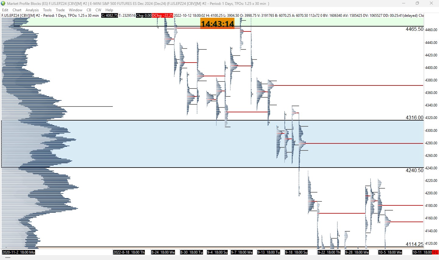

I merged the tpo's from 2020 to 2022 as in Picture 1. As you can see, very wide value areas appeared. But I don't want this. For example, I want to find only the value areas of the tpo region in the yellow box as in Picture 2. How can I do this?

[2024-12-13 14:31:02]
There is not a way to do this for a TPO.

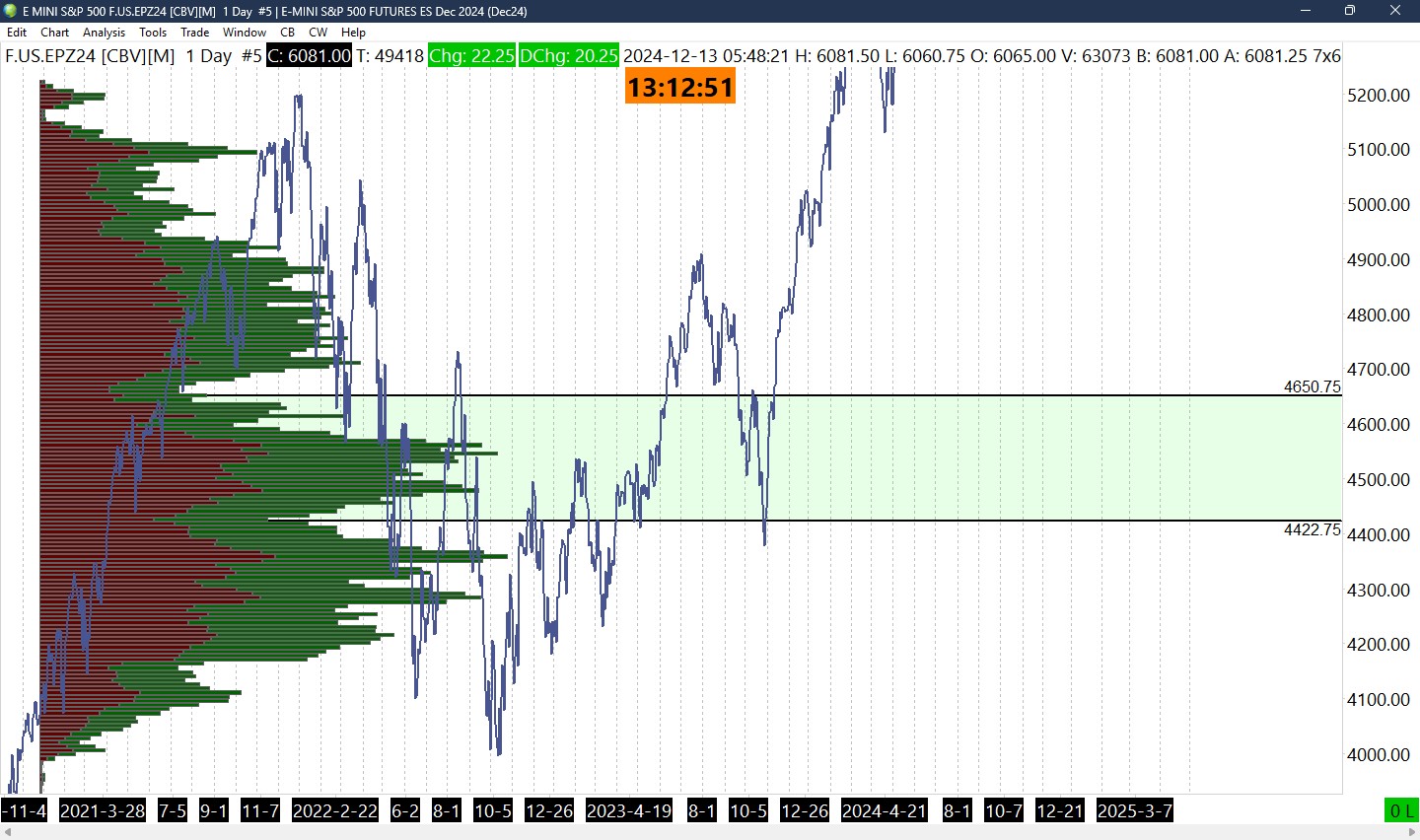

Can I do this for the volume profile? For example, can I calculate only the value areas within the green area as in the example?

[2024-12-13 18:30:54]
You would have to create a custom study and do the calculations yourself, but it is possible. Refer to the following:
ACSIL Programming Concepts: Accessing Volume at Price Data Per Bar
