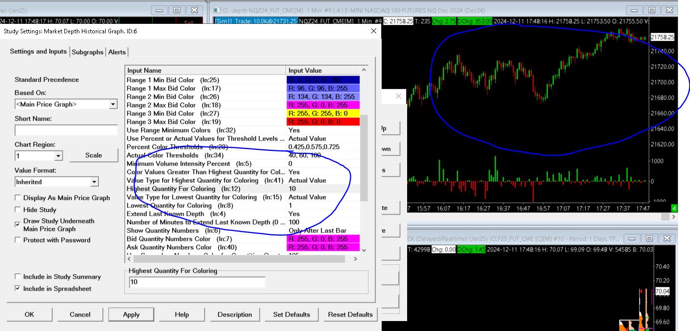

i have an issue with Market Depth Historical graph study for NQ on 1 min chart . I set the minimum as NQ dta DOM but nothing work at all. (see the picture attach)
How can I resolve it ?

Due to the complexity of the Market Depth Historical Graph, it is very hard for us to say what may be occurring. We do see that you have the "Highest Quantity for Coloring" set to "10", but you also have the option for "Color Values Greater Than the Highest Quantity for Coloring" set to "yes", so you should have blocks showing everywhere, even though they will probably all be the same color. Also note that your "Actual Color Thresholds" are set to "40, 60, 100" which is in contrast to your "Highest Quantity for Coloring".
The best diagnostic tool for this is to set the "Show Quantity Numbers" to "In Bars" and then set the coloring for the quantity numbers to be something very different from the coloring of the background and the other colors that are being used for the Market Depth Historical Graph. This will allow you to see if the Market Depth Historical Graph is being drawn at all and then you can work on adjusting your settings to get what you want to see.
Otherwise, if the numbers are not displayed, and if your chart is at the current time, then we would need to know, as we would then need to figure out what is occurring with your data.
