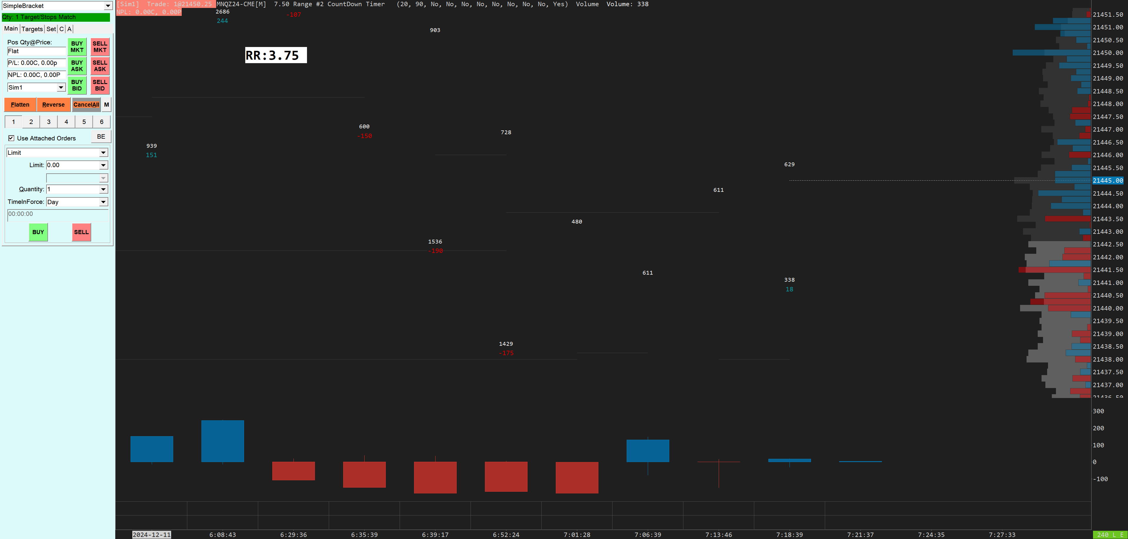

I don't know what happened. I always download Ticino Trader charts. When i try to open the chartbooks it shows no data. No footprints, delta etc. Sometimes console log says "not compatible for this package or so" I always have this package. The only thing i did different from the last time, was that to save space on my SSD y moved all the .SCID files to another drive. Maybe that's the problem? How could I solve this? I just bought another ssd if that helps. https://www.sierrachart.com/image.php?Image=1733920279617.png |

Numbers Bars requires Service Package 11. We have temporarily changed your Service Package to 12 for 30 days at no cost. This will go into effect in about three minutes. You might need to restart Sierra Chart but usually not. After that, to change to Service Package 11: To change your Sierra Chart Service Package, select "Help >> Account Control Panel" on the Sierra Chart program menu. On the displayed webpage, click on the "Set Service Package for Renewal" link.
