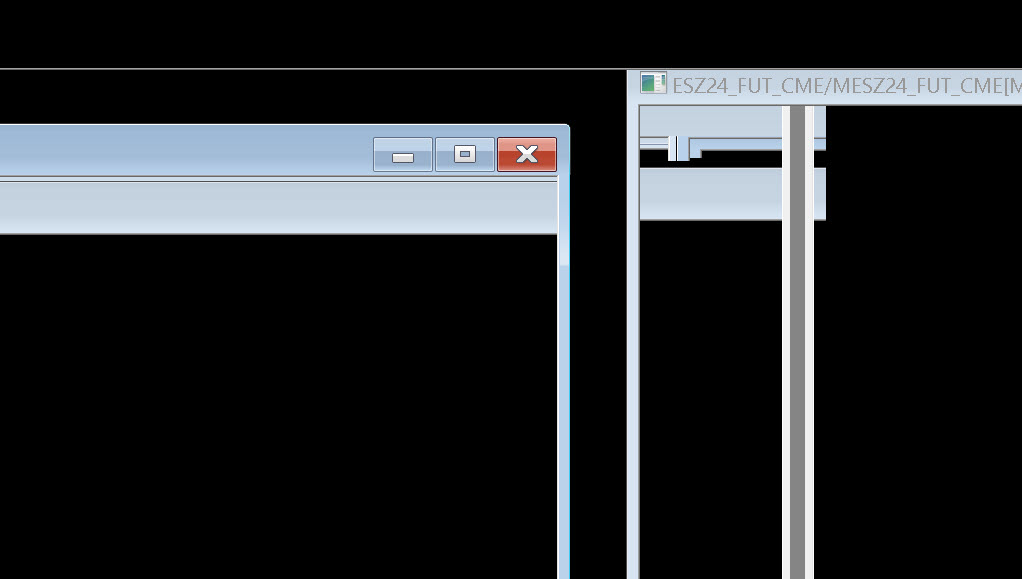

I heave an intermittent problem with chart windows turning black.
This can happen after the pc comes out of sleep mode or when moving the chart/s to another screen. Not all are showing this, some are normal.
Image attached of current situation. Sometimes resizing/ moving to another screen and resizing brings the charts back.
Any suggestions on how to prevent / best way to fix this?

[2024-12-04 23:03:28]
Sierra_Chart Engineering - Posts: 25428
Do you have the OpenGL option in Sierra Chart enabled, do you know?
[2024-12-05 13:48:32]
User654047 - Posts: 18
Yes, this is enabled. But I've unticked/ ticked this option and don’t see an improvement in this intermittent issue.
Using Quatro P2000 / P1000 graphics cards.
[2024-12-05 14:18:06]
This is a system specific issue. It is not something we can help with. We definitely recommend not using Sleep Mode of the operating system.
