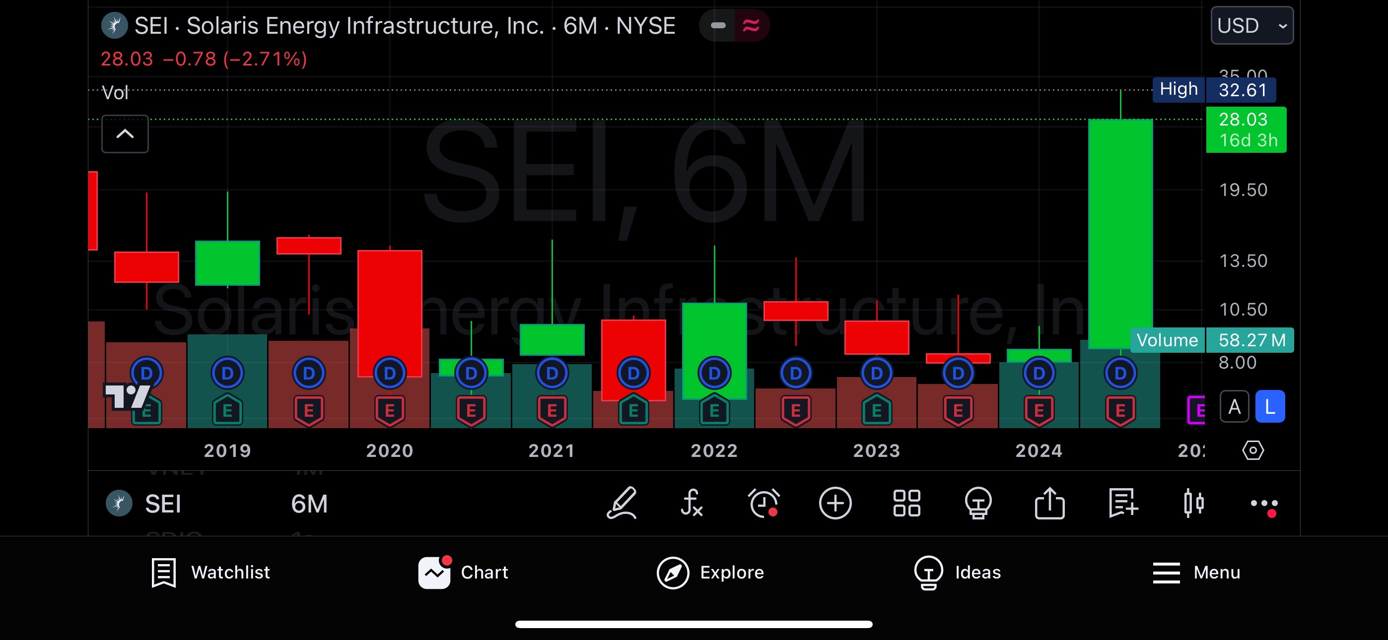

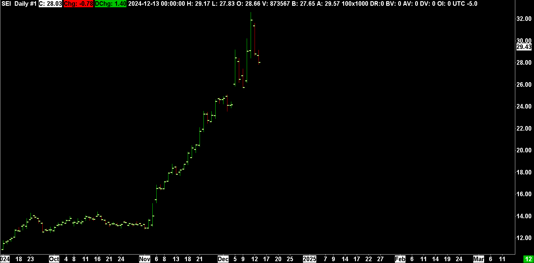

I am not seeing the Sept 2024 limitation on other charting platforms. I'm not very concerned with SEI per se however, I wonder if there could be a larger issue. See attached images.
imagesei_yearly.jpg / V - Attached On 2024-12-15 18:59:26 UTC - Size: 307.99 KB - 197 views
imagesei_monthly.jpg / V - Attached On 2024-12-15 18:59:31 UTC - Size: 369.16 KB - 217 views

Regarding post #8, when we are checking for issues like this, we have a look at Barchart data, and also IQ Feed. Here is the chart from IQ feed:
https://www.sierrachart.com/image.php?Image=17343220295.png
Do you know if there has been a symbol change for this symbol?
Date Time Of Last Edit: 2024-12-16 04:08:23
[2024-12-17 00:50:11]
User554553 - Posts: 15
Interesting, It appears so. https://stockanalysis.com/actions/changes/
Sep 12, 2024  old: SOI  new: SEI  Solaris Oilfield Infrastructure Inc
[2024-12-17 03:15:54]
Okay this data has to be manually combined. We will work on that.
