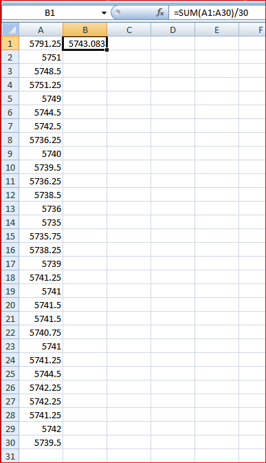

Sawtooth - Posts: 4361
I have done the calculations using this raw data and the moving average on bar 1 shouldn't be 5743.08.
What do you think it should be?
If you add the Spreadsheet Study study, and copy/paste column E for those 30 bars (include the first bar of the new RTH) to Excel, and do the math with this formula:
=SUM(A1:A30)/30
... you get 5743.083
See attached pic.
imageSMA30.PNG / V - Attached On 2024-11-30 18:18:13 UTC - Size: 18.38 KB - 171 views
[2024-11-30 18:45:54]
User813832 - Posts: 14
Hi, thanks for all your help. Your surprise caused me to recheck all the averages again and I realised the problem was not with SC or with the average calculations - they were all correct and to be expected. The issue was that pandas was sorting the dates as strings, not as actual dates. So when using diff() because the dates were not sorted, sometimes it would find the difference between, for example, 15/09/24 and 16/10/24 because its just sorting chronologically. Now I've sorted by date it works fine. Thanks!
