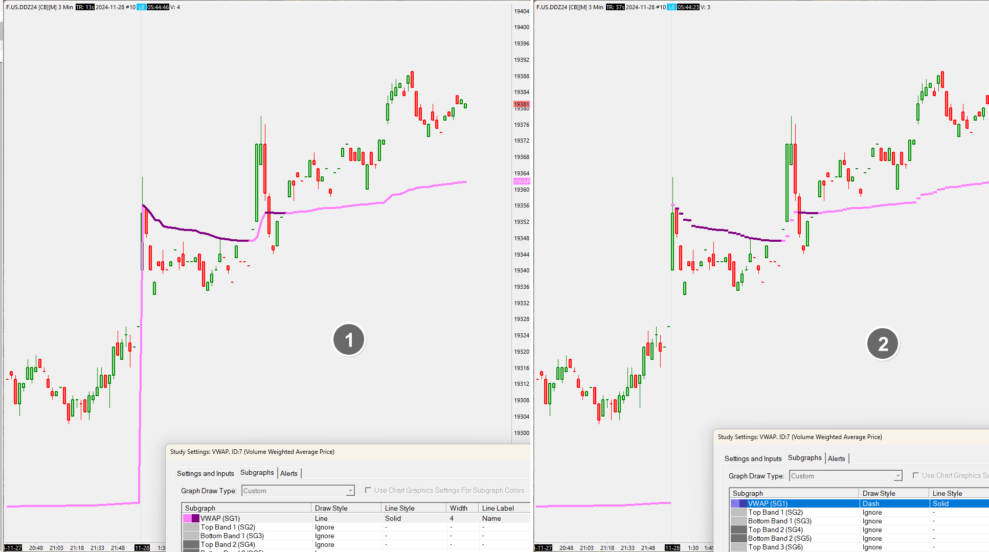

Please see pic.
You can see the study "VWAP" with day change.
In picture #1 the Draw Style is: "Line". The display is very "clean", but the disadvantage of "Line" is that the line runs with the day change.
Picture #2 looks different. The Draw Style there is "Dash/ Solid". The line does not run with the day change, but the disadvantage is that the display is not "flowing" and therefore "unclean".
Is there a DrawStyle/ Way that displays a (flowing) line, stops at the End of the Day and starts again next day?
Many thanks
imageDrawStyle by DayChange.png / V - Attached On 2024-11-28 05:02:58 UTC - Size: 84.73 KB - 181 views

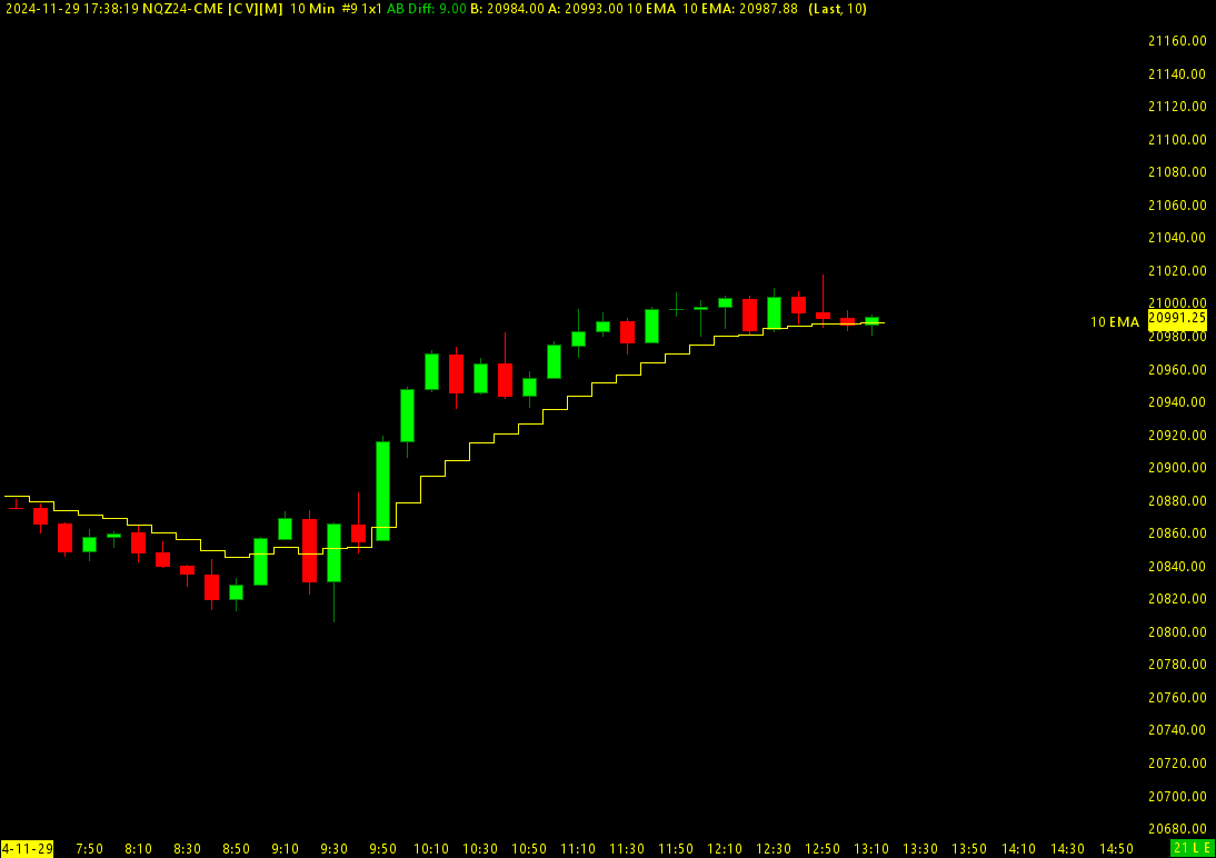

By "flowing" there are no disconnects? And by Stop at the End and Start at the beginning, maybe the StairStep Style is what you want.
https://www.sierrachart.com/image.php?Image=1732991912962.png
