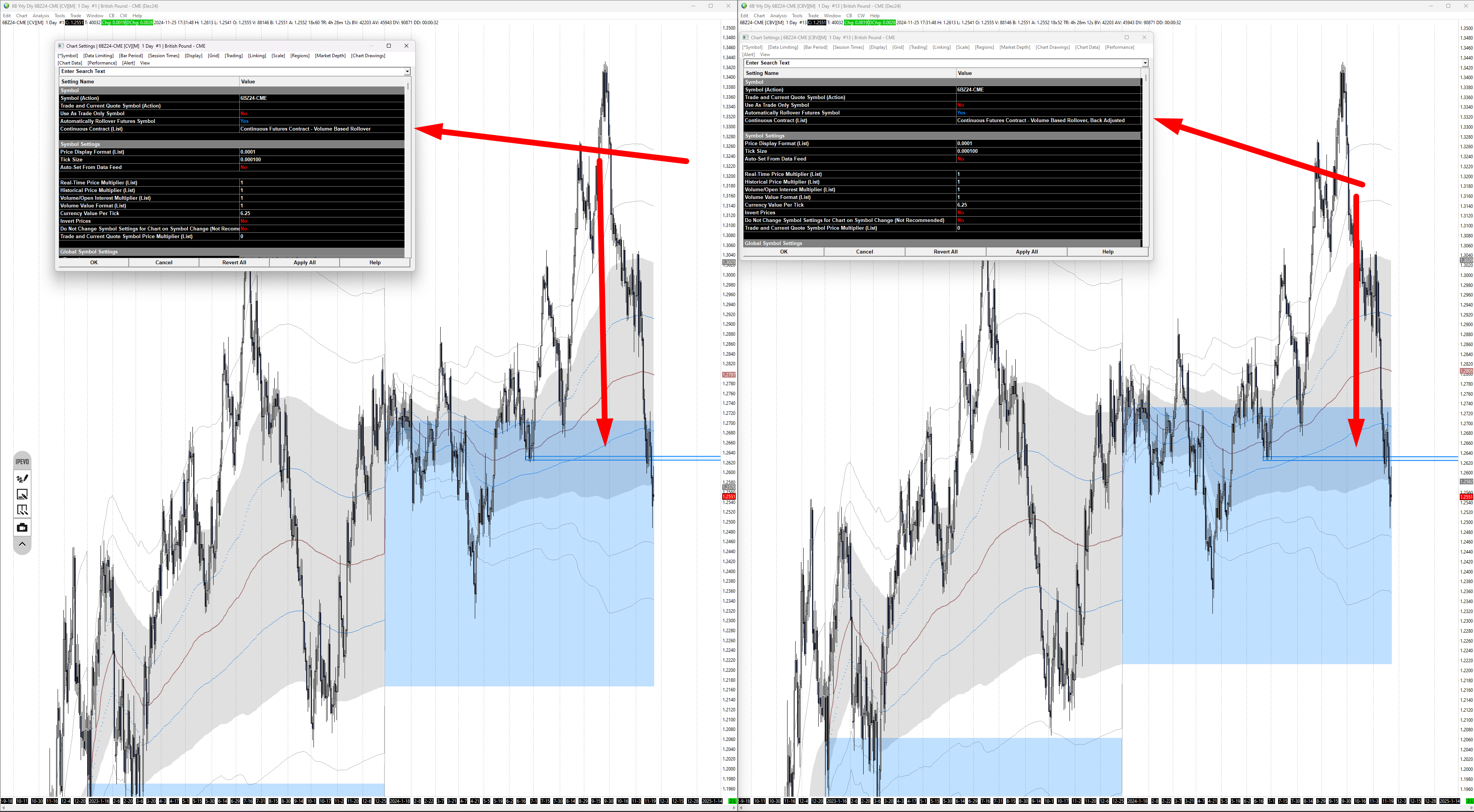

[2024-11-25 17:41:36]
User19 - Posts: 4
In part (continuous contract), there is no difference between the selected items.
I will take pictures of both situations and send them to you.
This problem exists in all trading symbols, including 6B and 6E and ES
imageScreenshot_234.png / V - Attached On 2024-11-25 17:40:32 UTC - Size: 689.42 KB - 186 views
[2024-11-25 19:21:25]
What kind of difference are you expecting to see from the rectangle that is drawn? We assume the rectangle is copied from one chart to another, as such it will be at the same level in both charts.
It sounds like you are trying to point out that there is no difference between the two charts where one is back-adjusted and the other is not. This is not true, they are different. Look at the rectangle that you are referencing and the locations of the Low of the bars that are closest to the beginning of the rectangle. In the Non-Back-Adjusted chart to the left, the bars go through the bottom of the rectangle, but this is not the case in the Back-Adjusted chart to the right.
If you are asking something else, then we need more information on your question.
