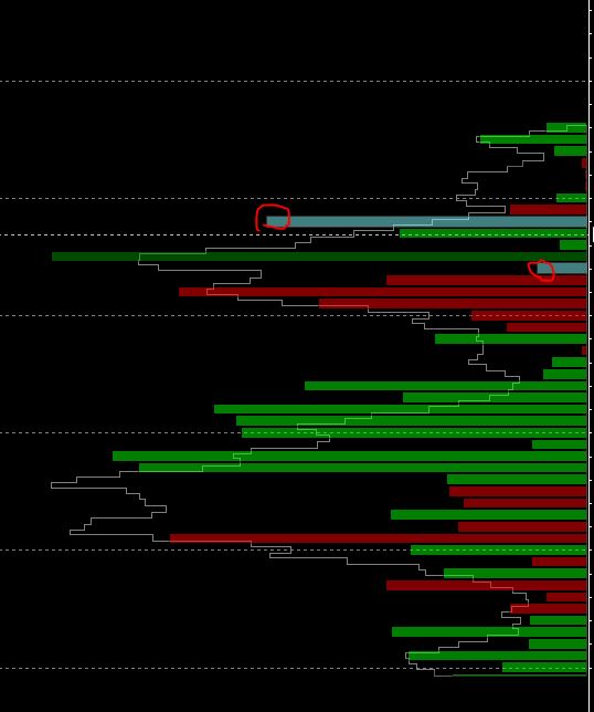

What are these light blue lines and how can I get rid of them?

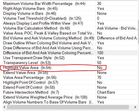

Hi I was trying to use Volume Profile delta however there are strange color lines. I have "Highlight Value Area" setting as "No" but it seems not to be the solution.

Hi John, please take a look at the attached file - I couldn't figure out about the light blue (cyan) line, sometimes there are 2 of them.

The only thing we can tell is that the coloring is coming from the "Value Area and Outline" coloring subgraph. But you do not have the option to highlight the Value Area enabled, so this does not make any sense to us as to why is is doing this.
We removed the study and added another one and it is not showing the same effect. Please do the same - remove that study and put another back on your chart and let us know if you continue to have the same problem.
